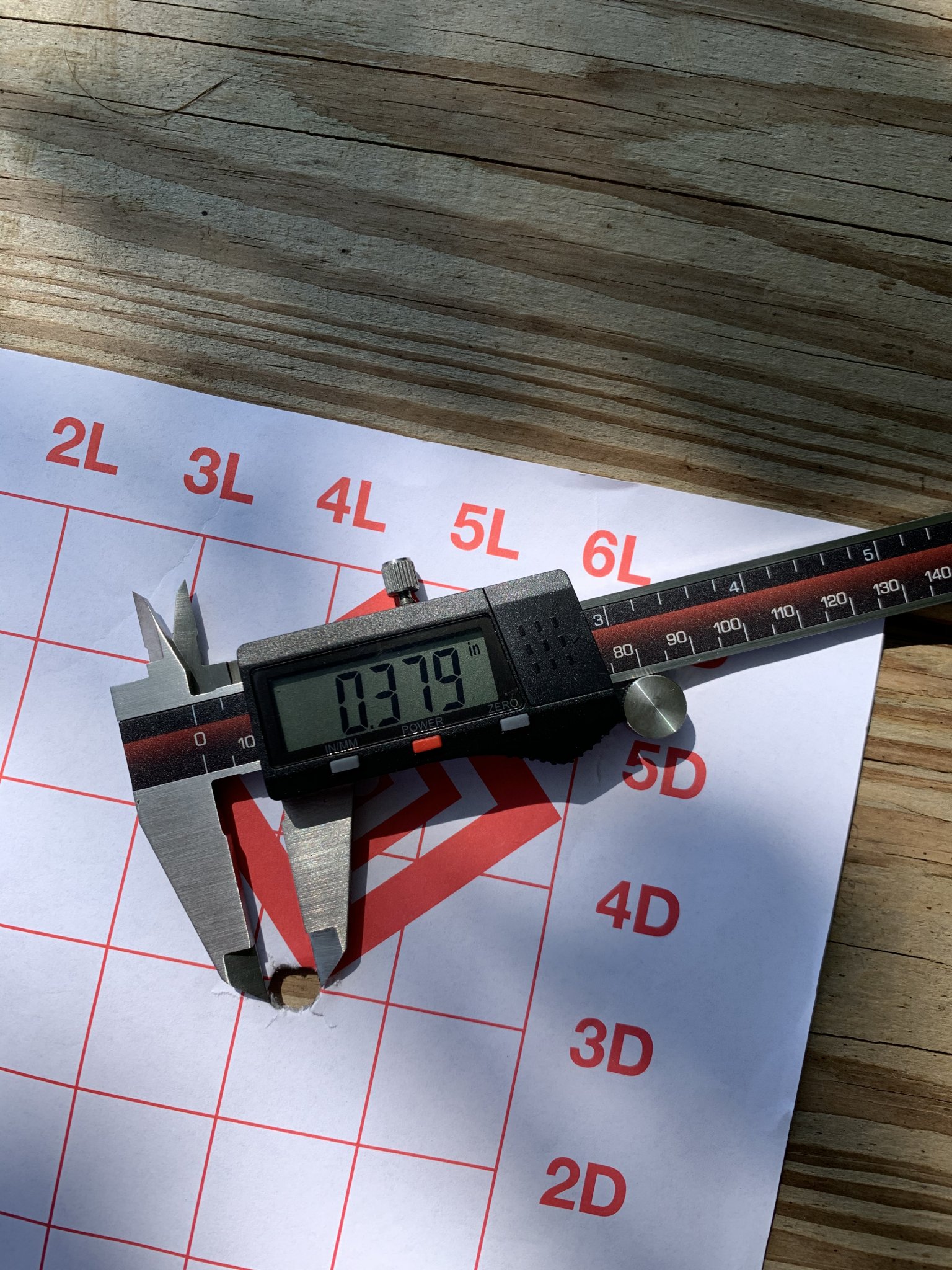

Thought I had found my load.
Shot this 5 shot group this saturday but couldn’t duplicate it Sunday after I loaded 50 of them to try out at distance.
The load opened up to about 1/2 moa average at 100 yds.
Back to the drawing board.
