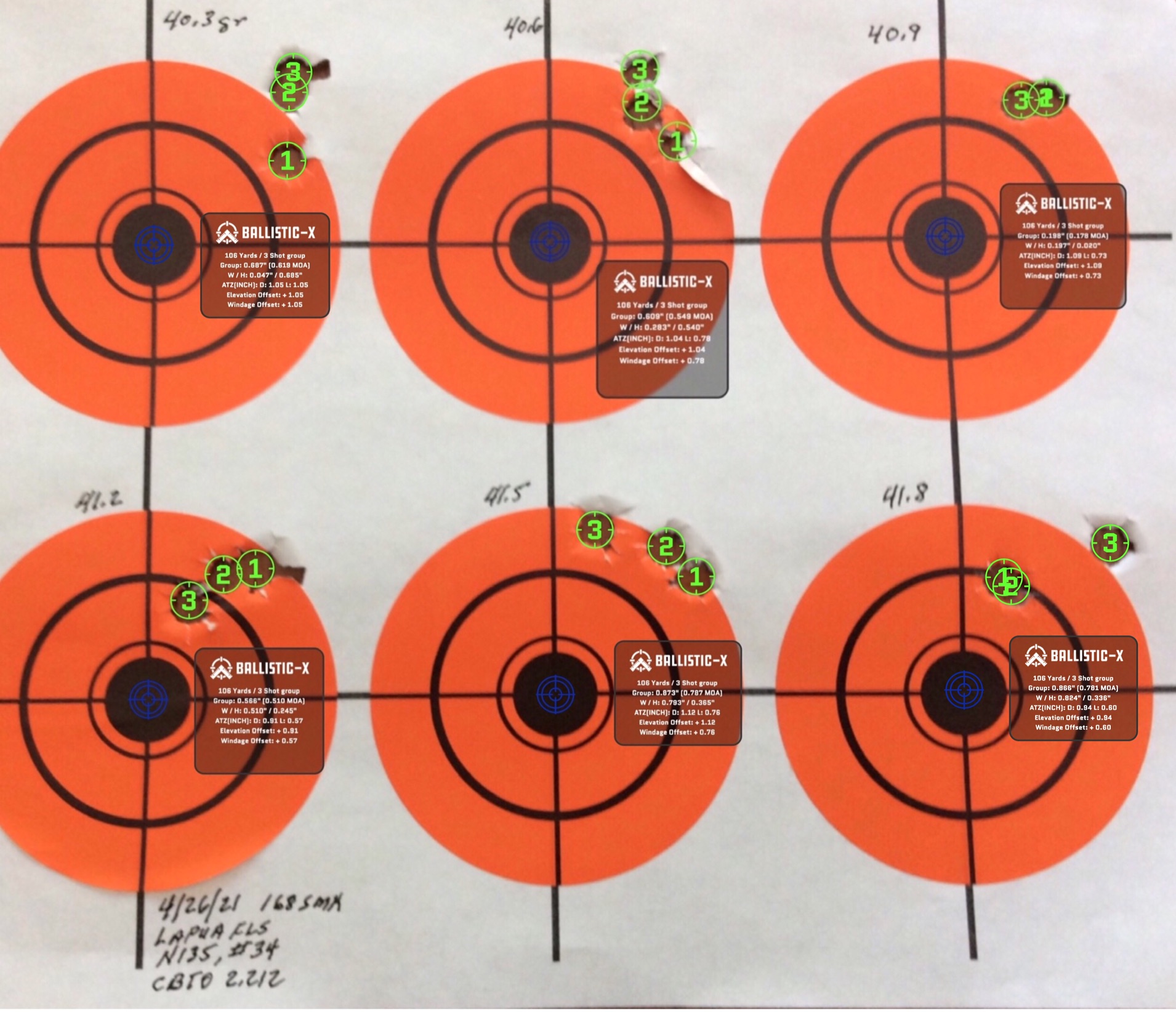

Yep, you’ve got it. If you look at the test below the POI is quite similar on either side of 40.9gr. I was was having to break my setup on each series. In this case the group was also good but that isn’t always the case.

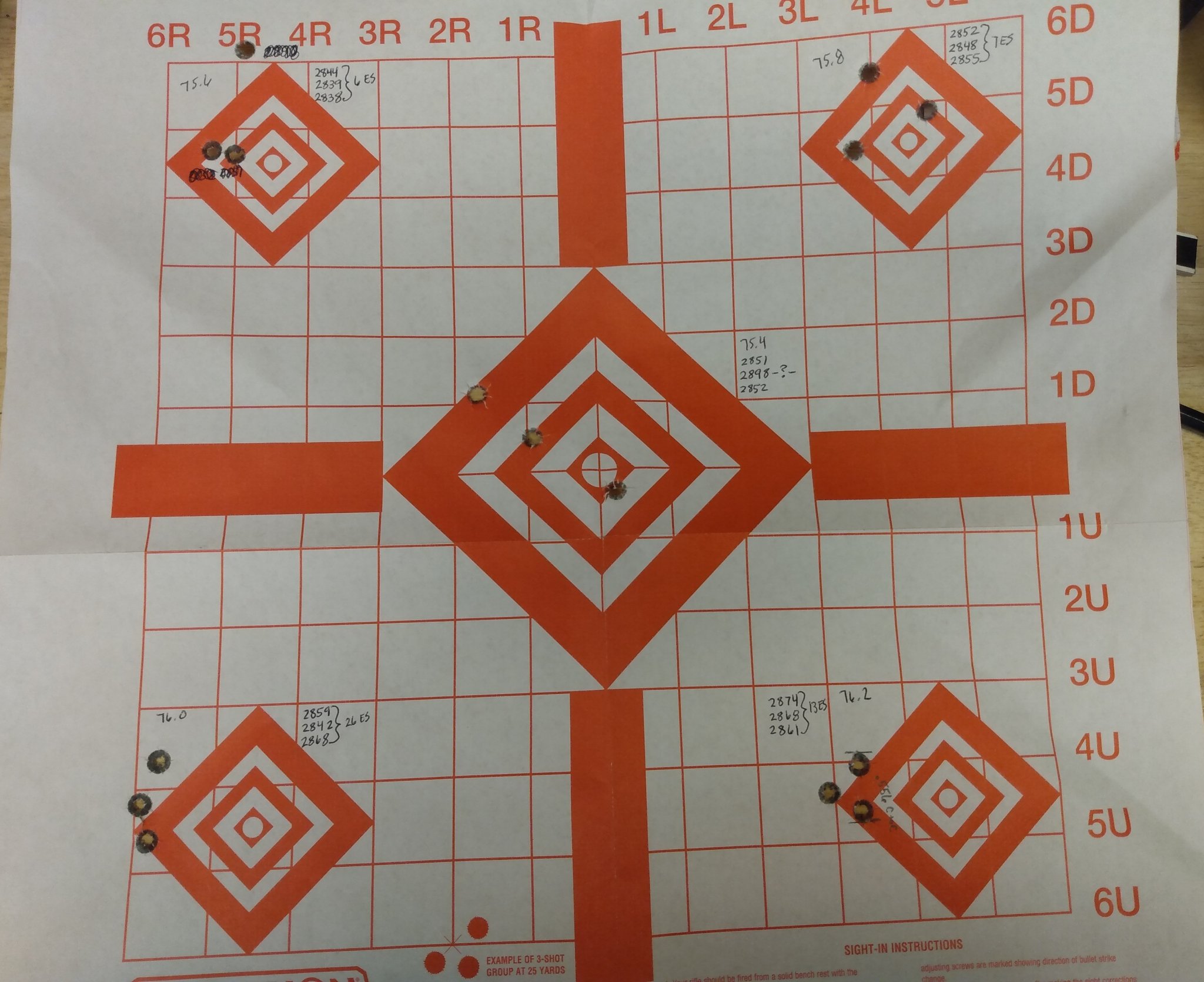

Went to the range today and tried 'em out... 74.0 to 76.2 gr. Temp was 55° or so, and wind was howling about 16 out of the south... I was shooting W to E, so full value from my right. Kind of a pain.
H1000 gave me about 100 fps more than 4000 MR velocities. Other than that, nothing too life-changing. Got about a pound and a half of H1000 left so not sure how far I'll chase this.
Have a couple pounds of Retumbo too. May crack the cap on a pound and see how it does.
Thank you all for the help
Mike

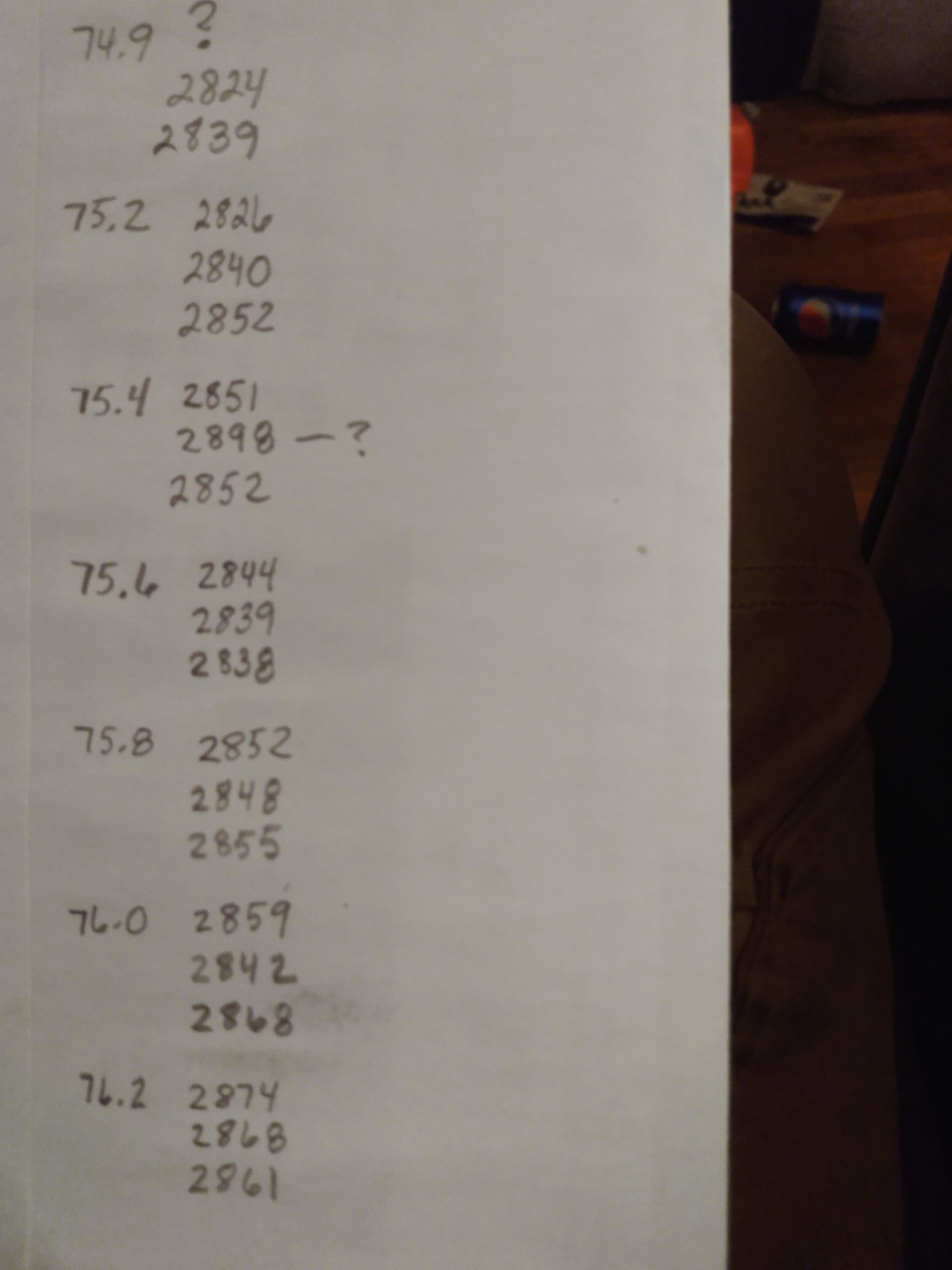

Here are the velocity numbers. I may be wrong on this but I'm thinking I need to go back and try charges in the 75.3 to 75.9 range and see if a trend shows up.
The 75.4 would have been great except for the 2898. Not sure where that came from... Scale hiccup, hot primer, tight case, etc... May try loading a few more at that charge with the "offending" case removed from the bunch and see what happens.
Nothing in the way of pressure signs jumped out at me so I could take it beyond 76.2 and see if anything promising shows up.
Thoughts?
Mike
Groups were nothing special... A few better than others. Pro-Chrono DLX.
Honestly I was mainly looking for pressure before anything else.
Mike
Don't get me wrong, I did check groups. Best was just under .625" with ruler. (Edit: Outside to outside of biggest spread minus .308 bullet dia. came up to .555" with calipers. That's OK, I'd like to do better though)
I just wanted better ES with it. Sorry about the confusion.
Mike
Mike,
Three shots for SD is pretty meaningless. Check out post #28 at

the way I understand OCW is to interpret the position of the groups (POI) relative to the Point of Aim (POA). You'll see the groups trending up/down or left/right but there should be a set of groups (over three sequential but different charge weights) that print similar POI on the target. You're not necessarily looking for small groups at this point (group size is done with seating depth). You're looking for the same POI over a charge weight range.
I'll use your charges 75.6 - 76.0 to make an example.. lets say for those targets (75.6-76) you shot, when the individual groups are overlaid on top of each other they would have a very similar POI and possibly make one respectable group. From there, you can run another charge weight test from 75.6 - 76.2, in smaller increments (.2 increments) to further hone in on OCW. Perform test again and select a charge weight from that set of targets using the same criteria above. From there, you will do a seating depth test to shrink groups.
The point of OCW is to find the node where your barrel shoots regardless of external/environmental factors.

I know. But you always have high hopes that this is the "one" Lol. I loaded up some more and may head to the range and see if I get a clearer picture here in a bit.
I think I may have had some unrealistic expectations for this powder's performance... I need to keep some perspective and do the work. Just aggravating with all the component shortages right now.

76.0 & 76.2 have a similar POI.. wondering where something like 76.4 & 76.6 would land? not sure if you're at the top end of the load here but it might be worth a shot.

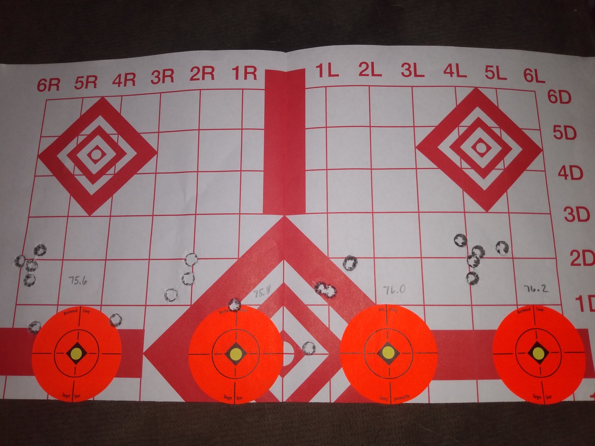

I got aggravated and ran it again at 75.6, 75.8, 76.0, and 76.2
There were a few changes this time... Far less wind today. I shot from a sturdier bench. And I lined up the targets in a horizontal line... Seemed to make the "round robin" a bit easier as I shifted to make the shots.
And as Doom mentioned... My ability is on the bottom end of non-existent. I readily admit it
Anyway, here is the 2nd try. Working from low to high, left to right...
Mike

I am also thinking of going up at least one more .2 gr increment... Maybe two if pressure permits.
I know H1000 is supposed to be temp stable. But I'm concerned if I go up much higher in these 50° temps in January, I may run into trouble come summer when it's 100°+.
Mike

76 & 76.2 still look like they're wanting to group together. The crescent shape you have going @ 76.2 is interesting. Dan might see that and get excited about seeing the next charge up based on videos I've seen of him diagnosing OCW targets. If you can find this high node, there is apparently a lower node 3% lower that works if you're uncomfortable with that higher charge weight.

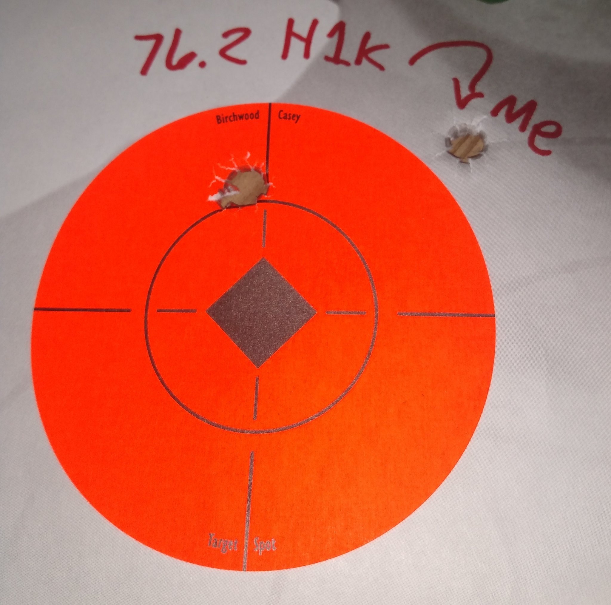

Been a minute. But I managed to get out today and try some of the suggestions...
76.2 gr I put 2 through basically the same hole, but pulled the last shot... Knew it as soon as I did it. I cussed loud enough for everyone around to hear me.
76.4 looked great too... And I managed not to pull one.
Mike

I can’t say for sure but I think the POI shift is due to the shooter. I’m willing to bet the two groups were not shot round robin and the shooting position was broken between groups.
Correct. I didn't do round robin this go round.
Mike
