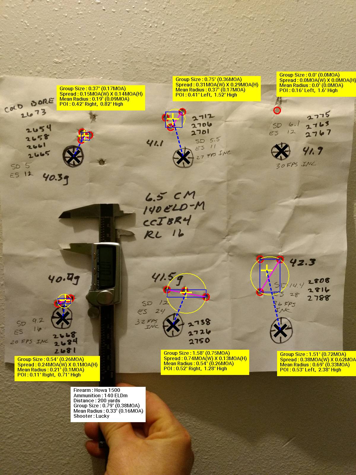

Tried shooting an OCW test ..at 200 yards..with a magnetospeed...first time for me btw. Used .4 grain steps..yeah I know. Also wind blew over my paper and I miffed the 41.9. Also I didn't do round robin on this one.
Determined a node around the the first two groups..40.3 and 40.7. Decided to do another one centered around that.
Speed is fine..42.3 was still safe but I don't like the recoil:) Plus this gun is for new shooters to practice on.

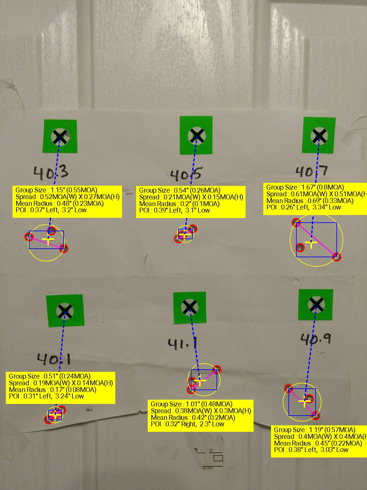

Then I shot this..no Magneto. Also at 200. Round robin..a minute between shots and 5 min between strings. All at 2.84 coal.....045 off the lands.
note..The group at 40.1 I only got two rounds in..skipped first off the ground..so I guessed the impact:).
So theres obviously a node around 40.1 to 40.7. My question is..whats the center? Is it common for the POI
to drop a bit like it did at 40.7 on the edge of a node? or I could've pulled the lower one and skewed the POI center.
Whats my next step? Load 40.4 and quit dicking around and go shoot?
Why would you shoot your OCW in such a fucked up pattern? If the goal is to analyze data, then that data needs to be in a logical order.
Up and down and in a circle, really? If you had shot them in a logical manner with charges progressing from left to right in a straight line, it would make this about 10 times easier to read. In an OCW, you are comparing each charge weight to the ones on either side of it.
Your 40.3 - 40.7 would be a low node, if it is one at all. Why didn't you include the other shots in the group on 40.3? Doing an OCW with anything attached to the barrel puts your results in question before you've even started.

Next time i'll be better prepared. I guess I can write the results down in a logical order to ananlyze.
like so..
POI...3.24, 3.20, 3.10, 3.34, 3.03, 2.30
like so..
It isn't just the height, it is the clock position in relation to the point of aim.
Why would you shoot your OCW in such a up pattern? If the goal is to analyze data, then that data needs to be in a logical order.
Your 40.3 - 40.7 would be a low low node, if it is one at all. Why didn't you include the other shots in the group on 40.3? Doing an OCW with anything attached to the barrel puts your results in question before you've even started.

With RL16 your nodes will be about 1.5 - 2 grains apart +- and about 150-200 fps. I typically run 140s anywhere from 41.8 to 42.6 at 2885-2910 out of a 28" barrel. Every barrel has shot at 41.8-42.6 shooting 140 ELD, 140 Berger BT, 142 SMK and 140 Berger Hybrids. The benefits to shooting a lower node, esp if a trainer/learning rig is less recoil and component life.
only got a magnetospeed. Do I shoot groups with it attached or not?! or both?
I would want to know what it does without a tuning fork strapped to the end of the barrel since you wont be running around with it strapped on for the rest of its life.
But if you want to shoot additional rounds with it on for numbers then thats fine too.

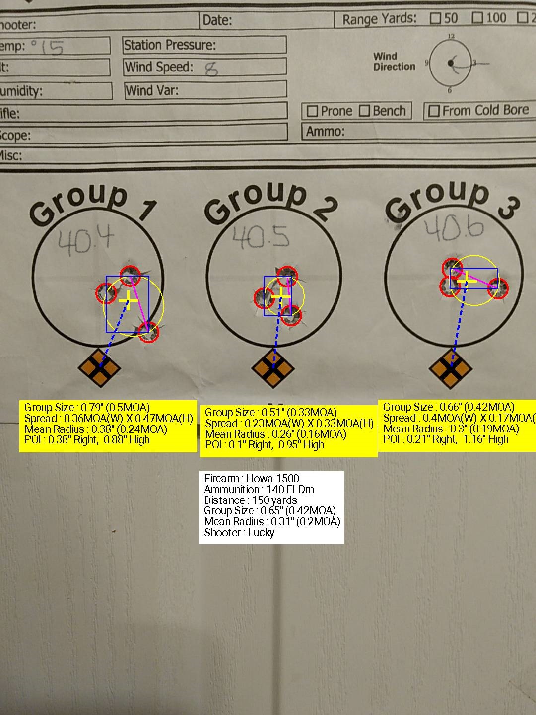

Okay I shot three shot groups of 40.4, 40.5, and 40.6 at 150 yards. Conditions were crappy, foggy and windy and freezing my bullocks. My shooting was crappy. I Know this gun can shoot better then this. Shouldve waited and done it another day but wanted to get it done. Also would've done five shot groups..but this is all the brass I had left in the batch of once fired.
Couple questions.
#1. Does the small rise in POI mean anything? I guess because I saw no POI rise on previous target from 40.1g till 40.7g makes me question myself. Or is it statistically insignificant?
#2. Does this make me or the gun half moa all day long if I do my part?
#3. Is this gun and load considered accurate AF?
#4 Should I just load 40.5 and be done with it?
1) I dont really see any real rise between groups.
2) Sure but not really
3) No, there is more than one hole
4)I would be fine with the powder charge weight, if you want is smaller try a seating depth test to narrow it down even finer.

The small variation in POI you are seeing means little in this context. It is about as consistent as you could reasonably hope for. Your next major move was at 40.9.
You are also fortunate in that the seating depth you decided to do testing at, seems a good fit for the powder charge that won. I would go with 40.5 at current seating depth and call it done.

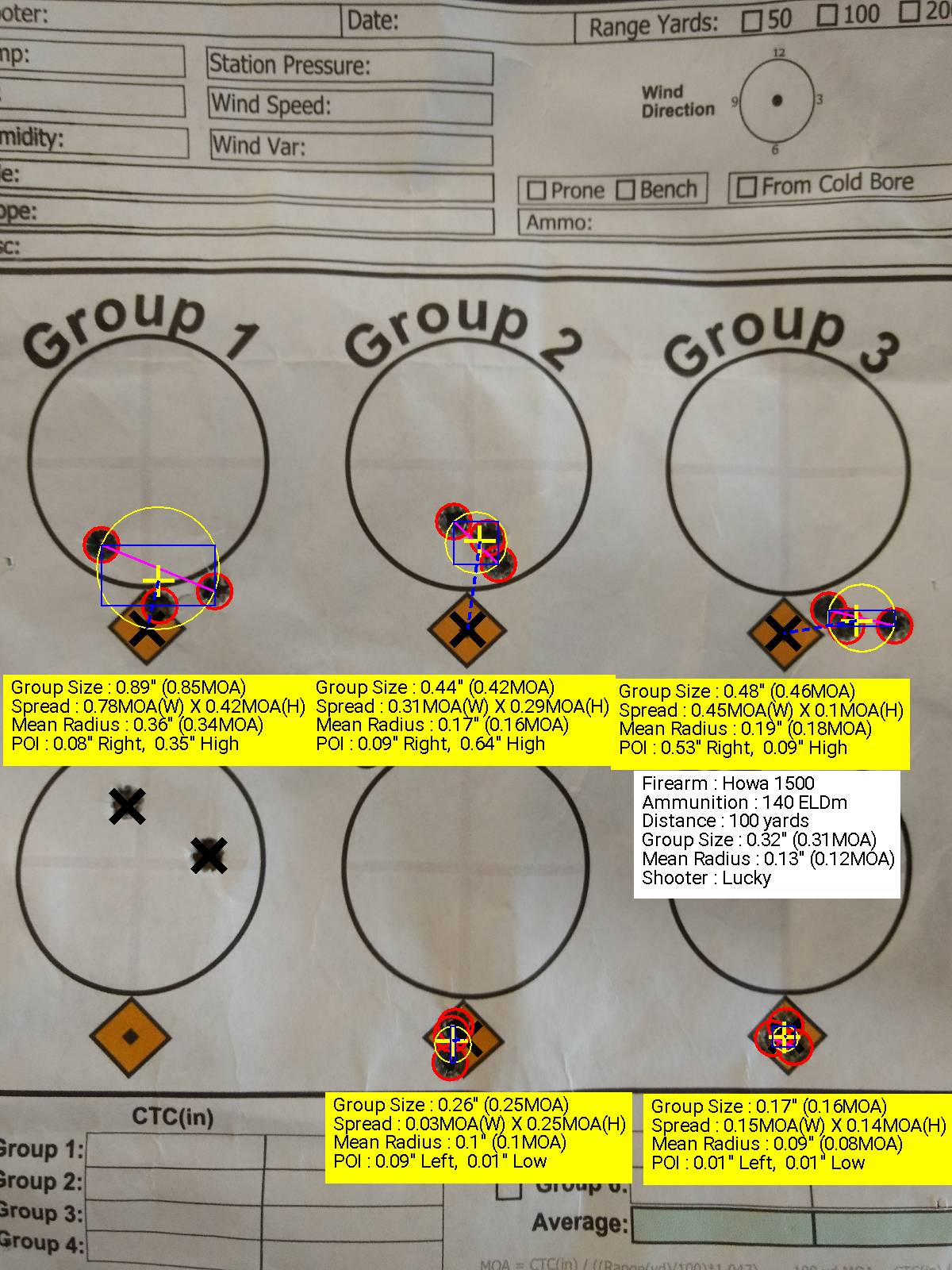

Took the Howa out a couple weeks ago for zeroing and confirming what I suspected. Shot (5) three shot groups left to right, top to bottom. Bottom left were first two sighters.
I confirmed that the gun and load were more accurate that I had been. Shot eight rounds over magentospeed( not pictured). Es 16 SD 5.5. I did forget to use an expander mandrel on these rounds so ES could be better.
Don't discount the seating depth test either. I did a 10-shot Satterlee test and worked up a load with a very nice SD of 4 and ES of 12, but I was annoyed because the group size was barely 1/2 MOA. Went back and did a seating depth test the following weekend and found that seating depth was the missing link.
