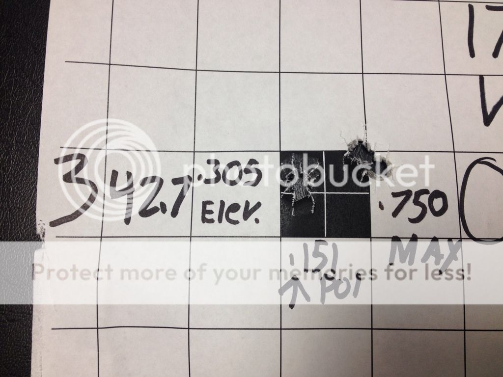

Ok guys I need a little advice again.
The test wnet great perfect weather, but there all so close i dont which one to choose.
Rifle
Remington 700 sps tac AAC-SD 308
Konus 8.5x32x52
EGW 20moa rail
Weaver 6-hole rings
Jewell trigger
Test conditions
100yds
78 degrees
overcast no sun
0-3 mph wind
Test loads
2.900" oal
fed once fired brass 2.005
cci br2
178-AMAX
VARGET
42.1
42.4
42.7
43
43.3
43.6
43.9
44.1
If you cant understand my writing on the target just ask
Thanks Micah
Re: OCW Test help
Re test 42.8 to 44.2 in .2 grain increments and see if you get similar results....I'm betting your node is going to be somewhere around 43.5 +/-, and you EASILY have a full grain's worth of accuracy node there (43 to 44).
All you gotta do now is prove it out.
I'd say do it in .1 grain increments, because that's what I would do....but .1 grain increments give some people a faint feeling.
