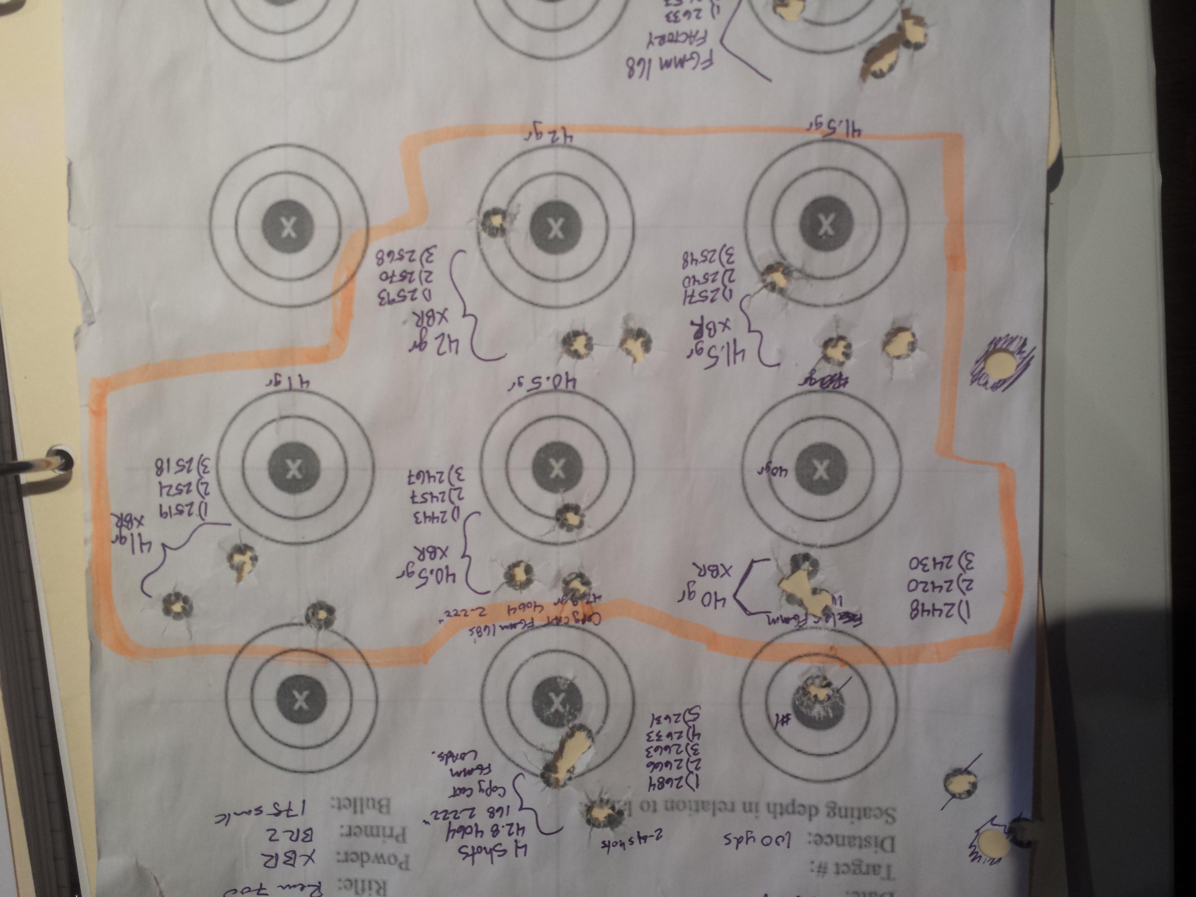

So the conditions were horrible but I had an itch so I went ahead and shot some of my test loads for IMR 8208 XBR powder, New Lapua brass, 175 smk's seated to 2.222" (ogive). I only had a little bit of brass left for loads so I used a range of 40-42 grains in .5 grain increments. Attached is a picture. It seems I should test some higher powder charges as I have no pressure signs. I think the middle node is at 40.5 grains. But it is hard to tell seeing I only shot 5 groups. Anyone know why the image is upside down??? I noticed on another post another image of mine was sideways? What gives, they aren't that way on my computer.

Nothing real promising looking there, keep going up and see what happens. Try .3 increments instead of .5.
