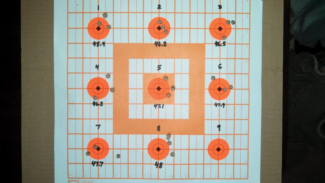

Rifle is a factory Blaser R8 23.7" match barrel(.308). Performed OCW test @ 200 yards. Any guess on the OCW ?
Thanks, Jimmy

I'd concentrate on 46.2 grains. The scatter node at 46.8 would point back toward an accuracy node just over 46 grains.
The higher charges are probably generating too much pressure for good accuracy. We've seen the CFE223 do this same sort of thing... while these powders drive hard, they have their best accuracy lower on the scale, it seems.
I'm sure your velocity will be very good at 46.2 grains.
