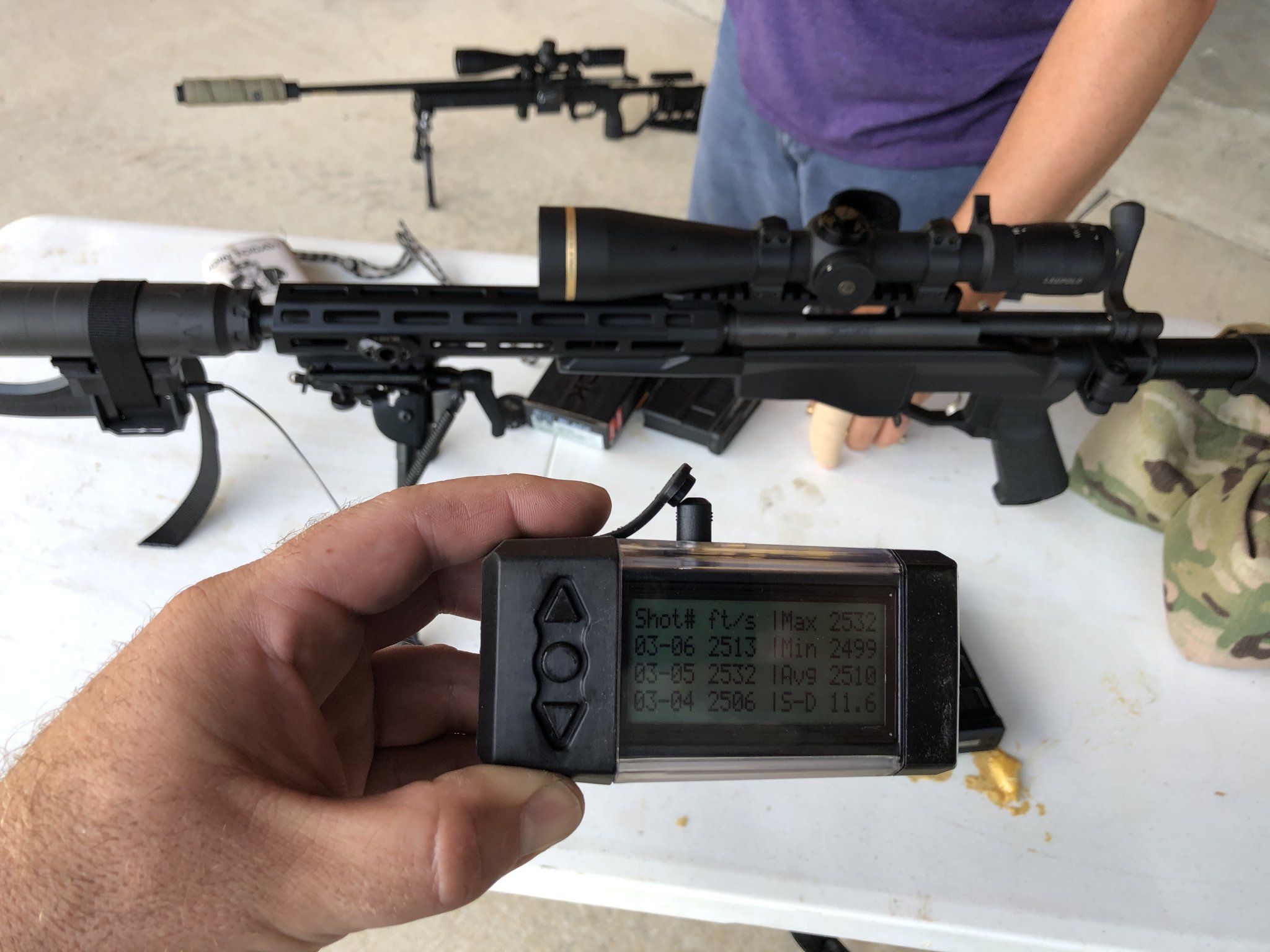

Just got back from the range and my LMT MWS with a 13.7" SS barrel was showing 2496fps on the magentospeed. This checked out in drop when running out to distance. Does that seem right? Was expecting closer to 2350-2400 on a good day.
Ammo: ppu 168gr match

To be honest, that seems higher then what I would expect. Maybe your LMT MWS has a tight bore. ( ? )
I haven't chrono'd anything out of my 14.5" , but I am basing my thoughts on this barrel cut down article.

I was going to post that same article, as well as cross-reference a .308 specific internal ballistics engine.
PPU states that their mv is 2610fps on the box from a 24” barrel I believe.
Were you shooting suppressed and what was the temperature outside when you were shooting?
What does your brass look like?
That seems a little fast, but my guess is a hot load from PPU. I am running 147gr ball ammo through a 13.5" Ballistic Advantage barrel and getting about 2500fps.
168gr FGMM ran at 2341fps from my 12.5" Ranier Ultra Match barrel, while suppressed with an SDN-6, FWIW.
Not apples to apples, as it's an inch shorter, but a 168gr factory load nonetheless.
I get 2418 out of the 147gr PPU from my 11.5" barrel.
168 GMM is 2343 and 175 GMM is 2260 out of the same gun.
