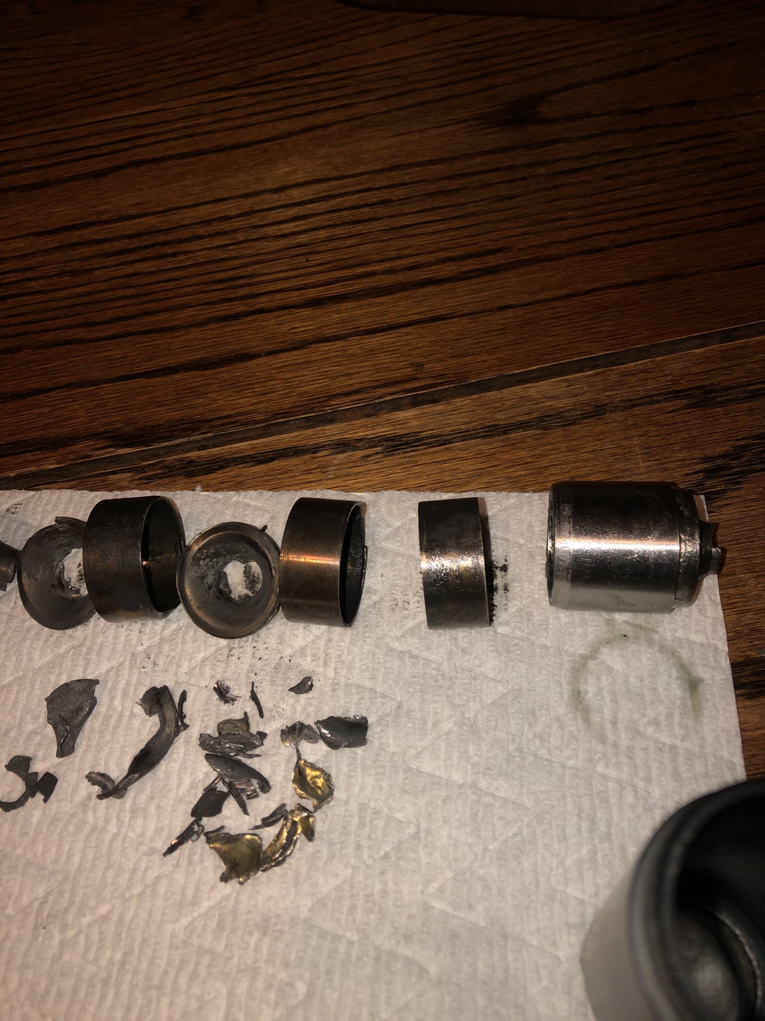

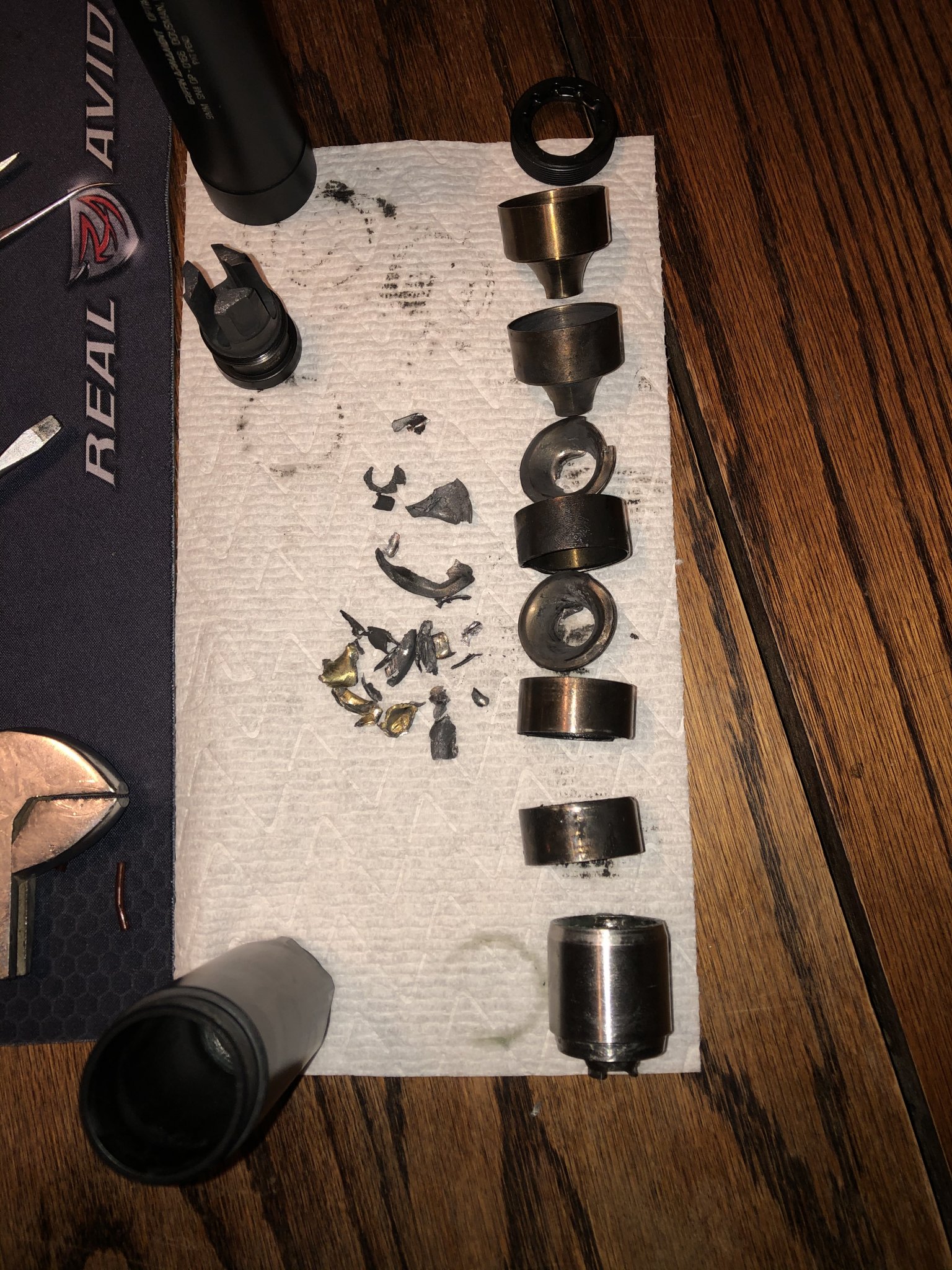

So how did this happen? I’m taking the gun and can to a local Smith but any suggestions would be appreciated.
It’s a Griffin Optimus. It was secured with one of their taper mounts. It was on an AR9 when this happened. Blast baffle no damage. First three regular baffles demolished. Fourth an fith baffles untouched and end cap blown off. Never saw it. Never heard a noise change and couldn’t find it. Baffle securing ring untouched.

No. It was not disassembled prior to this. It has been together and used on an AR15(233) and an AR10(308) along with an SRS (6.5cm). Just not getting how the blast baffle and last two baffles were untouched but first three were and the end cap was blown off.

Upon further inspection of the pic, Sirhr is correct that the can contained the complete round that impacted the baffles. You can observe the complete jacket and demolished lead.
Only had 20 TD’s fires yesterday when this happened. Yes it’s been on it before but only 20rds then too. There were many more pieces of jacket and baffle and what I believe was lead that didn’t make it home with me. The rounds are not hollow points. Used shims not crush washer. The van is rated From 22 thru 300WM. Have used it on 9mm pistol for years without any problem.

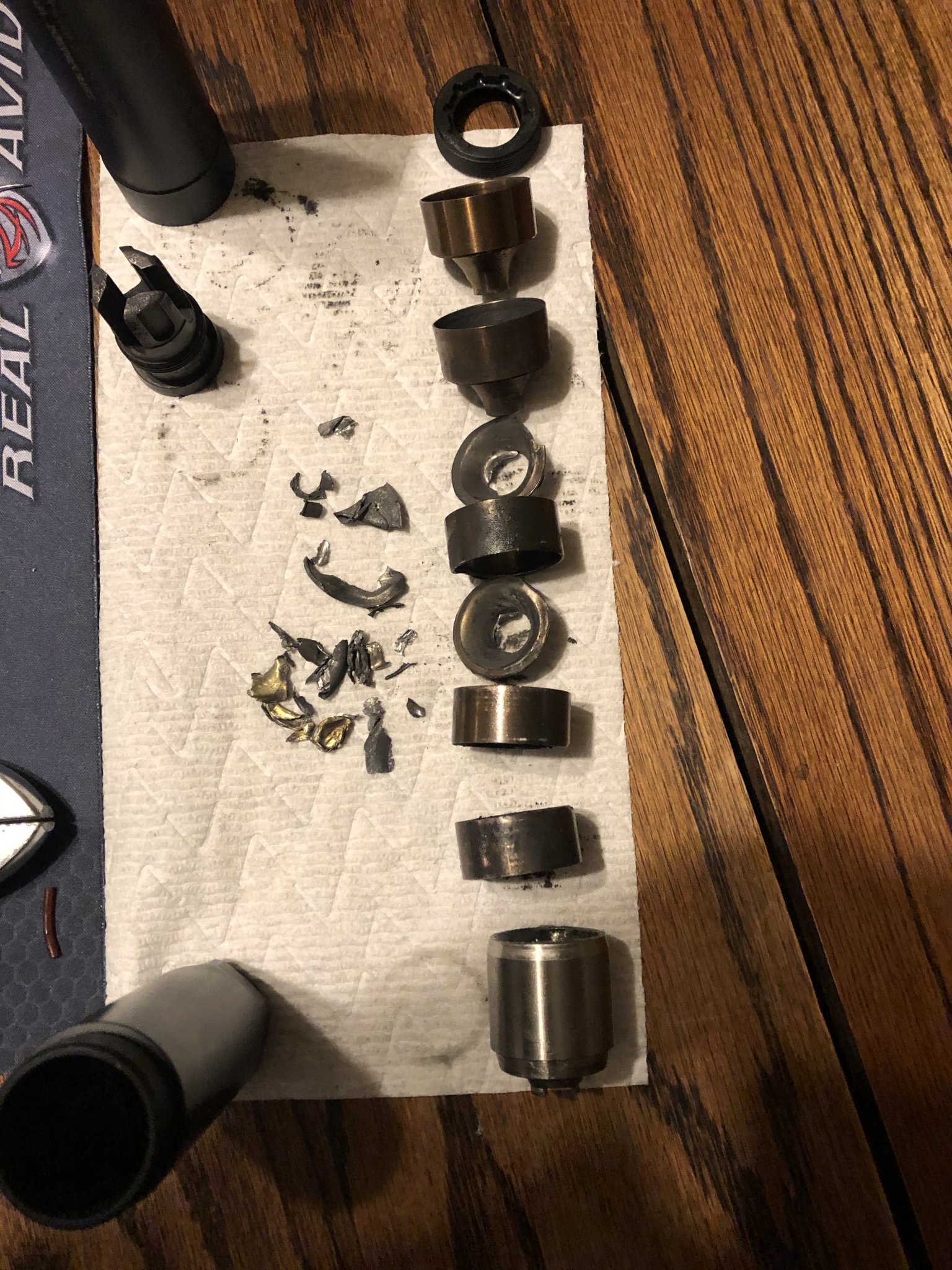

Was this a .30 cal can? The damage shown would be exactly what I would expect to see if a .355 bullet was pushed through a 30 cal can.
Hangunnr is correct in a way. The blast baffle that the OP mentions is for use with up to .30 cal only. For 9mm, it should have been configured with only the 5 coned baffles.
When the Optimus first came out, there weren't any 9mm taper mount muzzle devices so you could only build it as a 9mm suppressor using the 3-lug or booster and piston adapter caps. In that configuration, you could not physically install the rifle blast baffle.

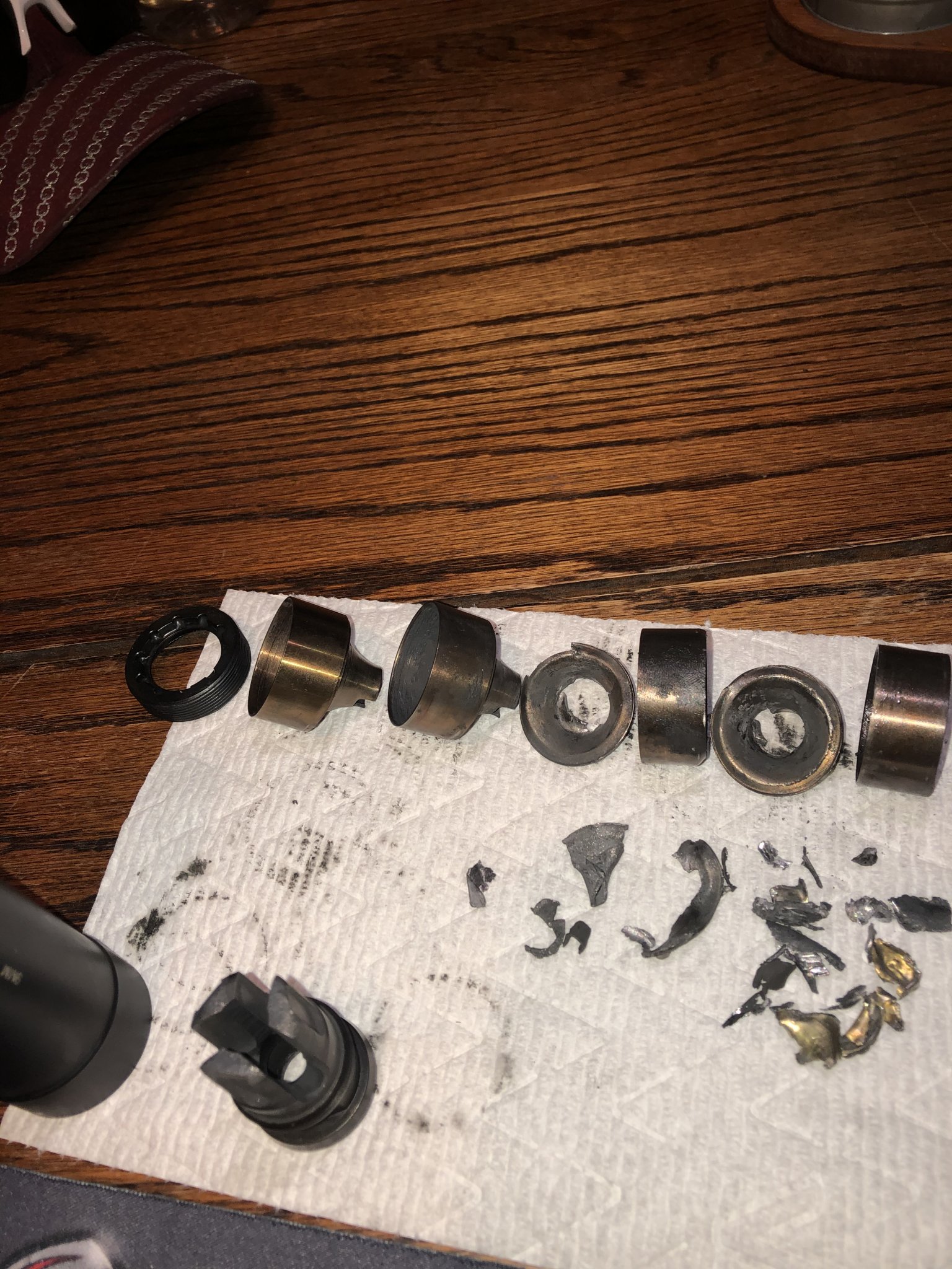

The dual taper locking "blast baffle" is a .30 Caliber part, so thats what caught your 9mm bullets! Any 9mm host configurations should delete that baffle in assembly. Its ok, this is a relatively simple fix. We'll examing the silencer, disassemble the parts and assess the damage. Turn around should be quick as we have Optimus parts on hand and will be able to rebuild it no problem (so long as the tube isn't damaged, which with the shielded baffle stack... I almost guarantee its perfectly fine)

Looked like a case of hole too small for bullet.
