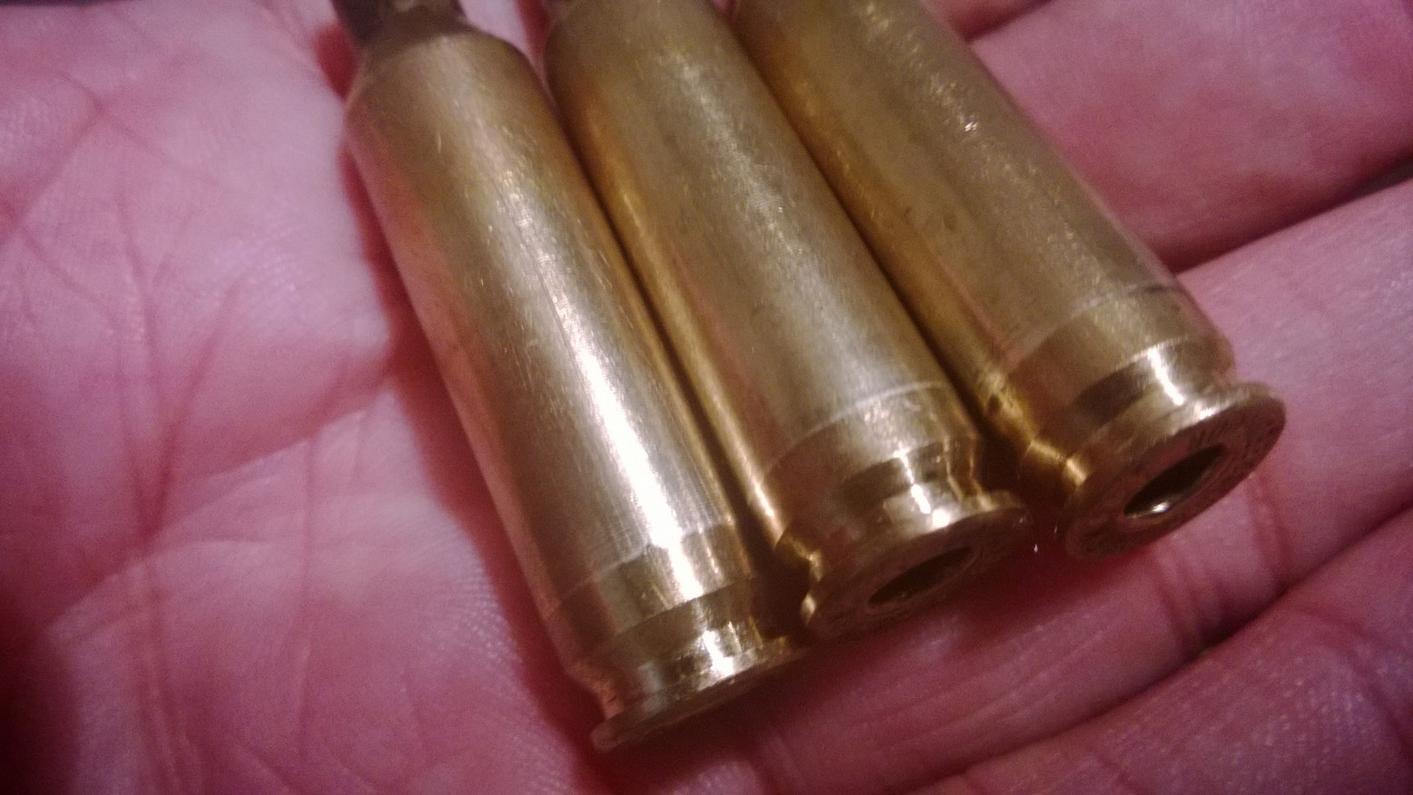

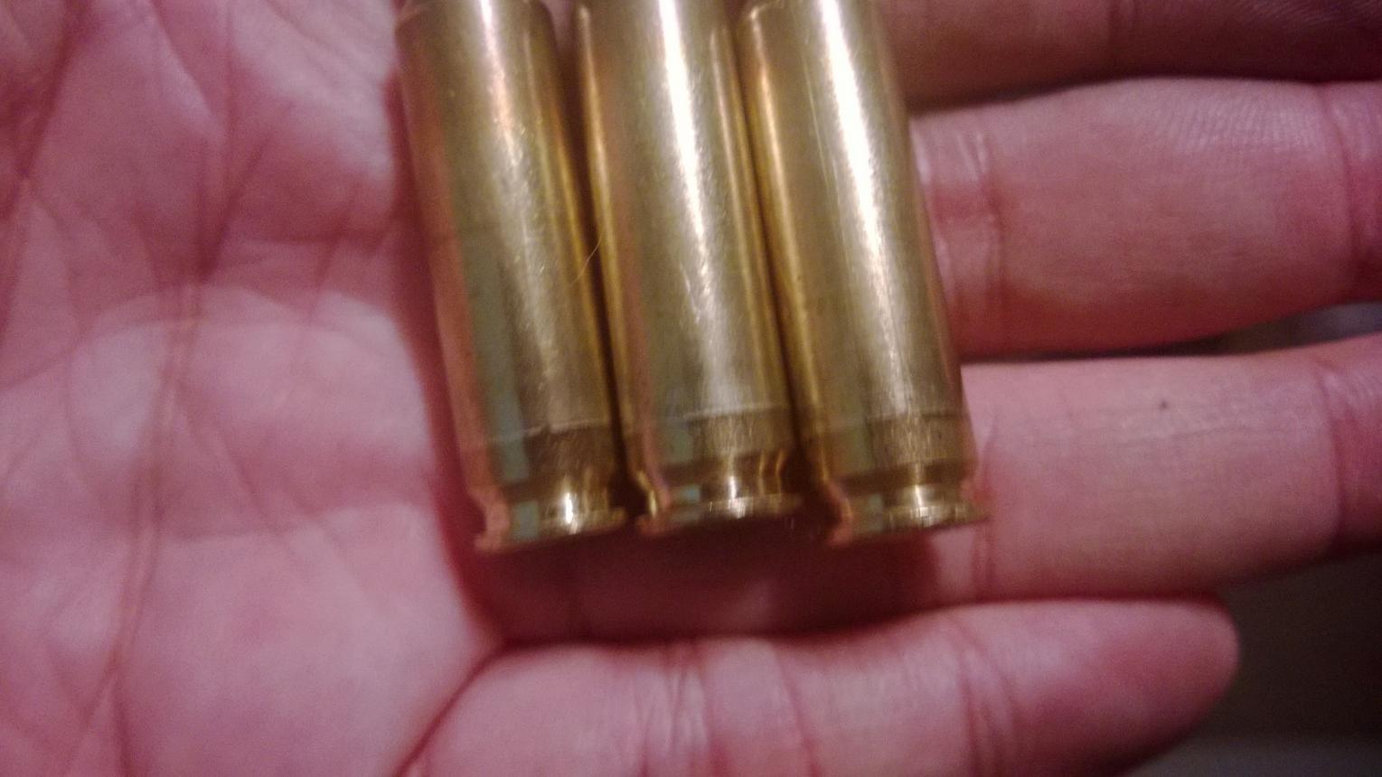

This is my 1st time doing full length resizing. This brass is from my 6.5 Creedmoor once fired factory ammo. I couldn't find a neck sizing die so I went with some Hornady dies since I was able to get some. Drove the ram all the way up tightened the die till it touched the shell holder. I don't know if its just where the brass was worked or there is something wrong. There is no bump or ridge that I can feel with my fingernail.
Friend of my from work asked if they were small base dies but I dont see anything on the box about it being a small base die.
Any thoughts?
-Bigzam

Looks like the marks left from full length resizing. You might take a paperclip and feel around the inside of the case for anything just in case it is the beginning of a case head separation, but most likely just the resizing marks.
pretty standard look after being sized hard, RCBS may size them a little larger
I have a set of those dies . I load for a friend. Not my caliber. Yet. Oddly, they specify NOT camming over. I backed off a half turn to just neck size. The arris formed at the juncture of the neck and the shoulder was burred and left obvious and deep scratches on the neck.I'm not a Hornady die user ordinarily but RCBS only makes a gas gun set and I do not have gelt for Redding. Ugly but servicable.
Ill bet the brass is about .004, .005" bigger above the ring than a round not yet fired in that chamber. Slice one open and if uniform, run em.
What you are seeing is "NORMAL" case expansion after being fired, the brass expanded outward to meet the chamber walls. When you full length resized, your dies compressed the case and what you see is the result of the dies compressing the brass.

Thank you gentlemen for all your input. I went ahead and prepped them today but was holding off putting primers in them till I got some feed back. I will finish reloading them out. Thanks!
