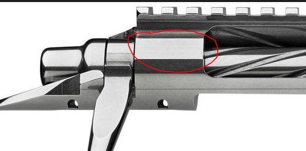

Additionally the rear part of the action is shorten for a larger ejection port so if you do not initially push straight forward the bolt can bind up on my deviant tactical... not sure if other folks have this issue?
Not sure what you are talking about here. Defiance has some of the tightest tolerances of the available actions. So much so that some people avoid them as dust can slow them down quickly. They don't have the kind of play that can cause a bind. My guess is you are having feed ramp / bullet angle issues.
It has nothing to do with a dirty action or tolerances. If you look at the rear of the action the initial entry point is shortened to allow for a larger ejection port... this is the area I am talking about.
Ok final update. I spoke to Roy at Defiance who was super helpful and explained that the any pressure on the bolt that does not go straight forward can cause the issue. He suggested that I dry fire and use my thumb on the rear of the bolt to get it going straight forward thus avoiding the issue I am experiencing!
