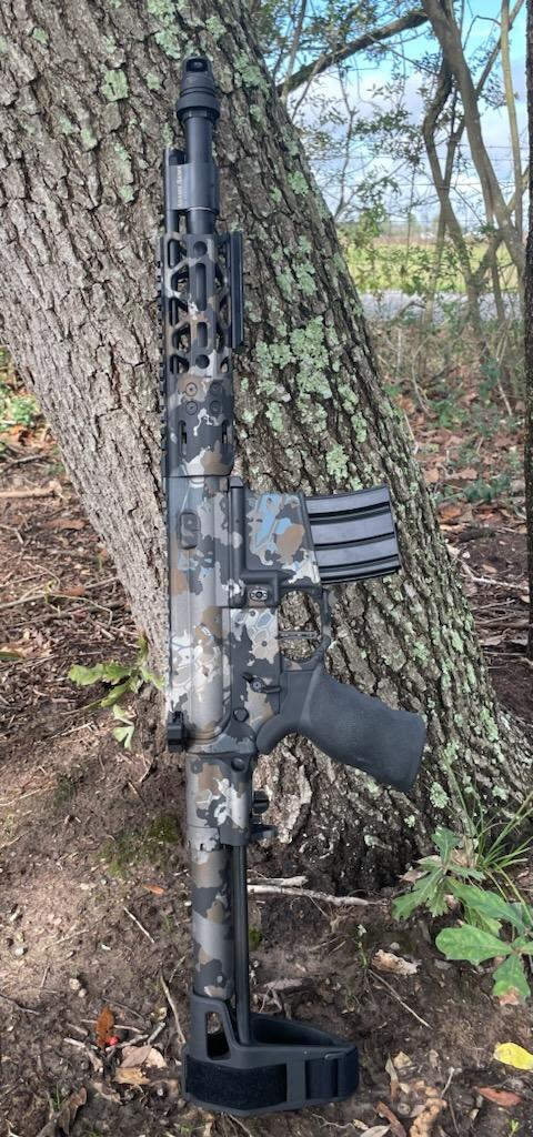

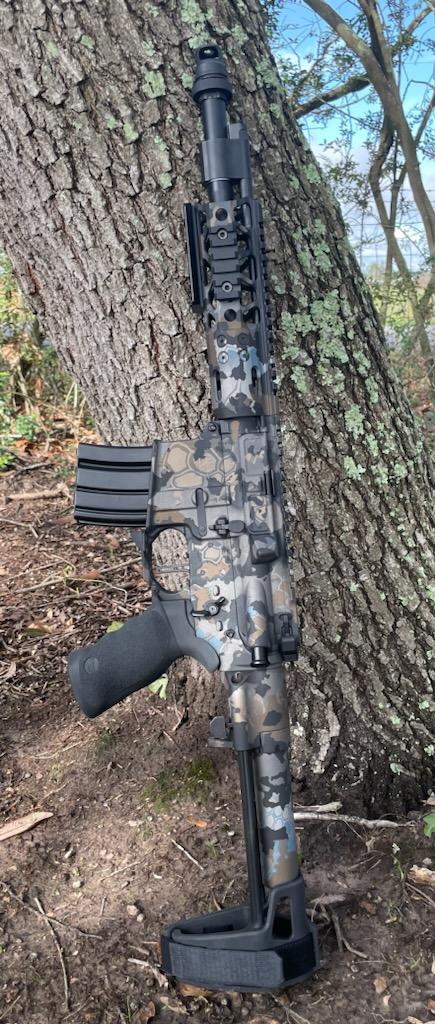

I have an Odin barrel on my AR pistol. It's a 10.3 I think. I didn't have a lot of options at the time so it was the best option that I could get at that length with a carbine, but I will say, it's a very very nice barrel. I have been pleasantly surprises how nice and it shoots pretty well, but I haven't had a lot of time with it yet. If you can get one if the known quality barrels like Bartlien, Kreiger, Douglas, Benchmark, Hawk Hill, that's what I'd do because I think you have a very good chance I'd getting a barrel that shoots excellent that way, but I think you'd be happy with the Odin as well

I don't know if Odin makes it or has someone else make em but the fit and finish is exceptional, at least on mine. The gas block area is precise, the feed ramps are perfect and polished, the rifling is perfect, the crown is perfect, and the chamber is perfect. I wad curious so I looked it over good and with my bore scope. My buddy who did an absolutely astonishing job cerakoting the gun even noted how perfect the barrel was. He takes apart and puts back together a lot of guns to cerakote them and he took note of it so....
Criterion is very good as has been said and I like criterion barrels a lot, just offering some info on the Odin barrels.
