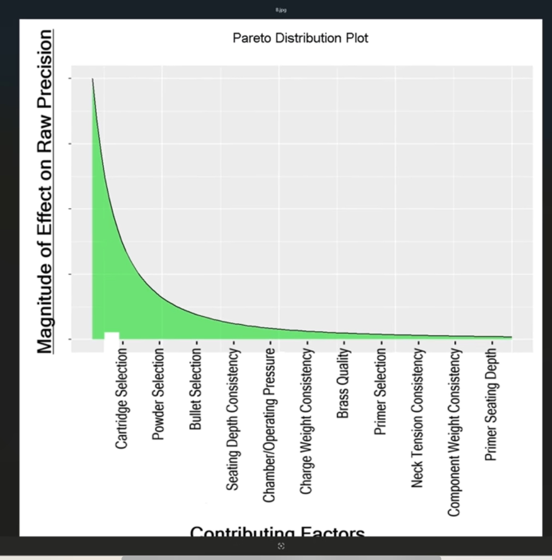

    Little Crow Gunworks recently did a video where he discusses this and I tend to agree with most of it, here’s the video
    TLDR:
    The above posted graph just about says it all.
    A good load is about cartridge and component selection and then consistency of the values you load to, rather than the actual values themselves.
