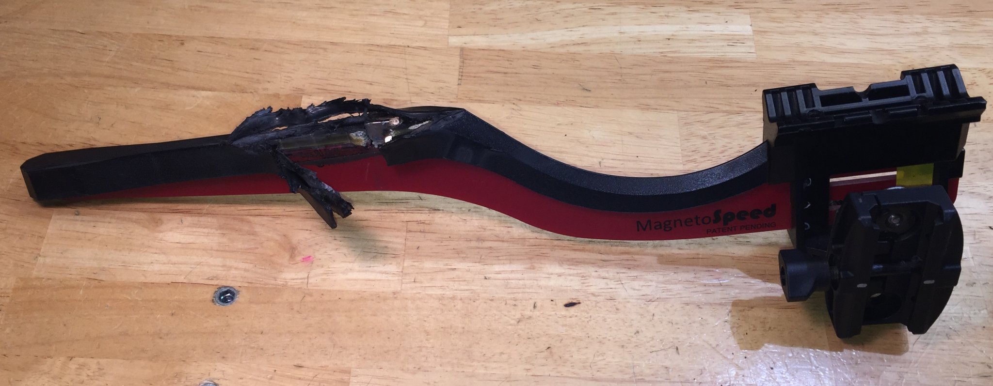

Cracked in numerous places. It's a rather complicated mounting bracket for the bayonet. I'm sure these guys racked their brain to do this but it's plastic. Recoil from 6.5 CM and 300PRC split the plastic. The bayonet slides back n forth to get closer or further to your bore. Then it is secured in two ways. By tightening the strap and tightening a set screw on only one side. The strap is configured in such a way that the tension is always pulling the bayonet toward the bore....yeap you read that right! This is then mitigated by one little set screw on only one side of the moving plate. The vibration from recoil not only cracked the plastic but also causes the bayonet mount to can't off parallel to barrel. This is due to only one side having a set screw so the plate moves by way of least resistance. At the very least it causes one sensor to not read and in my case a destroyed bayonet. After receiving the new bayonet and new "free" Wiser parts I hit the range with my 6.5cm and I had to reshift the mount "center with barrel" to allow a consistent read. Once home I realized the mount had cracked again. If I were you I would check your bayonet's distance from bore after every shot.

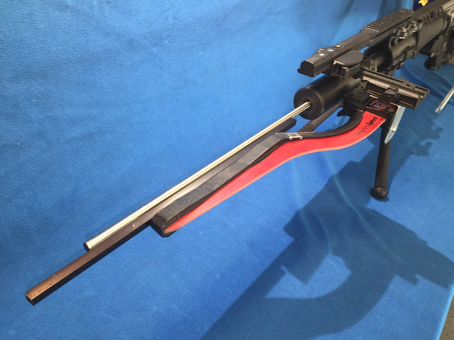

Here is one example of parallel mounting on handguard and another pic of a rail mounted to sling swivel that you can clearly see will not mount the bayonet parallel to the barrel, due to no cant adjustment on any available system. This is what my post is in regards to.

I have the wiser mount, it broke the other day after tons of use.
I’m pretty sure from bouncing around in the back of the car a lot.
I glued it back together with some acetone.
Eventually I’ll make my own mount.

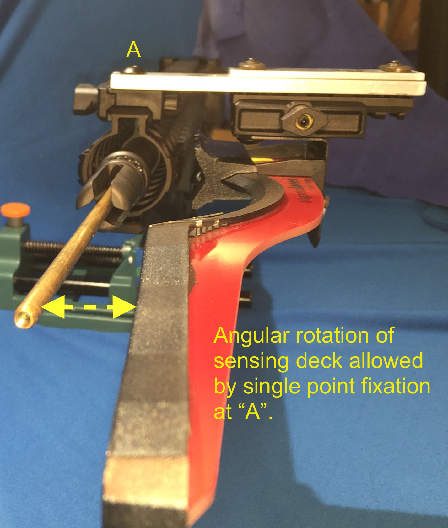

I eye balled a close alignment while the alignment rod resided peacefully at arms length away.

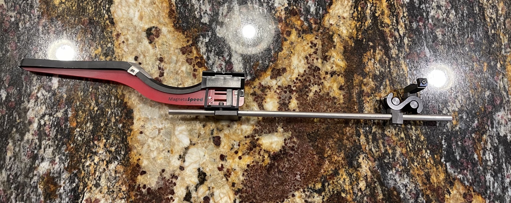

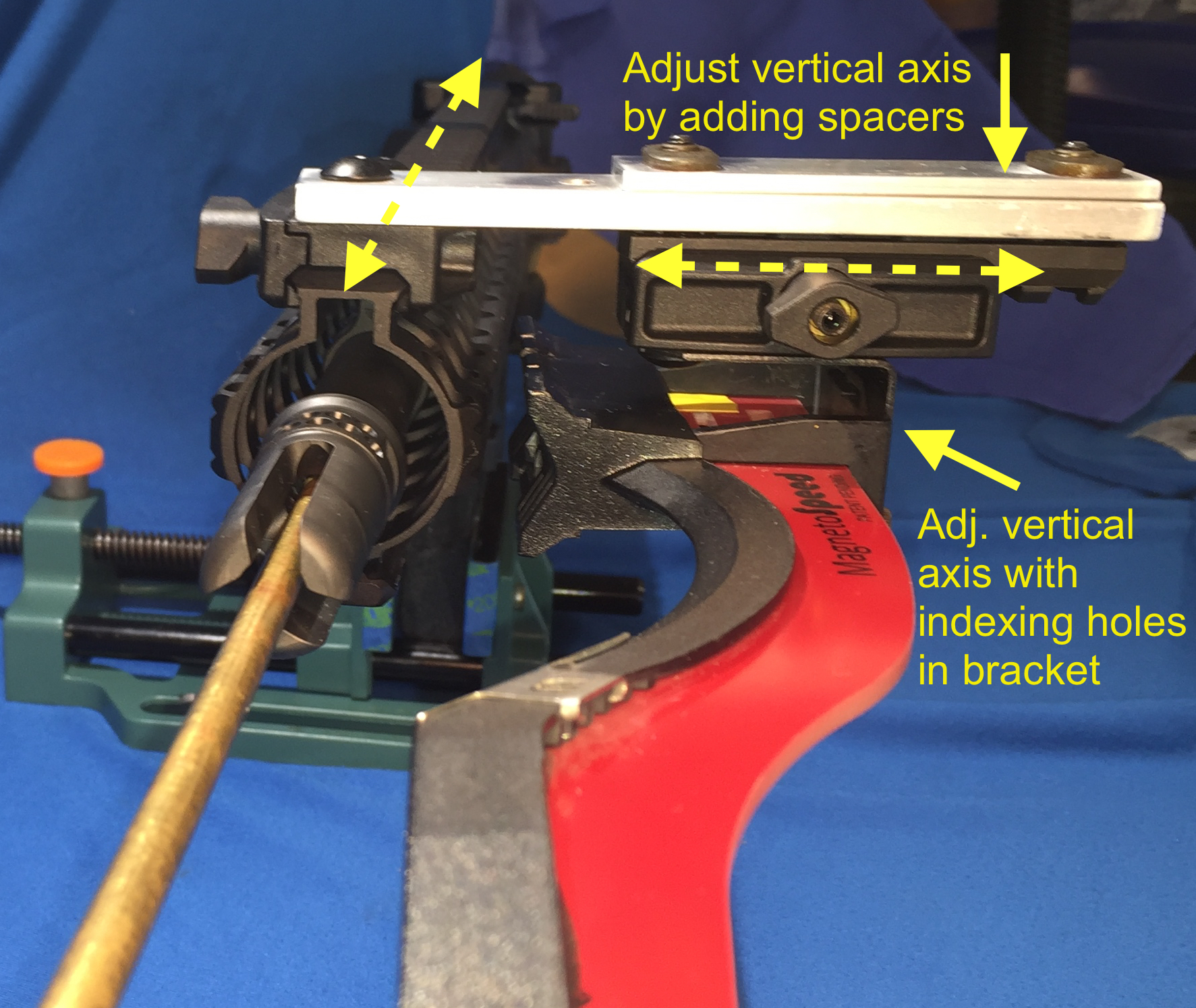

Not sure this will help but it sounds like something like would work in your situation for load development, probably not so much for in-match use.
I fabricated a free floating mount system that employed and offset at adjustable point "A" pivot point that will allow the bayonet to be parallel to the rifle stock barrel as needed. The bayonet can be adjusted in 3 dimensions.

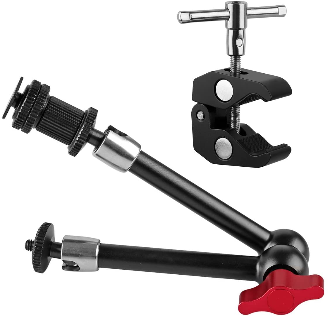

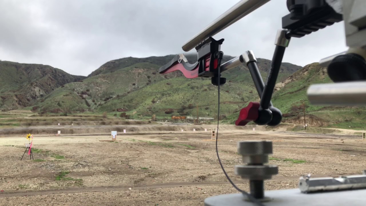

Sounds like the DIY "magic arm" mount would solve your problems. Pretty cheap to make and can suit any angle, any stock. The parts can be bought off amazon and just drill and tap the QD pic mount in the front to accept the magic arm. Note, the first pic is not my rifle and this is not my idea, i found it on the internet yesterday and ordered the parts today for an off barrel mount that won't cost me hundreds of dollars because I live in Canada.
I fabricated a free floating mount system that employed and offset at adjustable point "A" pivot point that will allow the bayonet to be parallel to the rifle stock barrel as needed. The bayonet can be adjusted in 3 dimensions.View attachment 7594817View attachment 7594818
That looks really simple and effective. I like it but I don't see a way to use this on a swivel stud on a regular rifle. Handguards and chassis run parallel to the barrel already so mounts from MK, David Tubbs and Wiser work fine. It is a nice set up though
View attachment 7594840View attachment 7594841View attachment 7594842
Lol, I gotta say it's funny looking but it probably would work as long as it stays within adjustment. Let me know how that works out. Im always a sucker for spending money just to try something
I'm sure it's just a matter of time. 50 yrs ago we would scoff at alot of things we do today that are common place. MV is one very big part of the equation that must be paid close attention to. Inside a scope would be super....expect to pay big for that one
I’ll let ya know for sure. The arm is rated for 20lbs so it should have no problem handling the light weight of the bayonet. I’m setting it up with the QD picatinny riser so that I can either mount it at 3 or 9 o’clock on my chassis rifles or mount it on my pic rail on my traditional stocks and mount my atlas underneath it on the same mount. You can buy a swivel stud to pic rail adapter as well if your traditional stocks have a swivel stud.
Hey, very interested in this as well.. can you list the various items from Amazon?

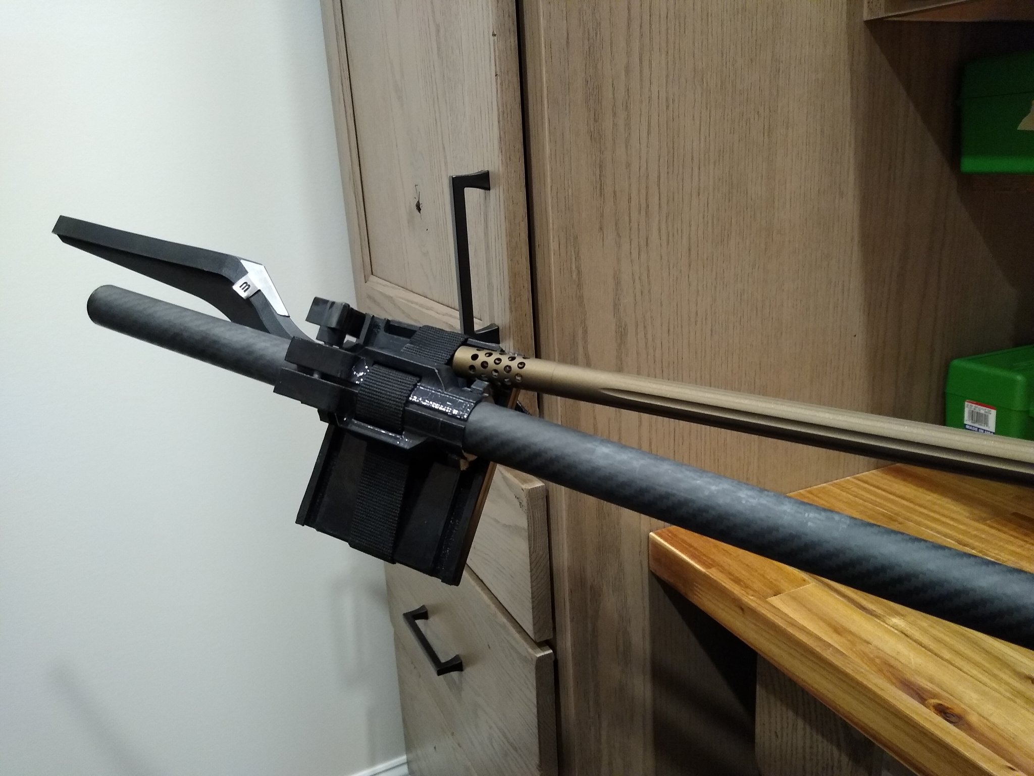

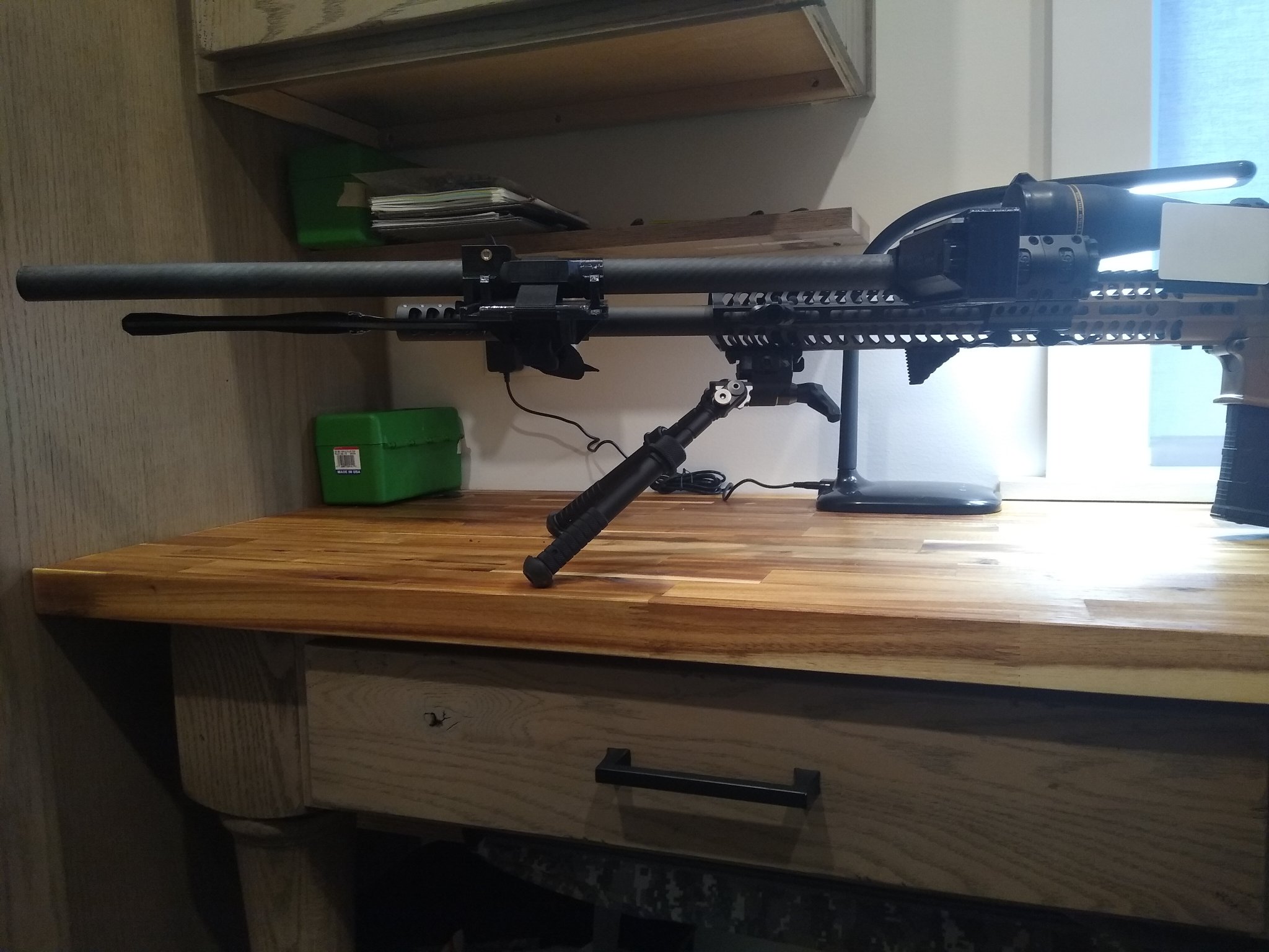

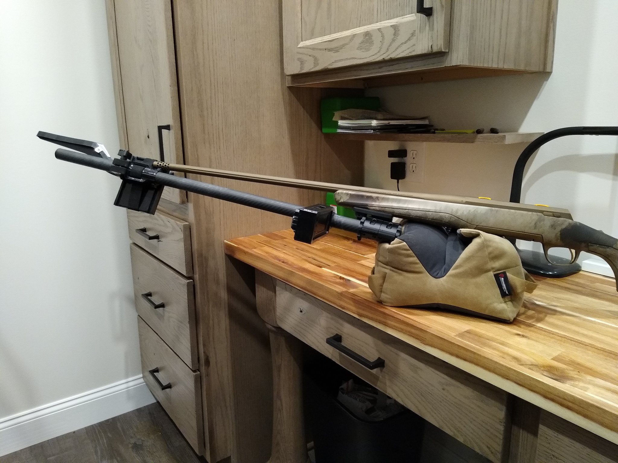

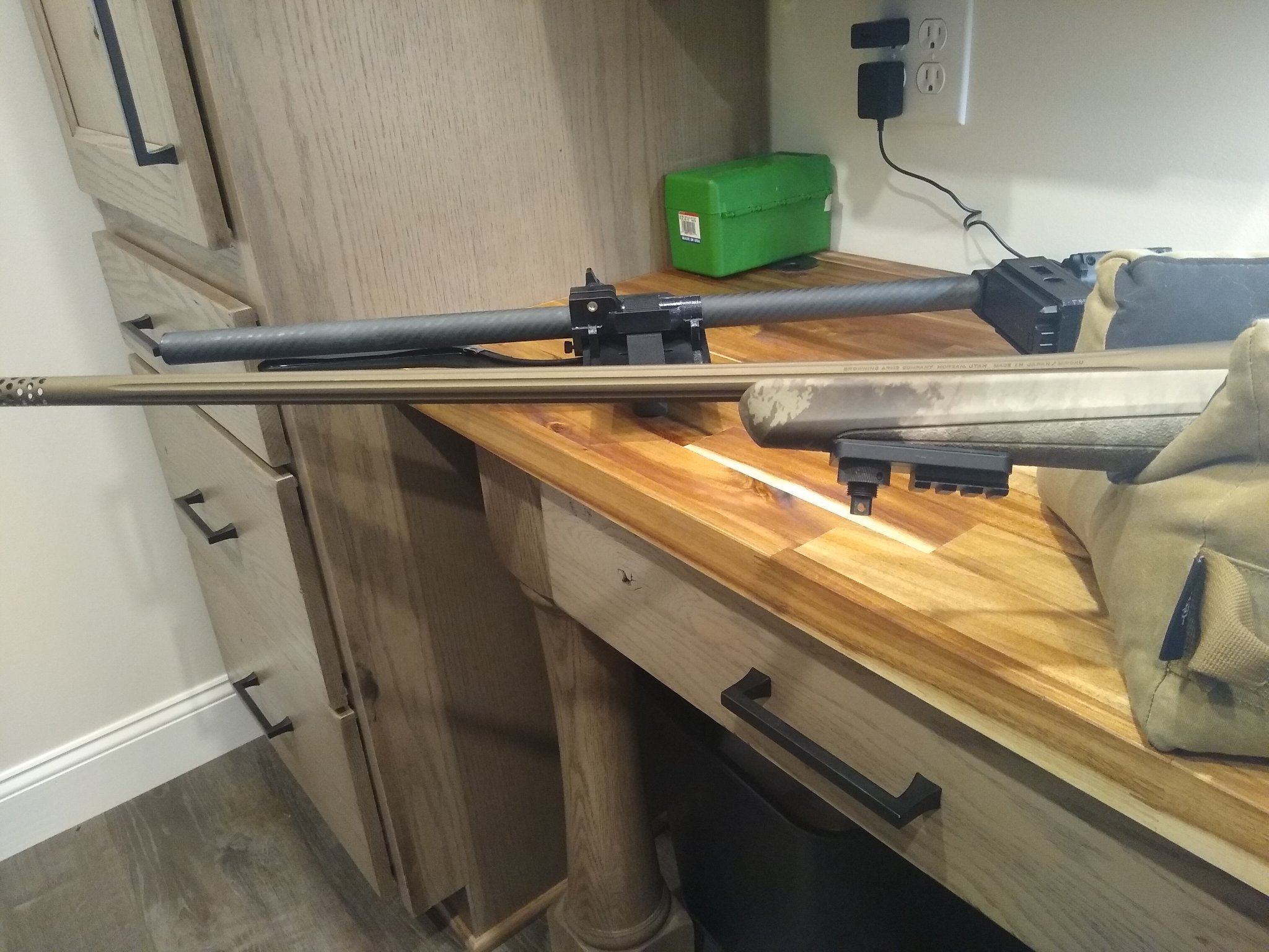

OP, the Wiser mount has some cant adjustment that you access by loosening the clamp around the target-side plastic bushing, then spinning that bushing around the carbon shaft 180°. There's a little label on both sides of the bushing, one says "+1.5°" and the other says "-1.5°". By spinning the target-side bushing, you end up with both bushings on the "+1.5°" setting, which makes my MS bayonet pretty darn parallel to the barrel in my stock B14 HMR. I think the stock in your pic has a more aggressive forend cant, but it might get you pretty close.
Thanks, I'll measure the angle, but this looks like maybe 3-5 degree. David Tubbs Mount has 2 bars that can rotate. He suggested bending one bar and then rotating it to the correct angle. What's a couple hundred more? I've only just begun trying to accurately mount a Magneto for 3 yrs now😆
Go to this YouTube video and read the description in the video, it has Amazon links to the parts required and also a link to a different forum where he talks about the steps required along with pictures.
