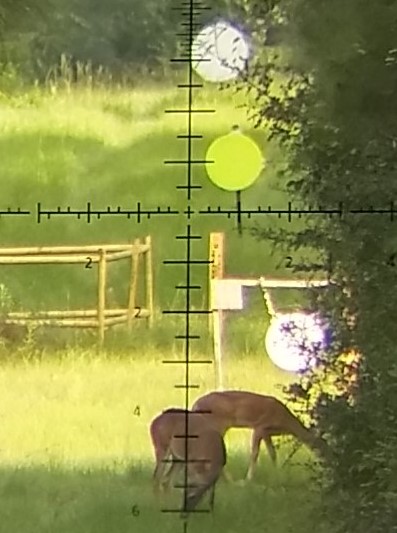

In the spirit of psinclair's enlightening and constructive post, I propose these. It was an interesting day out on my range this morning. The scope is a Steiner P4xi in mils. Three questions here:
(1) The top plate in the picture is 24 inches in diameter, less the ears. How far is it?
(2) The yellow/green plate is 500 yards. How big is it in whole inches (less the ears)?
(3) How far are the deer?
Be careful in trying to optically compare things in this pic, because things are not as they seem here.
Have fun! One "atta boy" to the winner.

1) 555 yds
2) 20"
3) I'm stumped. Reference sizes from Google get me between 550 and 620. That said, I'd guess 4-450
Top plate -667y
Green plate - 18 inches
Deer- 450-460y

1) 550yds
2)18”
3) I want to say they are almost on top of the white target. So 416yds.
Well, he said this so I took each computation individually and not as a whole pic. Frankly, I'm not sure that this picture was not a montage or a photoshop. So, I went with reticle and what I thought were target dimensions and this is what I came up with.

The image is real. I pulled up to my shooting area this morning and began getting ready to do some shooting with my iron sight gun when the deer walked out. I'm glad I also had a scope gun with me. I apologize for the limbs across the top target, as I was out of my normal shooting position when I took the picture. Also, the phone camera doesn't do it any justice. A big "thumbs up" to psinclair and the coyote in the other thread. I had no idea it would be so hard to take a cell phone pic through a rifle scope LOL!

1. 579 yards
2. 20 inches
3. The deer that is easy to mil is a fawn and substantially smaller than an adult female (1y tall at shoulder). I'm guessing that the near white target is at 400y, as it is the same mil diameter as the other 2 targets. With a 20" shoulder height I get 317 for the deer, which jibes with the targets all being behind the deer.

I’ll give it a shot..
1. 533 yards
2. 20”
3.472 yards

There is some kind of optical illusion going on with the bottom plate in the picture. I think it has to do with how the cell phone camera saw the image in the scope's eye box. As such, I'm glad I didn't include it in the puzzle. But, I'll give you this hint: it's at 400 yards. However, don't try to range it. Because of the optical illusion, you won't get the right answer. Maybe this will help with the deer.
Regarding the deer, "hlee" is correct. Neither are full-grown deer. But, the one in the front is not a fawn.
1- 555
2- 18"
Deer -424 assuming they r whitetail

556 to the top plate
18”
Hold for 40 on the deer. It’s somewhere around there.
not sure how im getting a further distance for the deer than the plate you said is at 400 unless my estimated deer size is off.
would appreciate a pm with the actual #s if it’s gonna be a while before you post the answer
The white plate and the deer are as far as this thing says they are.
The yellow plate is 1.2 mils in diameter

  • 550y
  • 20” Circle
  • 416 Yards? Hard to say. Depends on where you are at and what your average size deer is. Here in north west florida those deer would be pretty close. In Illinois they would be very far away.
OK, no more suspense. Here are the answers.
1) The target is a 24" plate at 600 yards.
2) The target is a 20" plate at 500 yards.
3) If you guessed 370 to 375 yards on the deer, you are about right. The deer were the hardest because it was hard to tell how big they were.
Good job to all who played!
