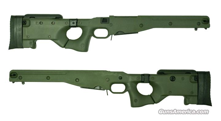

I'm looking to purchase one of the old AICS 2.0 long action stocks for a custom all-out precision rifle build. If i were to find some old skins instead, would they fit on the newer chassis'? Been having a lot of trouble finding the old chassis recently.
Yeah, the thumbhole. However the thumbhole I'm looking for is the older one, not the Viperskins version where it's swept back behind the thumbhole. I'm looking for the original AW style skins.
This is the style I'm looking for:

On each side of the skin there is plastic protruding that is supposed to connects in front of the magwell. Just had to cut it off since there is no cutout for that in the new AT frame. The hole for the trigger needs to have a little bit of the plastic removed. Also had to remove the front sling mount, though I suppose you could make a cut out for that as well. Finally if you want to access the barrel change screw a cutout must be made for that too. Very easy to do.

Seems simple but I'd prefer to keep it uncut... so I guess I should just resume searching for the original AICS then. Thanks for your help, much appreciated.
