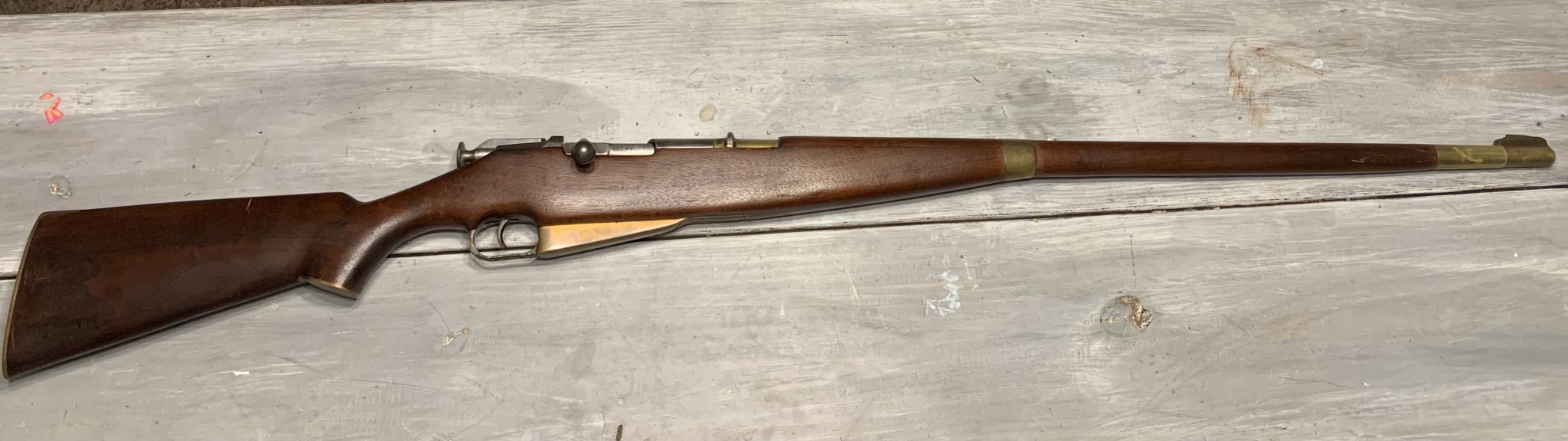

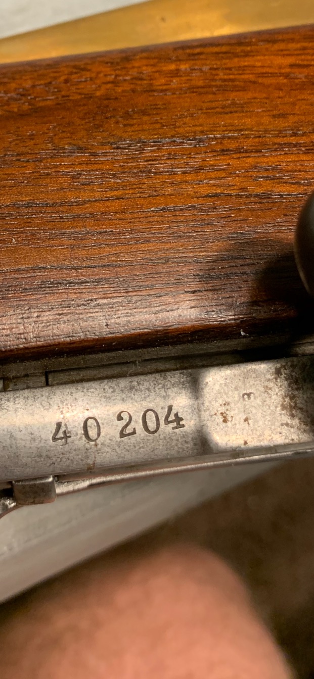

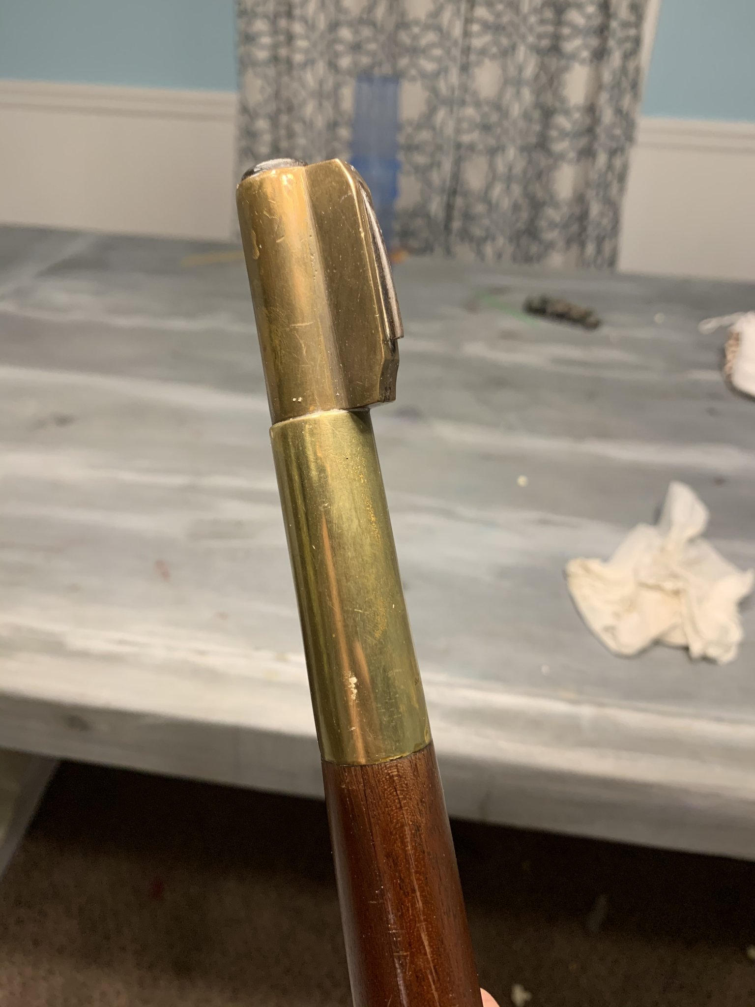

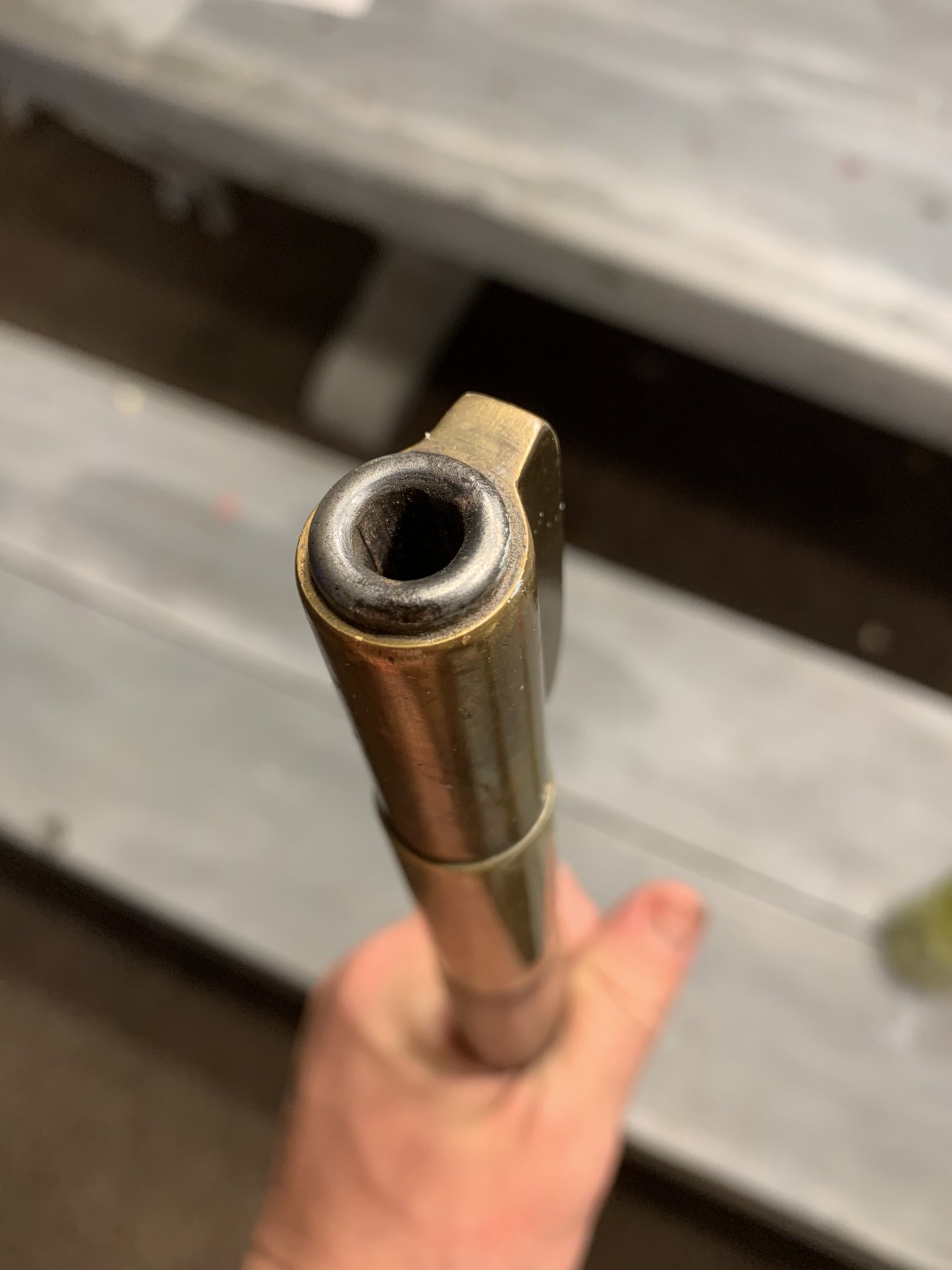

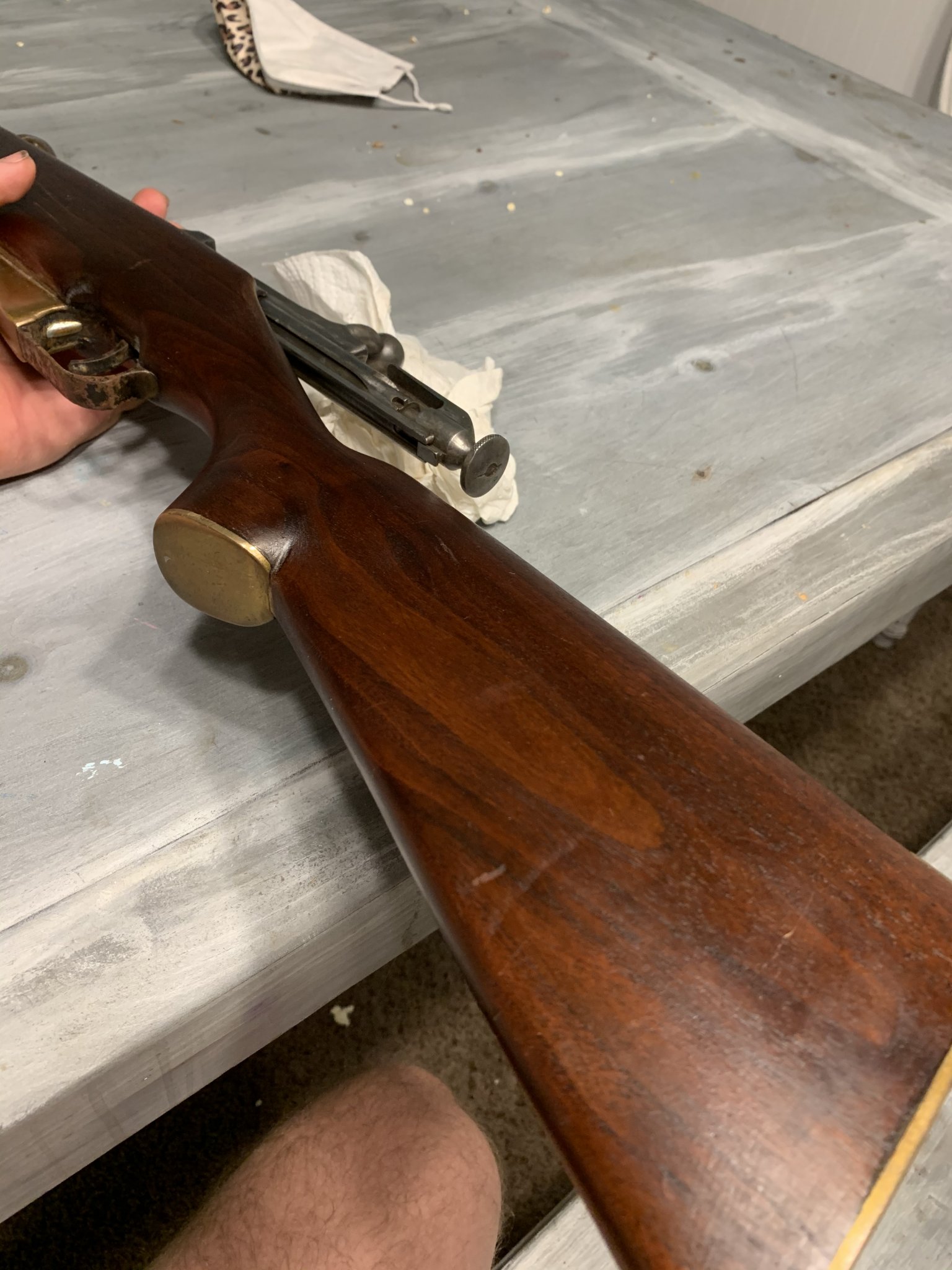

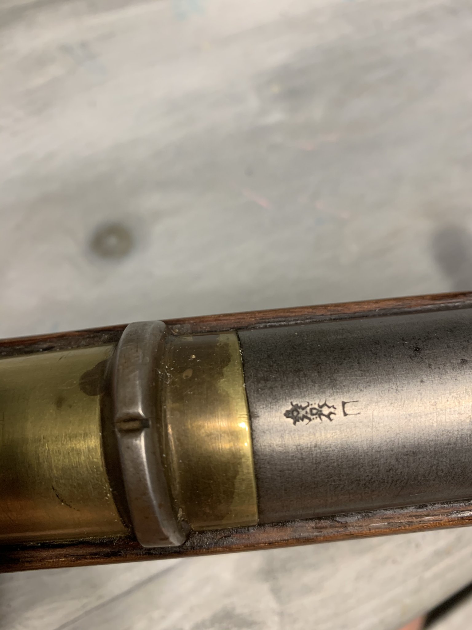

I have a lifelong friend that is wanting to trade me an old rifle for one that I have. This thing has been in his family for 4 generations.
I have looked and looked for any info on this thing and can’t find an exact match anywhere yet.
I know there is someone on here that can help me.
any help would be greatly appreciated.
My cell is (731)446-6063 if you would rather text me.
Rifle is 55.77 inches long.

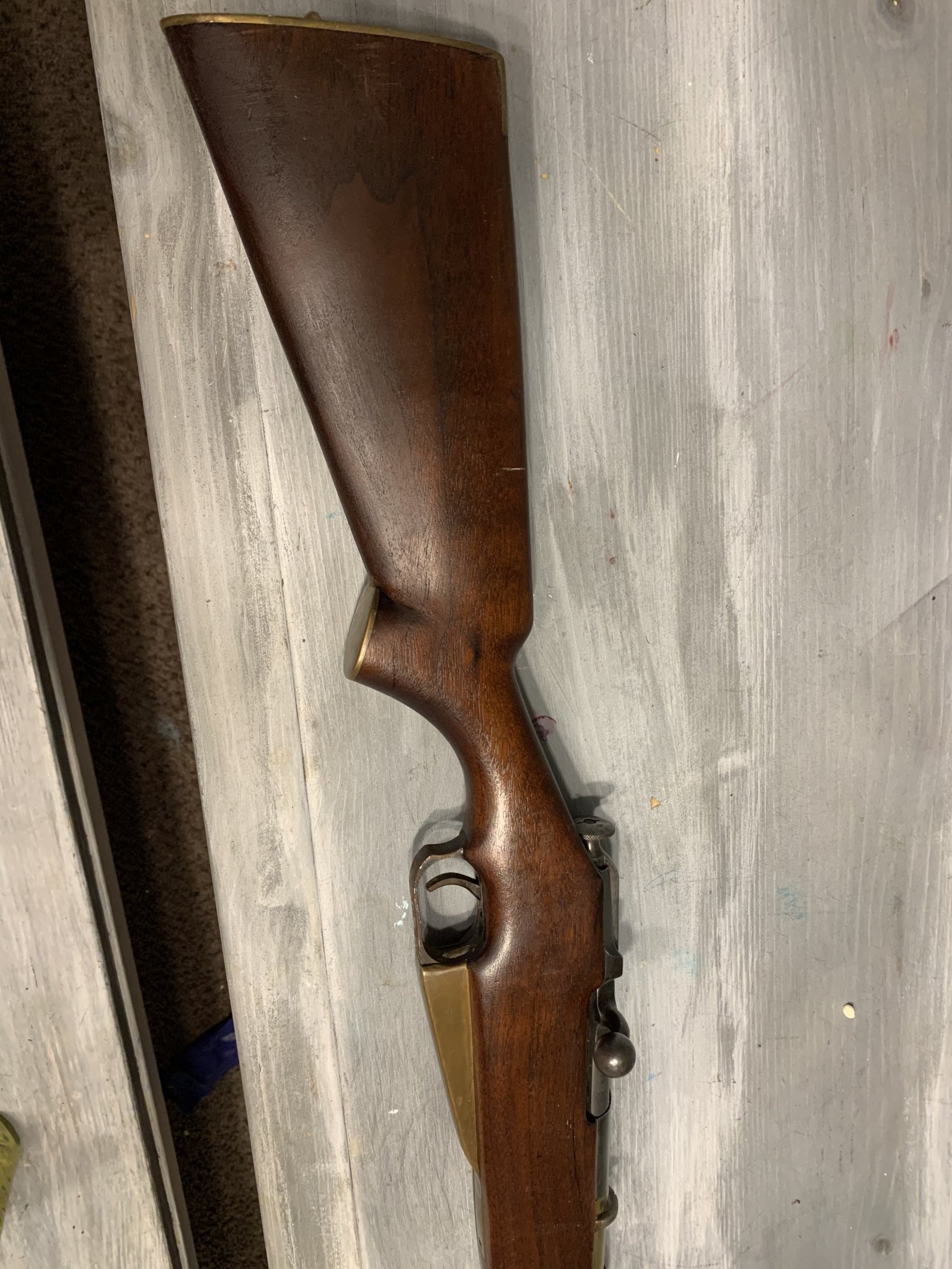

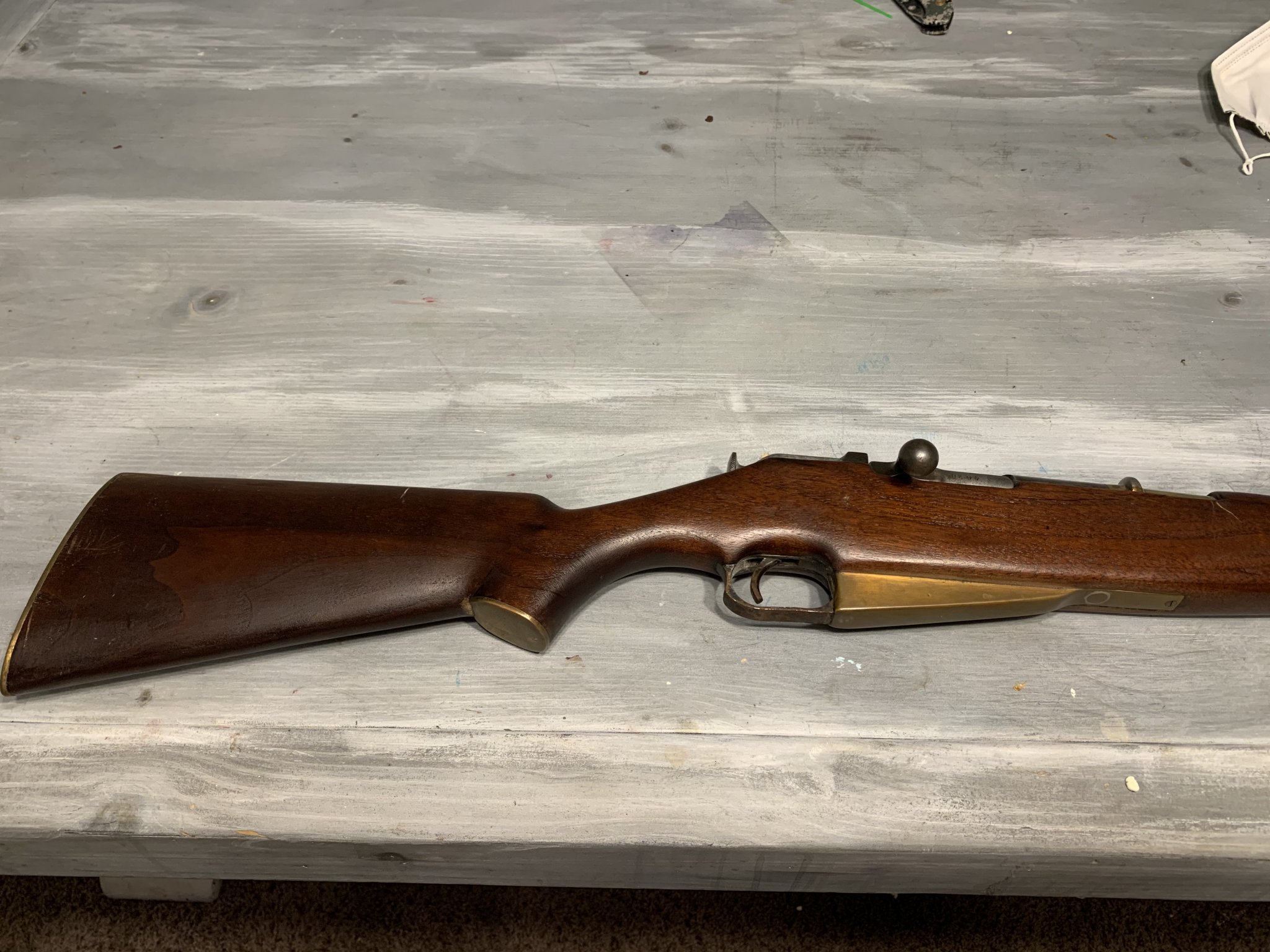

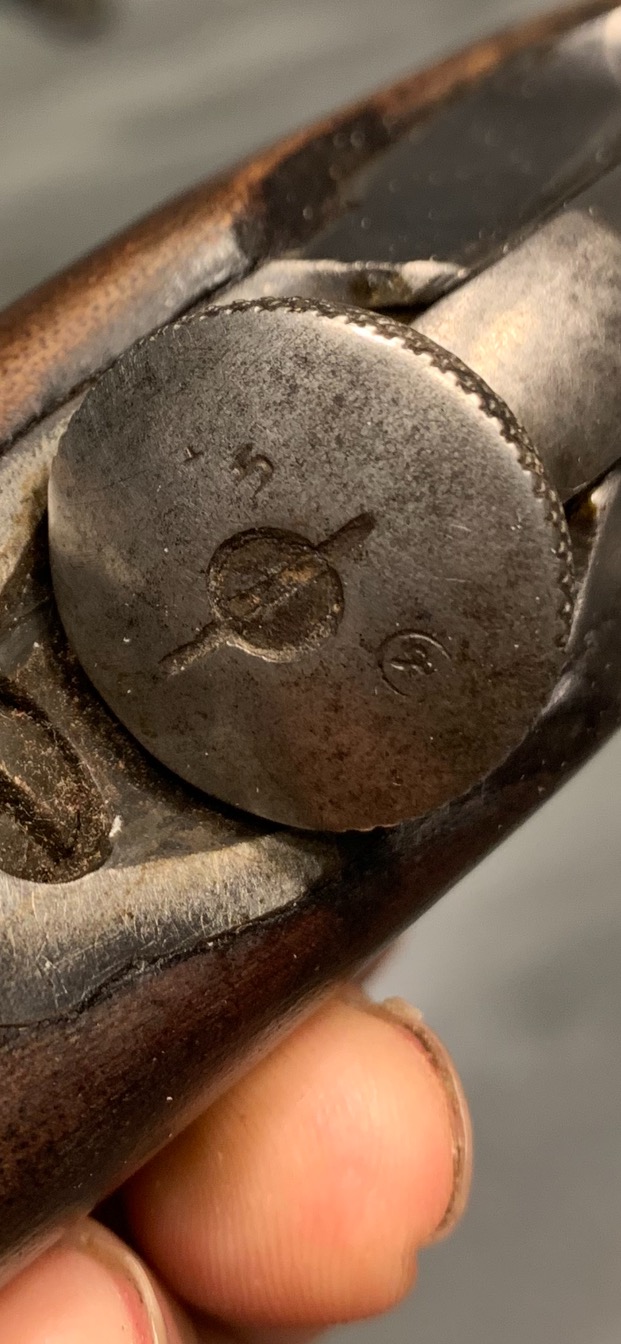

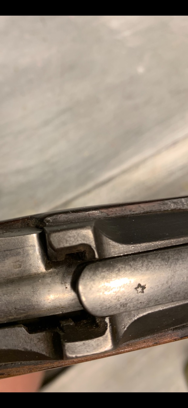

It appears to be a Mosin-Nagant receiver of some description, but it's been sporterized, as I don't know of any models with brass on them.
Are there any other receiver markings or stampings? Calibre?

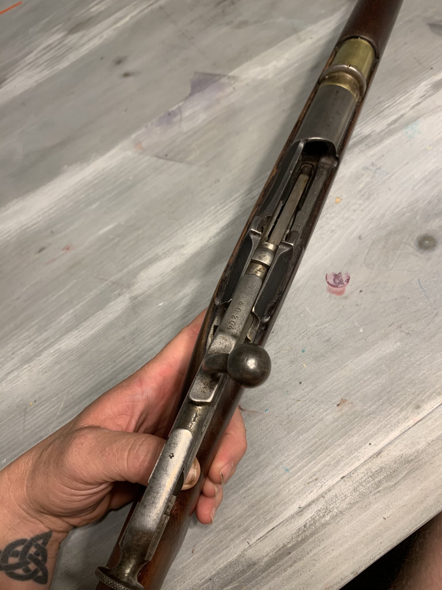

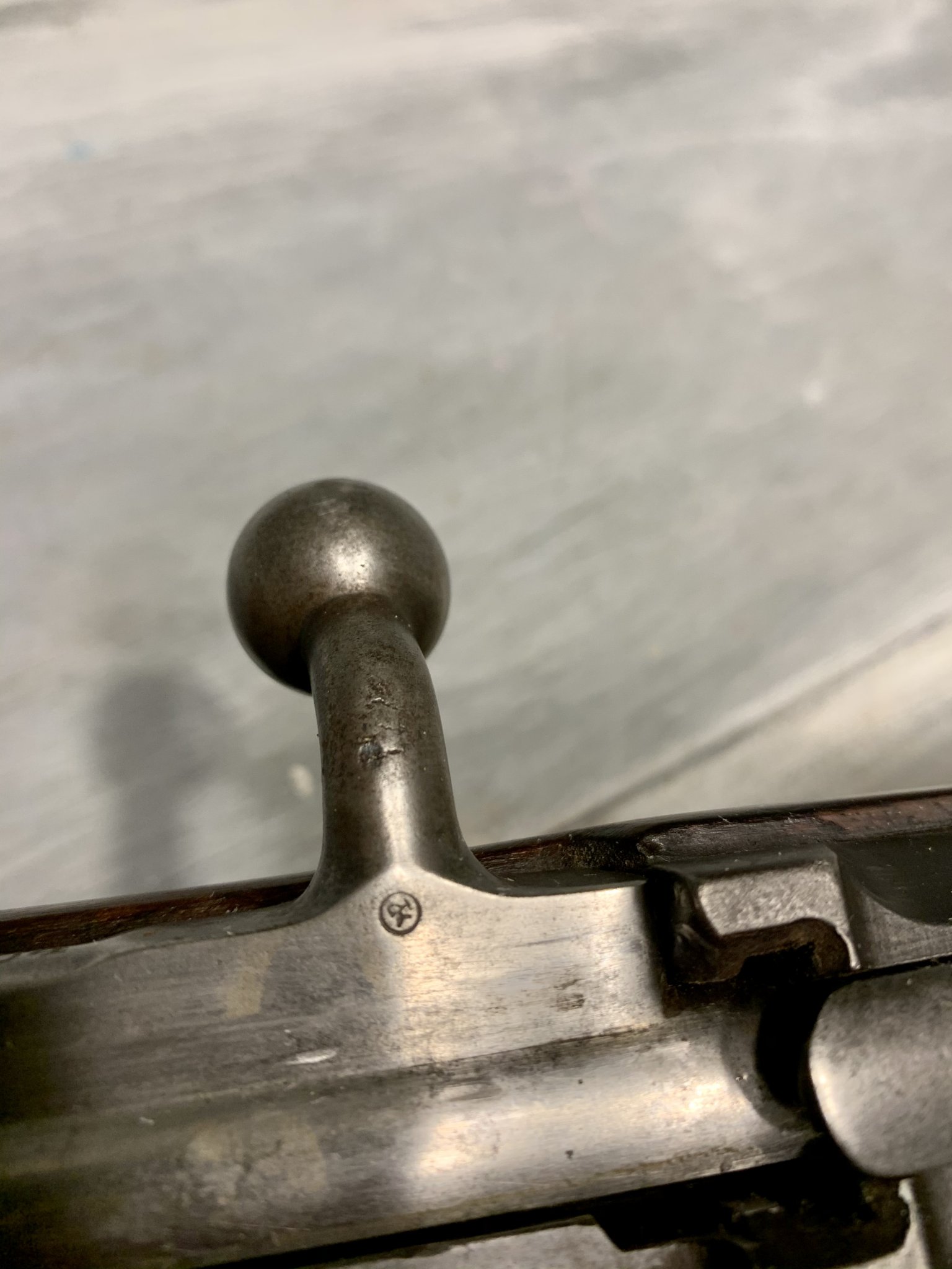

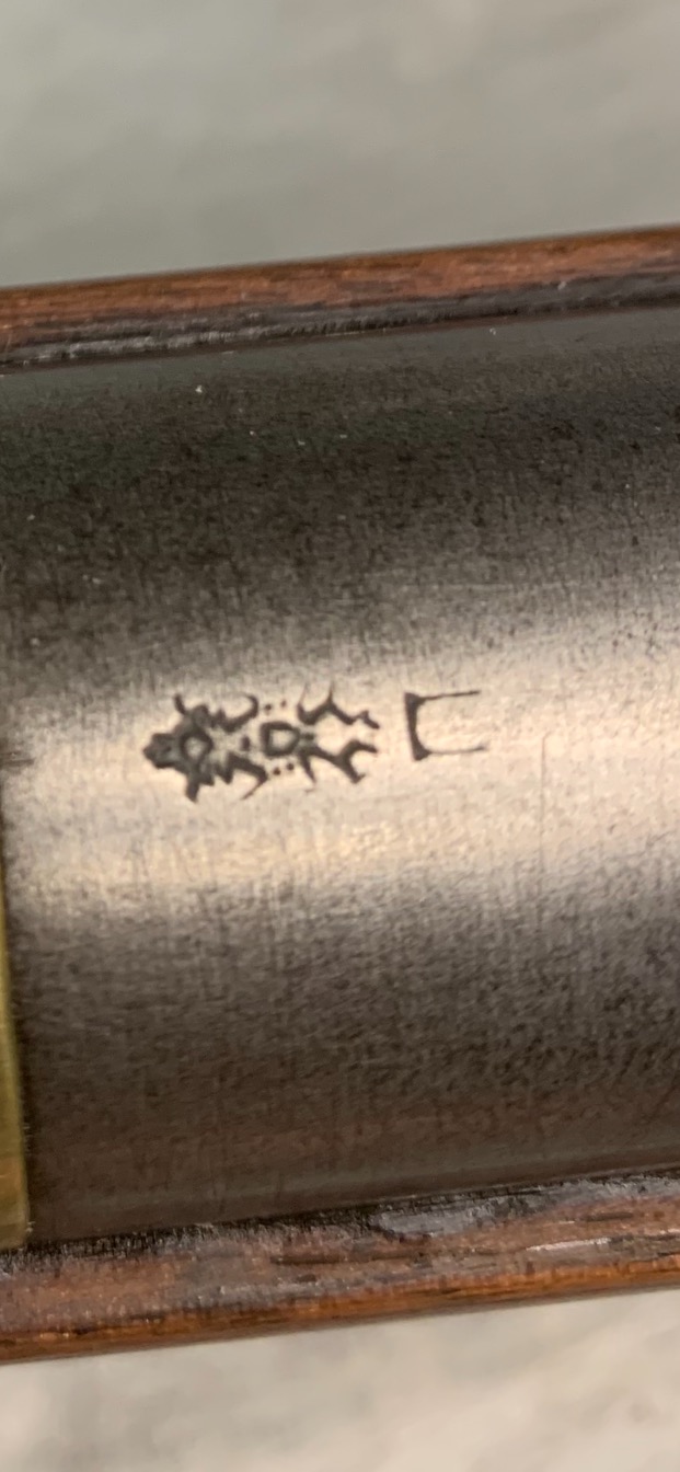

ETA: The stamp on the bolt is a russian quality control stamp, and the engraving center top of the receiver appears to be what's left of an imperial eagle. It's too worn and incomplete for me to offer more than that though, sorry. Maybe someone with more russian bolt knowledge can assist (I'm more of an AK guy)

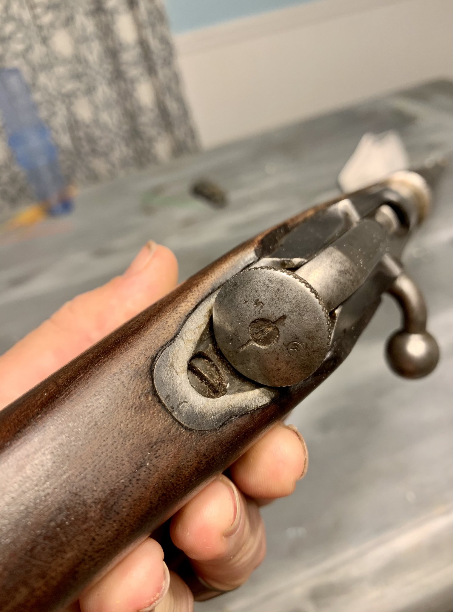

There aren’t any caliber markings. There are a few small marks on the back of the bolt. See pics

Looks like a sporterized Mosin Nagant, possibly a 91/30 model because they had longer barrels.
Looks to not be in the original stock, all bluing was removed. Looks like the manufacturer marks and serial number was removed as well. I know that's illegal to do now, but don't know about the laws whenever it was sporterized.
I'm assuming that's the original 7.62x54r barrel. It shoots a rimmed cartridge.
I would pass.

I agree - all those proof marks match a 91/30 rifle, probably 30s production, but with all the manufacturing marks removed, its impossible to tell. There should be a nitro proof and date stamp on the barrel just forward of the receiver, but that has been covered with brass and the rear sight removed.
I actually think it's pretty cool, but 1) I'd have to do a chamber cast before I shot it, just to confirm, and 2) It probably doesn't shoot well - Its missing the factory rear sight, it looks to be a non-original nose cap and front sight, and these were typically 2-4 MOA rifles from the factory. I think the factory standard -when they were testing them, and not full scale war production- was about 4 MOA.
Value is up to you - but honestly its not worth more than $80 or so. If it has history with his family, cool, but provenance has to be documented and verified before it adds value. You're buying the rifle, not the story.
