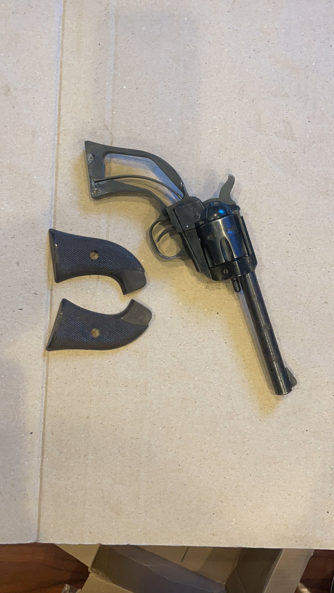

    Was cleaning out my grandparents place after they moved and found an old 22 revolver and after playing cowboy for a little bit, the grips fell apart. I think they were broke to start and glued back to the frame.
    Who does quality custom or semi custom grips? I don’t think I’ll need pearl with gold inlay but I also don’t want this to be a experiment for someone either.
    Pics below, thanks in advance!

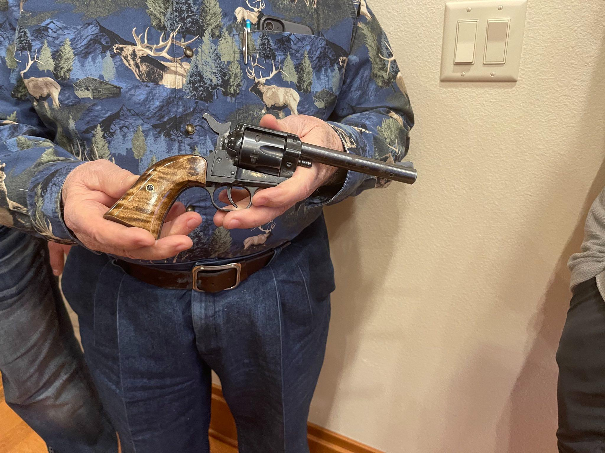

    I wasn't talking about fancy ones. lol Those would start about $400-450 and just go up depending on material.
