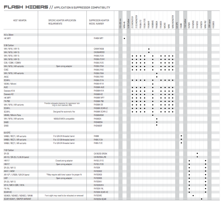

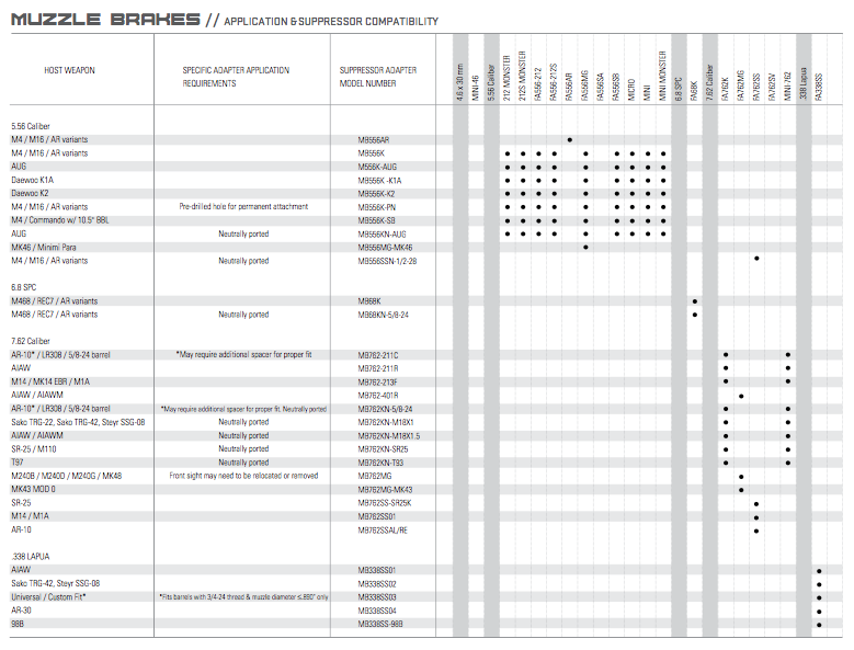

I have an old surefire 7.62k, and i was wondering if it will play nice with the 5.56 mounts from the same time period... really needs to go on the tavor... lol
I have heard this is workable, but not seeing much online. Id appreciate any help!
I have surefire mounts fh556-215a and fh556-212a, can the surefire 7.62k that normally uses mount fh7.62k03 work with the 5.56 mounts?
Screen Shot 2022-01-08 at 6.12.50 PM.pngScreen Shot 2022-01-08 at 6.12.54 PM.png
Little hard to read, but I think this should give you surefire's official answer. Straight form the surefire catalog of 2012.
Thats very helpful! Thanks a bunch!
Unfortunately it looks like a no go based on that chart if im reading it correctly.
The mounts are so freaking close... seems like itd have been a nice easy feature to incorporate and sell
