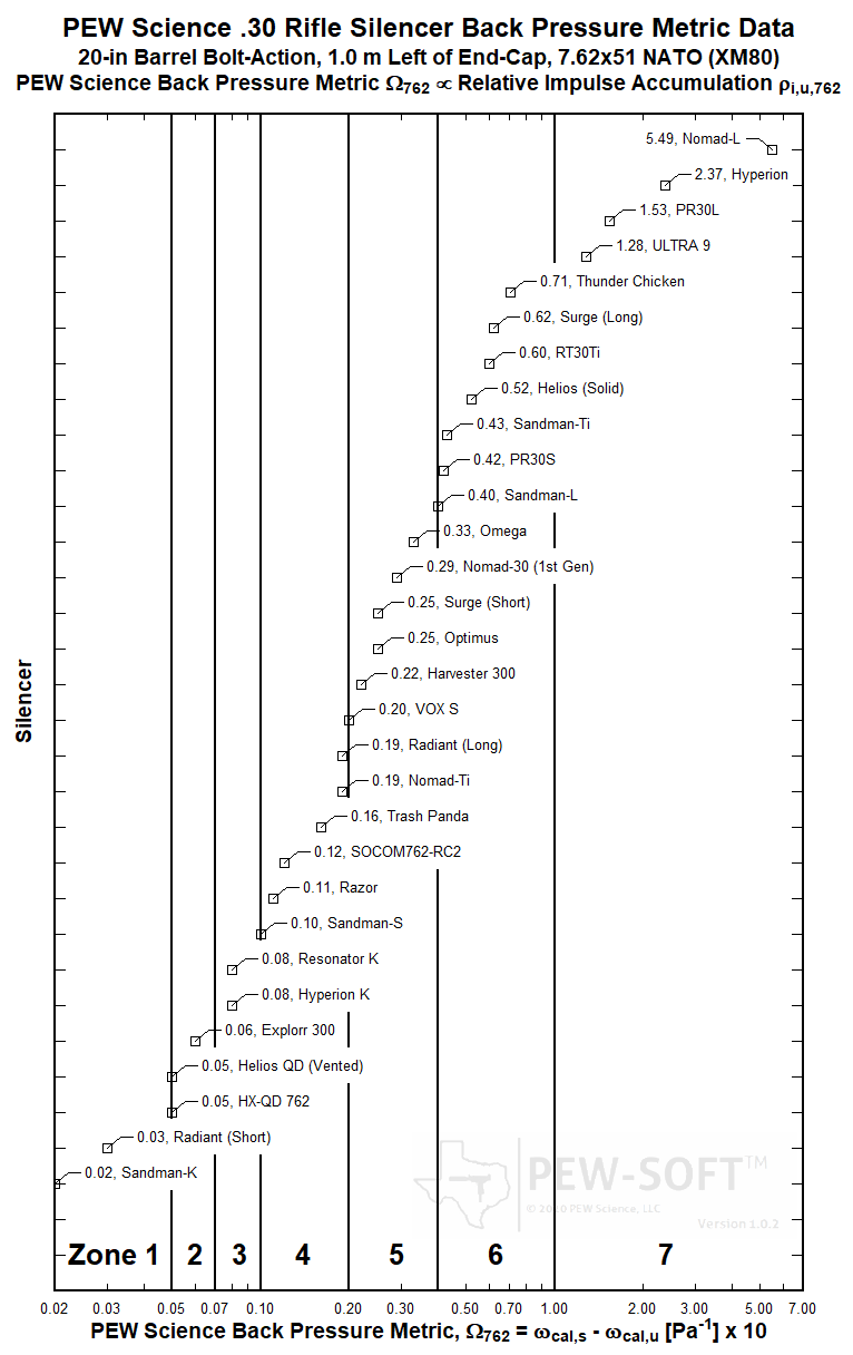

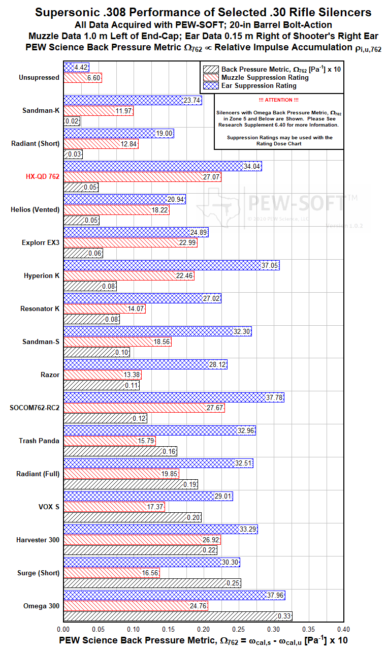

When I run an omega or kac on a number of my rifles, omega does a better job of not spitting gas into my face.
Omega isn't a low back pressure can.
From- https://pewscience.com/sound-signature-reviews-free/sss-6-41-oss-hx-qd-762-savage-308
id get a dedicated low back pressure can and a tbac ultra 7 if starting from scratch.
More back pressure data-
