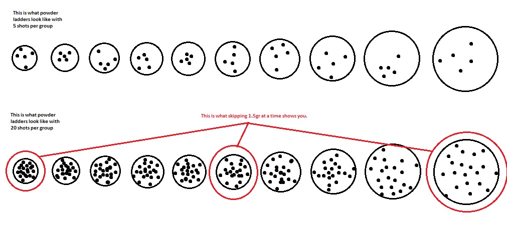

    I have shot multiple 20-50 shot samples specifically testing SR vs. LR primer pocket and Lapua vs. Peterson vs. Hornady brass and saw no meaningful difference in ES/SD, nor accuracy data across the tests. This was all virgin brass, 140 eld-M, 41.5gr H4350 weighed to .02gr. I didn't take the time to "tune" each case so take it for what it's worth, but ES/SD numbers were within 1 or 2 fps of each other. The Lapua and others are tougher in the head and handle over-normal pressures better and/or for more cycles but that was about the only difference I found.
    As a VERY loose trend, slower velocity produces lower SD. What I've seen stick out more than anything is that a given powder in a given cartridge+bullet combination tends to have very similar ES/SD data across powder charge variation. In other words, 40-42gr of H4350 always produces 8-10fps SD regardless of whether you're at 40, 40.5, 41, etc... Not saying that happens every time but that's been the trend over the few thousand rounds I've documented.
    Changing powder type has had the single biggest impact on accuracy and ES/SD in my testing. Swapping Varget vs. H4350 vs. IMR 4166 vs. RL-16 etc... produces large changes quickly. Next is changing powder charge-- specifically lowering it pretty much always produces lower dispersion. Finally seating depth seems to have an impact on dispersion but best-to-worst results in seating depth testing was ~1/2-1/3 the scale of powder charge ladder in terms of group size. Saw no real effect of seating depth on ES/SD.

    IDK how that would tell you anything, those are some HUGE jumps in charge weight... I don't even know what data one could possibly glean from that?
    Powder flavor has a lot less to do with accuracy than people make it out to IMHO. I shoot my ladders into a berm and just look at speeds in .2gr increments looking for nodes/flat-spots.
    Though, (flame-suit on), I kinda think the OCW-thing is a load of BS. It's a rorschach test; people see what they want to see. Velocity is real.
    I'm not saying it happens every time for every person.... But it's happened every time I've done 0.3gr increments and 20-50 shots per sample (5 or 6 times in 3 cartridges). So now I assume it's happening because the same trend of "more powder = more dispersion" has shown up in every cartridge and every powder I've tested so far. That 42gr charge shot a 1.2 MOA group IIRC, and by the time it was 45.0 it was 3 MOA. ETA: My point in sharing the velocity data is that combined with what I've seen for accuracy, I don't think 6.5 StaBall is a winner, nor do I think it's going to produce happy velocity spreads for the OP, regardless of how much massaging to the minutia he does.
    Bumping 0.3gr does very little more than moving your average velocity about 20fps. Big sweeps to see big changes.
    IDK. I don't want to derail the OP's thread. Let's just say I think it's probably better to shoot them right into a berm, that's just noise to me, I wouldn't want to base any of my decisions off groups shot while conducting a ladder.
