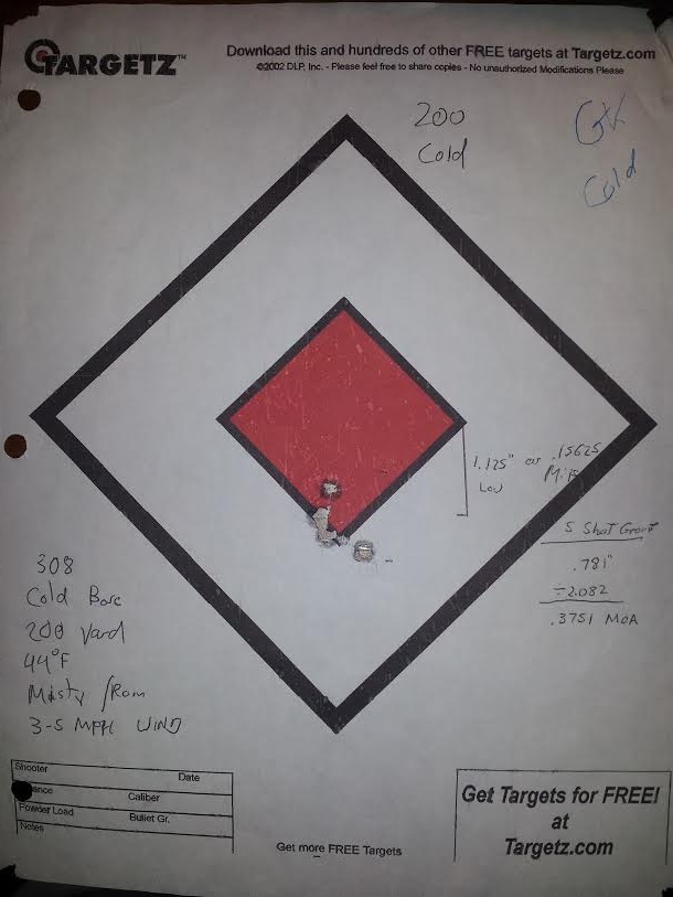

210 berger hunting vld..... do a ladder with varget and a GAP thunder ranch.
Out of a 22" barrel and titan brake, I need 11.7 mils to a 1000 yards. Subsonic? Maybe. But who the hell cares
if I can consistently hit what I'm aiming at. Performed my ladder at 200 yards and got 1/2" groups.
You asked for one bullet, not the cheapest, or most available.

I use a Sierra 180 grain Sierra Gameking.
It has perfomed extremely well in both my 30-06 and 308 build.
Cheap... plentiful... accurate...and pounds through a shoulder blade with authority, super sonic to 1000 yards. What more do you want?
