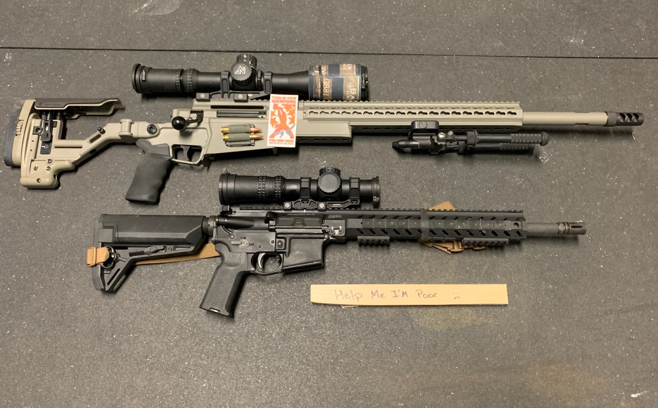

    Pics of the AXSR and LMT or we ain’t answering shit!
    Far from a poor there. I want an AXSR bad!!! Need me an AI in my life. Beautiful rigs.
