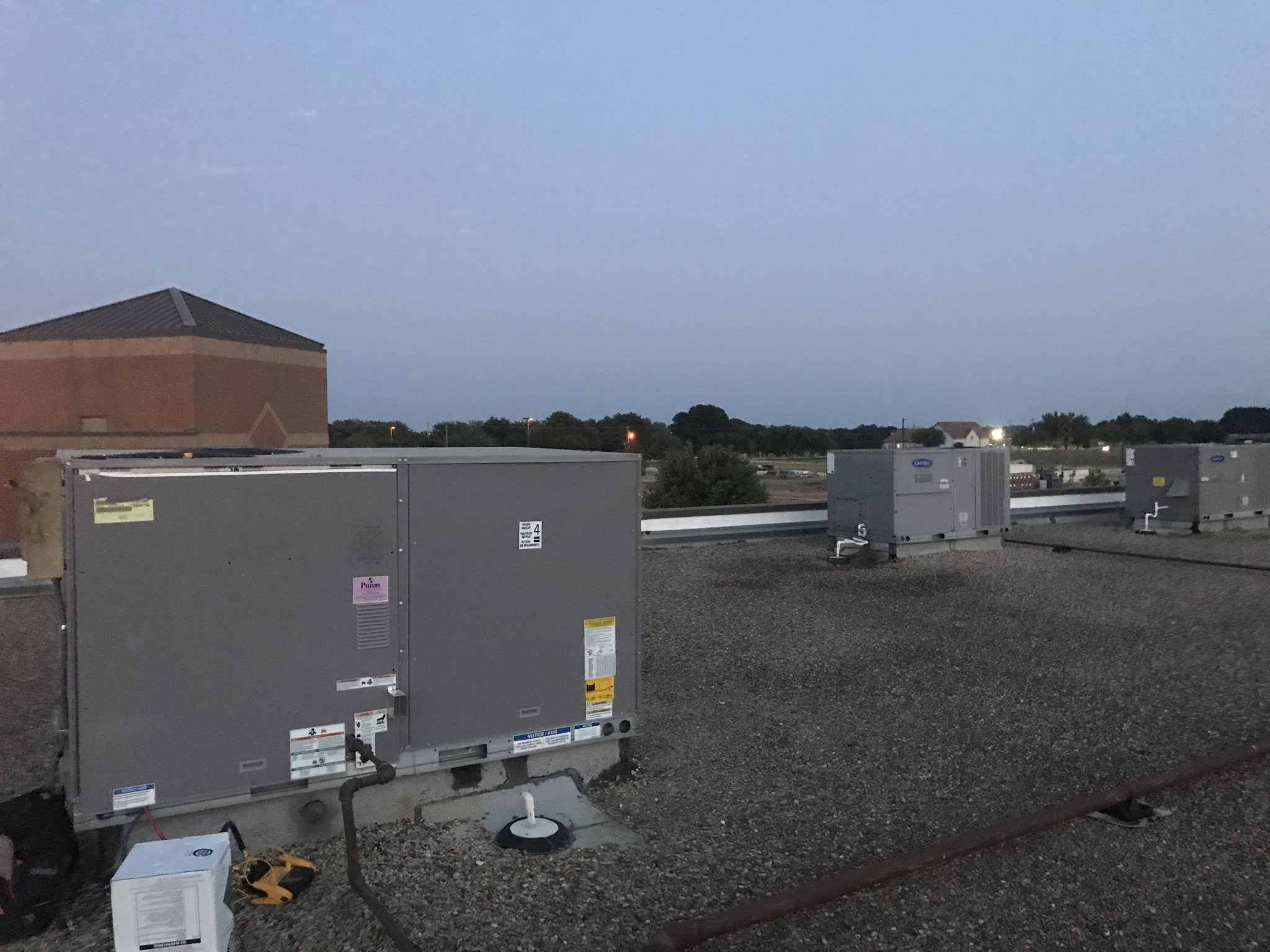

I work for a custom manufacturer and it is damn near impossible to hire techs that want to work and are able to figure anything out on their own. Even the contractors I deal with will throw their hands up and tell customers that they need the manufacturer to come out and troubleshoot because its "custom". Hard to believe that a custom air conditioner is built out of off the shelf parts and a couple of proprietary things that have in depth detailed manuals for. Reading manuals and figuring things out are just too hard.
Then you get the 20 somethings that have to be told what to do every step of the way. 20 units on the roof, you show him what to do on the first one, he does the second by himself while you go off to get the others ready, come back an hour later and hes sitting at his first solo unit. Why? Because you didn't tell him to do all of them.
