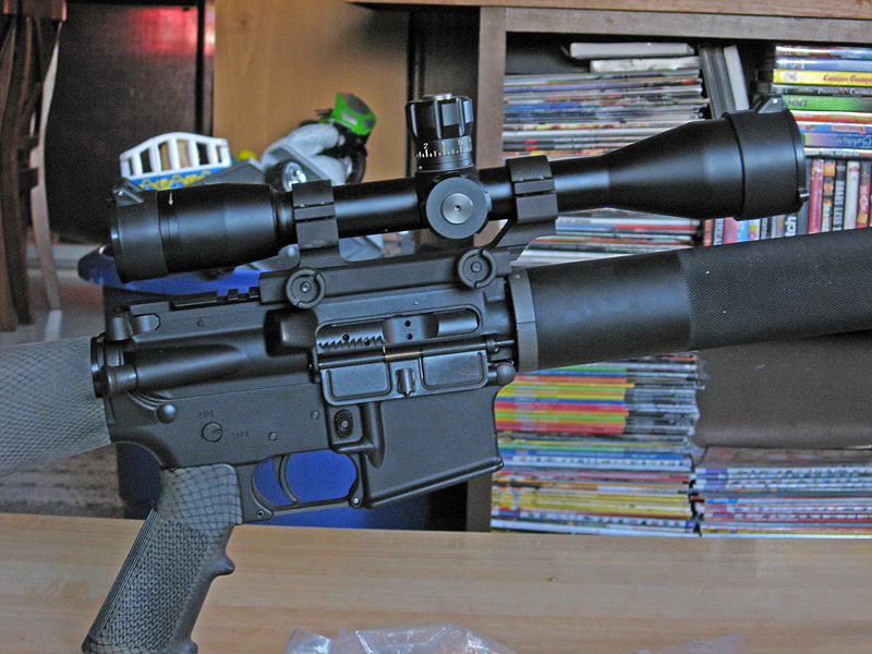

Definitely go with a one-piece mount for your AR. It is much easier to install and remove and you can ensure a perfect alignment of your scope with the upper receiver. Another plus is you don't have to be as concerned with lapping two piece rings that may not mount perfectly to a slightly out of spec upper receiver rail.
As far as one piece mounts go, while the LaRue is a great mount, the QD features are really unnecessary for a setup where the scope will stay on the gun. In addition, the QD portion of the LaRue mount may get in the way with scope adjustment as the levers stick out quite a bit. I've found this to be the case on many of my gaming ARs as well as service rifles. The LaRue QD, while detachable, is still somewhat difficult to remove by hand after being properly installed, often warranting the use of a nylon cable tie to provide enough leverage for removal.
Personally my favorite one piece AR mount is the JP Rifles one piece mount. It uses a very low profile torx screw setup on the base and a split ring like the Seekins setup which makes scope installation into the mount much easier (versus the horizontally aligned screws on the LaRue). It's cheaper too! I've also found that this setup provides a bit better removal and reinstallation return to zero although it requires the use of a tool to do so.
