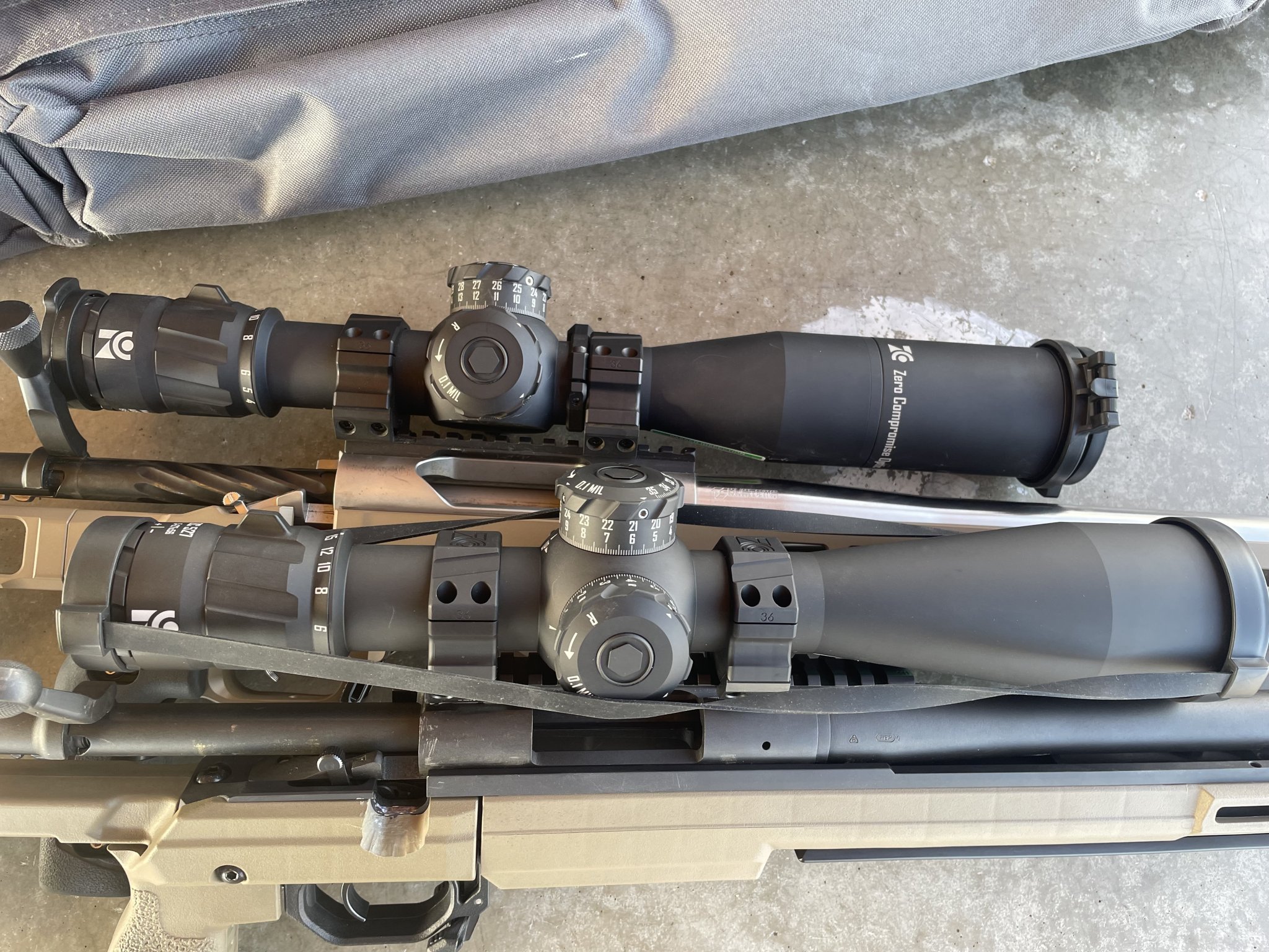

I sold two Vortex PST gen II, two rifles, two chassis and a plethora of accessories to buy my first ZC420. I bought another (used) one recently and now I'm looking to offload my Razor gen II too, and I absolutely loved that optic, aside from the weight. So trust me, you ain't crazy hahaha.

ZCOs are excellent. I have 2 and love em., but, I wouldn't swap them around, as the turrets need tiny allens and some attention to detail in resetting zero adjustments. I'm too ADHD and lazy at the same time for that re-zero process, so my ZCOs will stay put on dedicated match rifles...
That said, for swapping a good scope around on a good mount, I would suggest tool-less turrets in a solid mount like the MBRACE.
The new Razor is looking promising with tooless turrets (i hope), and there's always TT for $$$$, or the Leica PRS has some amazing tooless turrets, and I'm a real big fan of the Bushnell DMR3 turrets, which are basically capped spline easy to reset without allens.
A DMR3 or the new XRS3 in an MBACE or Spuhr would be a good dedicated easy-to-rezero matched pair for several rifles... ymmv, good luck
