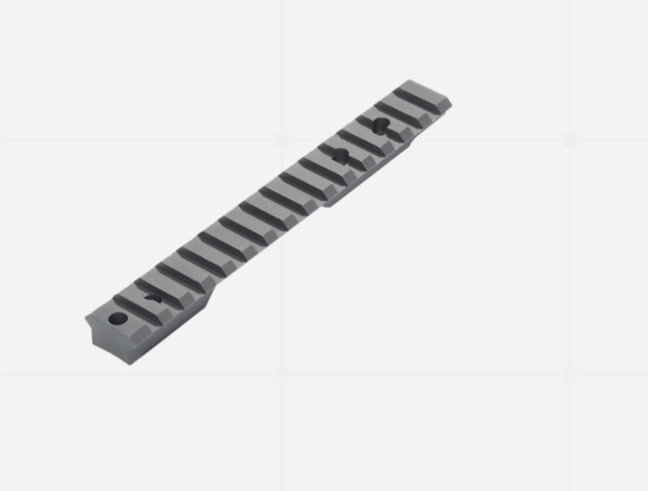

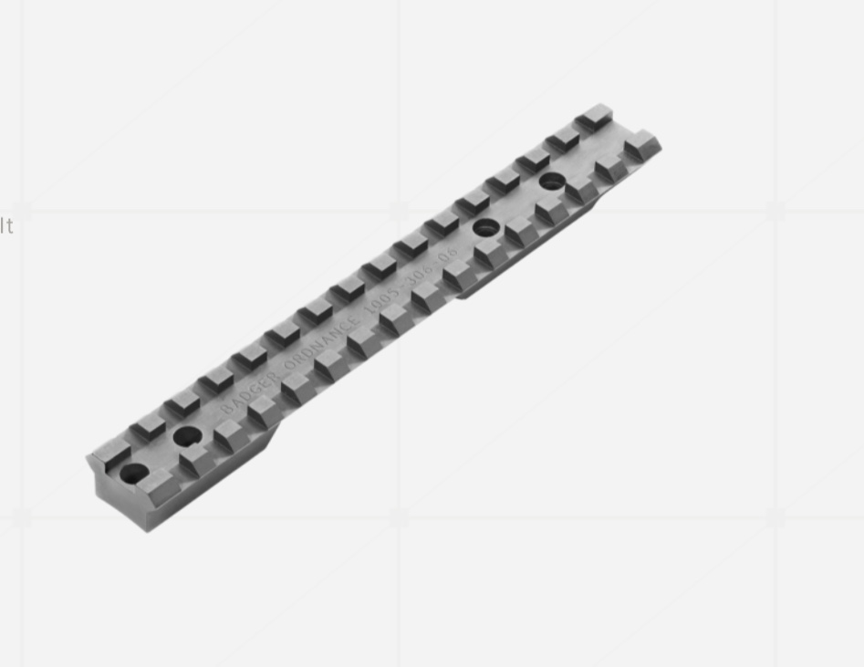

Interesting problem and thanks for posting. Did you use aluminum rings and base? Or was one component steel? Also, was the scope base full slot type like picture A, or more like picture B?

The base on the 300wn is full like A an is steel. The one on the 338LM is also steel but is the B style. The Badger rings are steel, but the Burris are aluminum. Does not seem to be any rime or reason. Only thing I can think of is a tolerance stack, with the original combo.
Whats the big difference? I just bought a EGW base like in picture B, only to find they have a higher grade 7075 AL base like in picture A thats double the price. Wondering if its worth returning and upgrading.

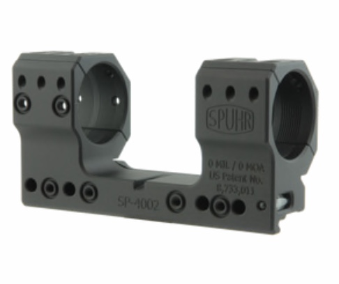

Ive always used SPUHR rings like the one pictured below, mounted on an action with a built in scope base; but recently decided to build a lighter weight backpacking rifle using different rings and a screw on base. I’m using an aluminum base made from 7075 aluminum and is type III Hardcoat anodized (similar to picture A), and attached using 8-40 Torx T10 screws. The rings are from the same manufacture/ alloy.
