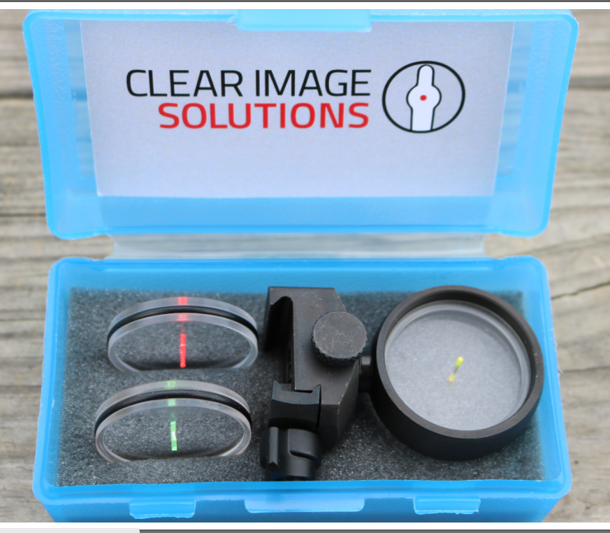

Decided to go with this front sight. This way I can have elevation adjustment and use my flip-up troy battle sight in the rear; or I can use it with a typical ar15/10 handle rear sight for even better adjustability. A second dot would be ideal for holdover without touching anything. Any way off to finish my ar10 build. If I win this match I'll post, If not you will not here a peep!

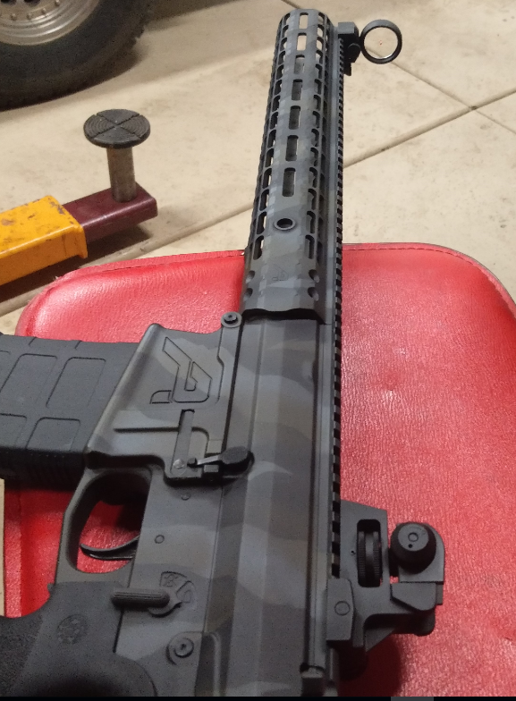

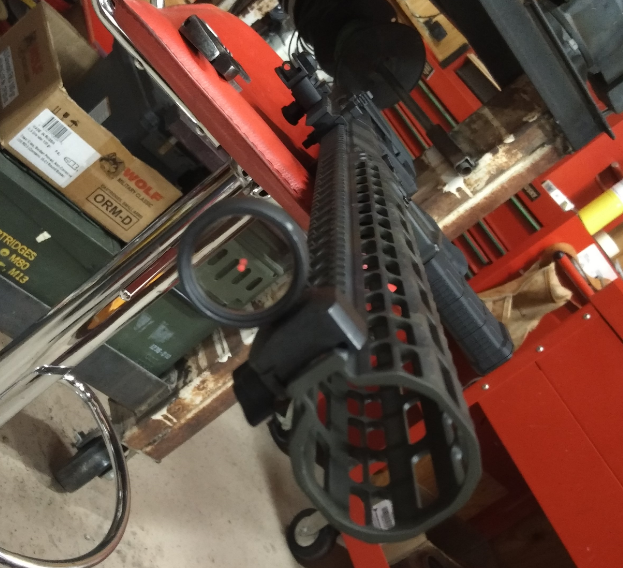

FYI. Got the front sight in today. It's fairly large and built like a tank! No worries about ever damaging it. Solid steel except of course for the insert. Put it on the gun just to see how everything lined up. Not sure if the riser under the rear sight is need but threw it on there just in case The lense on it has the medium size dot. Rest of the build parts will be here by Friday.
Had a chance to shoot out to 550 meters last weekend with this sight. With medium size red dot shown, I had a trouble getting precise aiming at that distance. Going to call them to see if they can make triangle version of an insert. I think that could really make a difference at these distances. Oh and my buddy was a no show and won by default. No one except my son noticed I had the rear sight on backwards in the pics!
