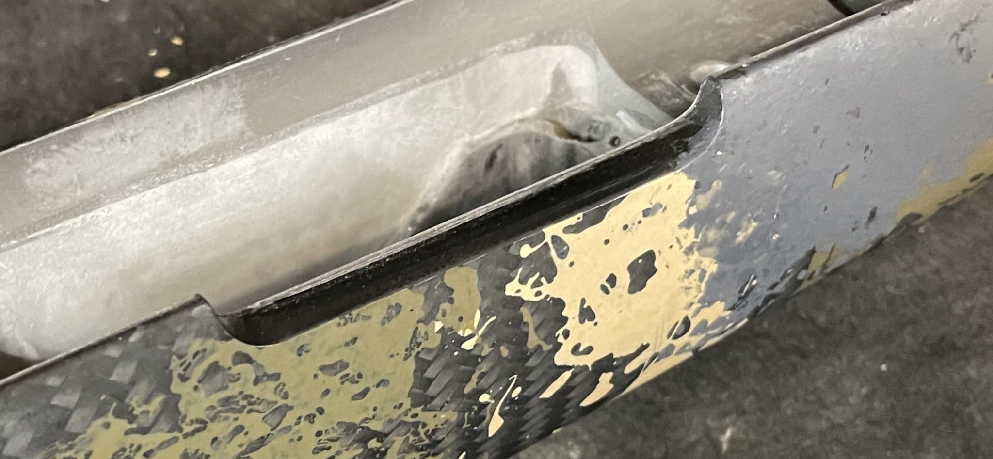

I have a manners carbon fiber stock that I purchased used. The opening for the ejection port is smaller on my stock than the port on my tl3. I have read on the hide that some people just use a file to make it match. I am assuming that this will expose the base material of the stock? What are you guys doing to cover up the base material?

I opened the port and went down the barrel channel a little on my Manners, bought it new from Altus knowing the channel was going to be close.
Another thread here said Manners uses Marine Tex, I mixed some up and basically painted the channel and let it dry for 72 hrs. When done it has a satin finish and not the flat black like the original. @bohem mentions sealing in the link I've added but he does not mention the sealer name, perhaps he will chime in.
Duracoat or air cure Cerakote. Other paints and such are typically not chemical resistant. I’ve painted, bedded and modified many stocks. A quality gun coating will better serve you in the long run.
I opened this one. Painted with Duracoat and added a different sponge color too.
