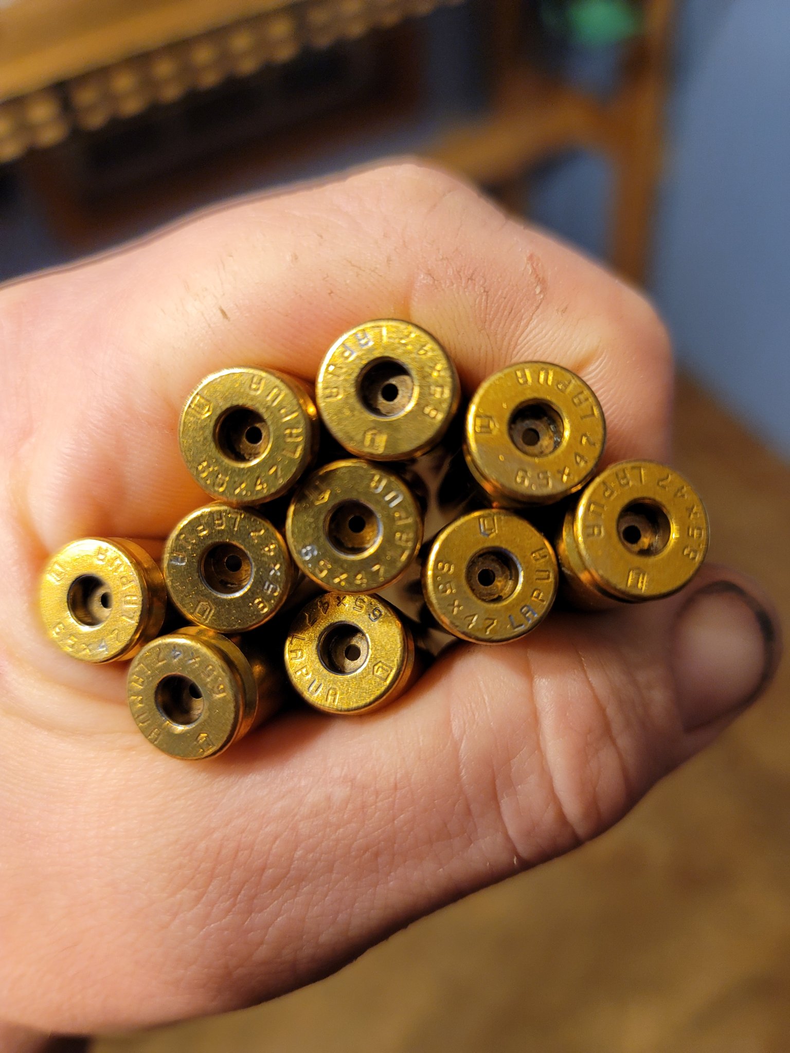

    Post a picture of the 140 HB brass if you could. I agree on backing that way off. Especially if your not going for long distance records lol. No need to kill your barrel for an extra FPS. If you want speed, try 130’s.

    I just remember this. When I measure the case head I'm getting about 1 thousand expansion on 8 out of ten cases and about 1.5 thousands expansion on 2 out of ten cases

    Disregard the colors on the head of the cases, thats from marking my brass with a blue sharpie. I grabbed a handful of brass, but they all look this way

    Entering those numbers, generic across the board, you are about 5K over pressure. IMO, Lapua 6.5x47 brass hides pressure signs better than any brass I have fired. Though I am sure their 308 Palma brass does the same well also.
    I will not tell you what to do concerning your load, unless all your shots have been fired in cooler weather, you may get some surprises once it warms up.
