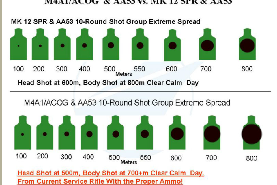

FYI, my go to rifles are a Rifle length LMT MRP 16” cl mid gas barreled carbine and a LMT MWS. You can’t buy either for under 1k. My MRP has a H1 buffer, same as the 6920. The MWS has an H3. If I’m not mistakenSR-15’s with intermediate gas ship with an H buffer as well.
Feed a free floated 6920 good ammo and it’ll exceed the capabilities of most shooters.
While it’s a 20” A2 upper, 6/10 hits at 1k yards with mk262 and 3/10 with M855 with iron sights, standard handgaurd and a sling shows the capability. http://looserounds.com/2013/06/10/a...rack-grade-ar15-and-m855-make-1000-yard-hits/

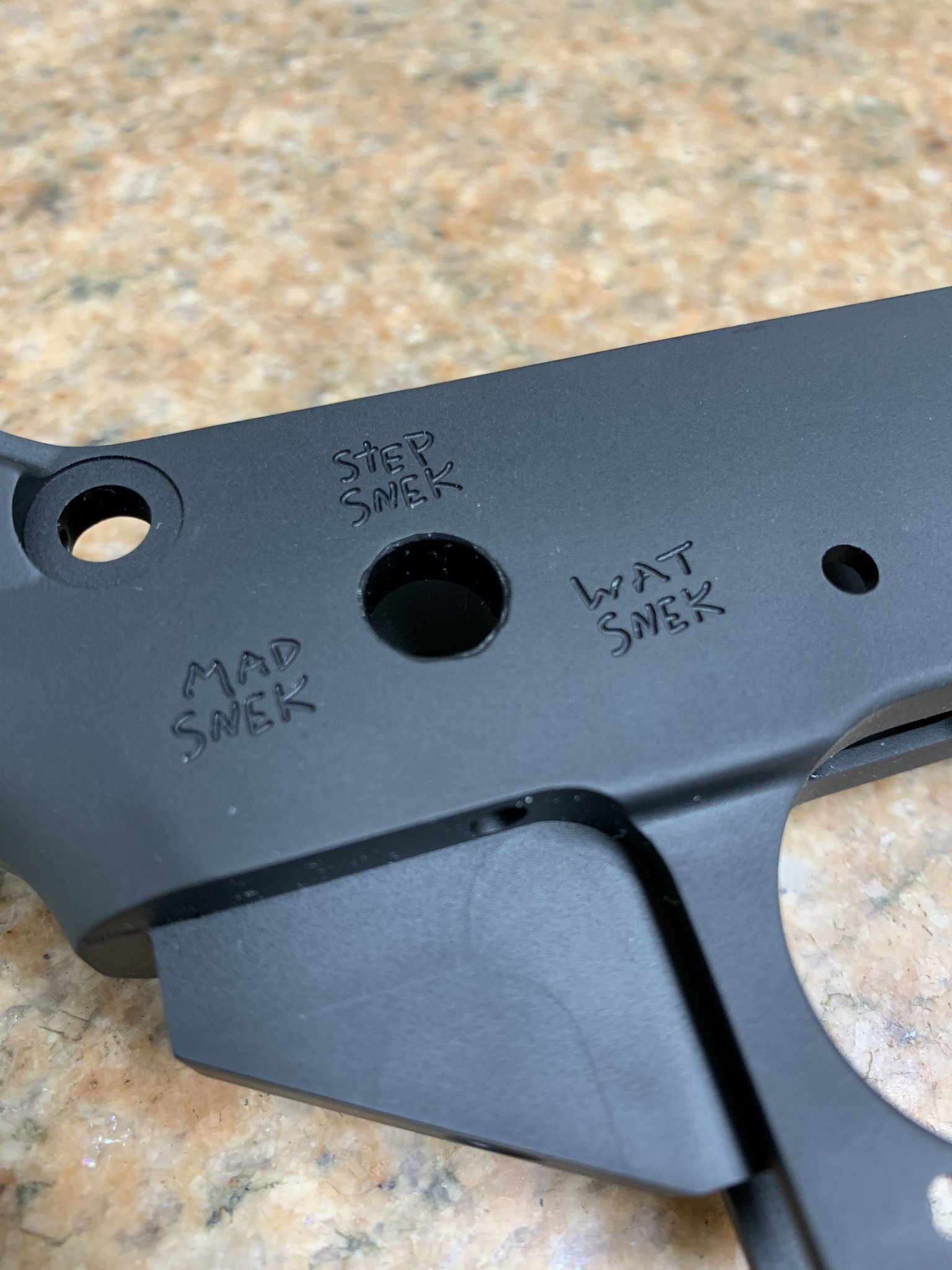

So I bought a nicer lower recently. Paid 2X what Anderson’s go for. I wanted the roll mark. The pictures are what I got. I was told they would NOT take it back because I had transferred it. But they would offer me 10% back ($6). I still haven’t gotten the $6.
The lower is perfectly serviceable. But I paid a premium over “outa spec nightmare parts” and got a lower with odvious machining process issues.

You paid a "premium" for a PSA lower? Because you wanted the rollmark? A witty rollmark doesn't make a PSA a LMT. Nobody is going to take you seriously when you spew stupid shit like that.

I paid “A PREMIUM” over poverty ponies. I never claimed PSA was “premium”. If I ever do, shoot me.
