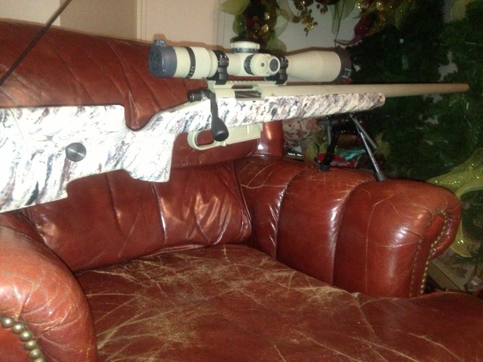

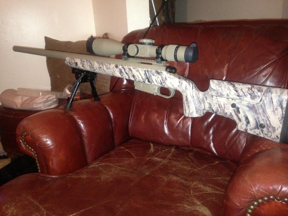

A while back I took an action off a worn out Rem 700 SPS Tac .223. I ordered a PT&G spiral fluted bolt .308 bolt face and took to one of my custom rifle builders (Dixie Precision Rifles/DPR). I spec'd out a .22-250 build using the following:
Rem 700 action
PT&G Fluted Bolt
Badger bolt knob
Brux 1-8" twist MTU 26" barrel
DPR Recoil Lug
McMillan A5A stock
Surgeon bottom metal/DBM
Jewel HVR trigger
Badger USMC 6/4 rings
Badger rail
USO 3.2-17x44 GEN II XR
I had the rifle chambered to shoot the 80gr AMAX and damn does it shoot them. MV 3287, roughly 7.0 mils to 1,000. Now, this rifle is not as fast as some on this thread but I have shot some amazing groups at 1,000 with it. Although I have not tried the 90gr Bergers yet due to an 8 twist barrel, when this barrel burns out I have a Chanlynn 1-7" twist to replace it.

jtrax , try the 90's as my Middlestead was set up for the 80's with a 1 in 7.7 Krieger and the 90's work so well i'd never go back to the 80g !

FWIW, my donor was originally a 300RSAUM. Got a one pc. .473" bolt from PT&G, and #3 Krieger 1:7.7" tube...done!
I wouldn't recommend a Seven action if you want to run a fast twist w/ 80gr+ boolits. Just not enough room in the magbox of a Seven to run them efficiently. 75s or less, and the boolits won't infringe too much on case capacity.
In my Seven, the 75s still shoot plenty flat @ 3500 with no pressure. Can get to 950yds on the 1st turn of the Premier LT (6mils/turn), and the scoped rifle weighs barely 9lbs. Give & take...
