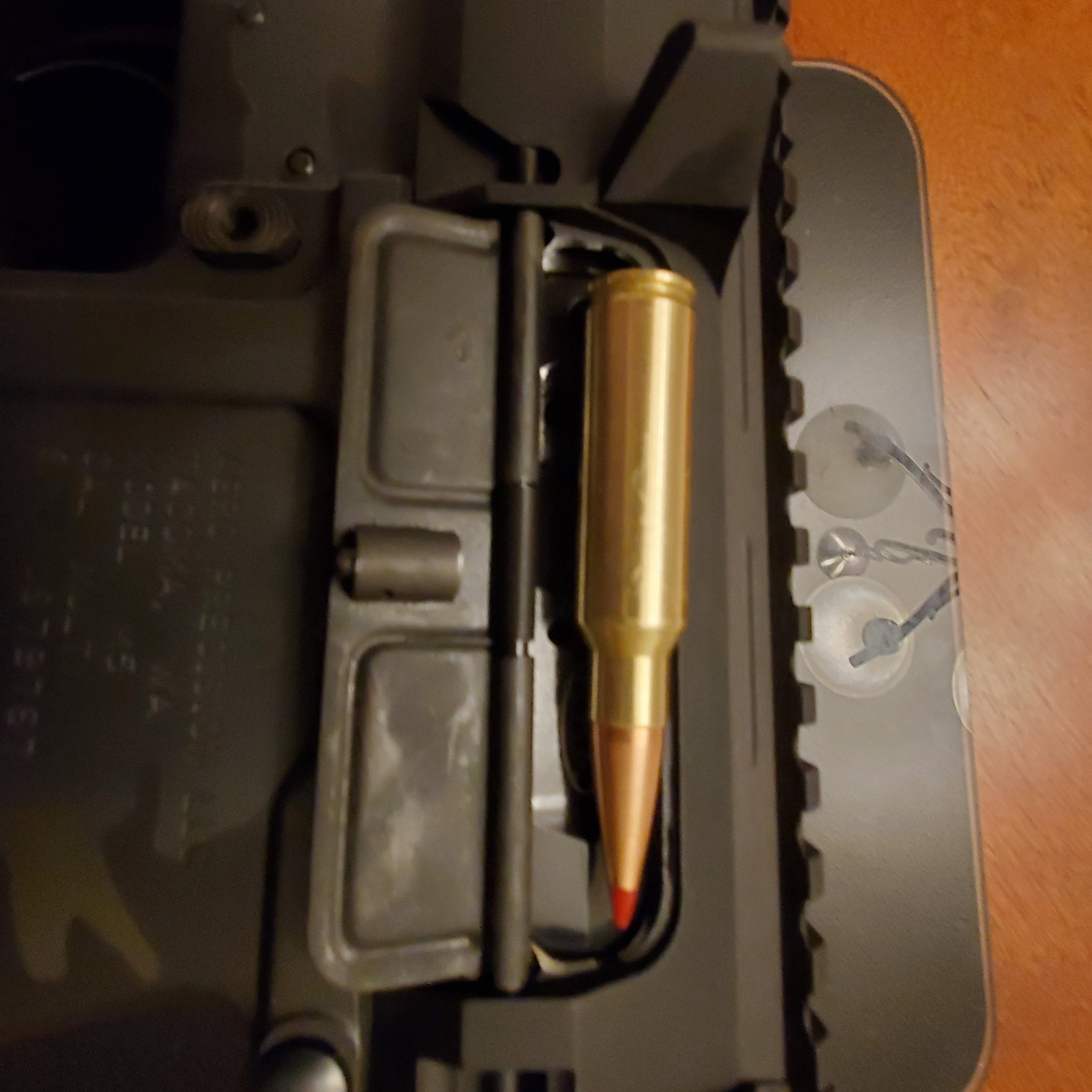

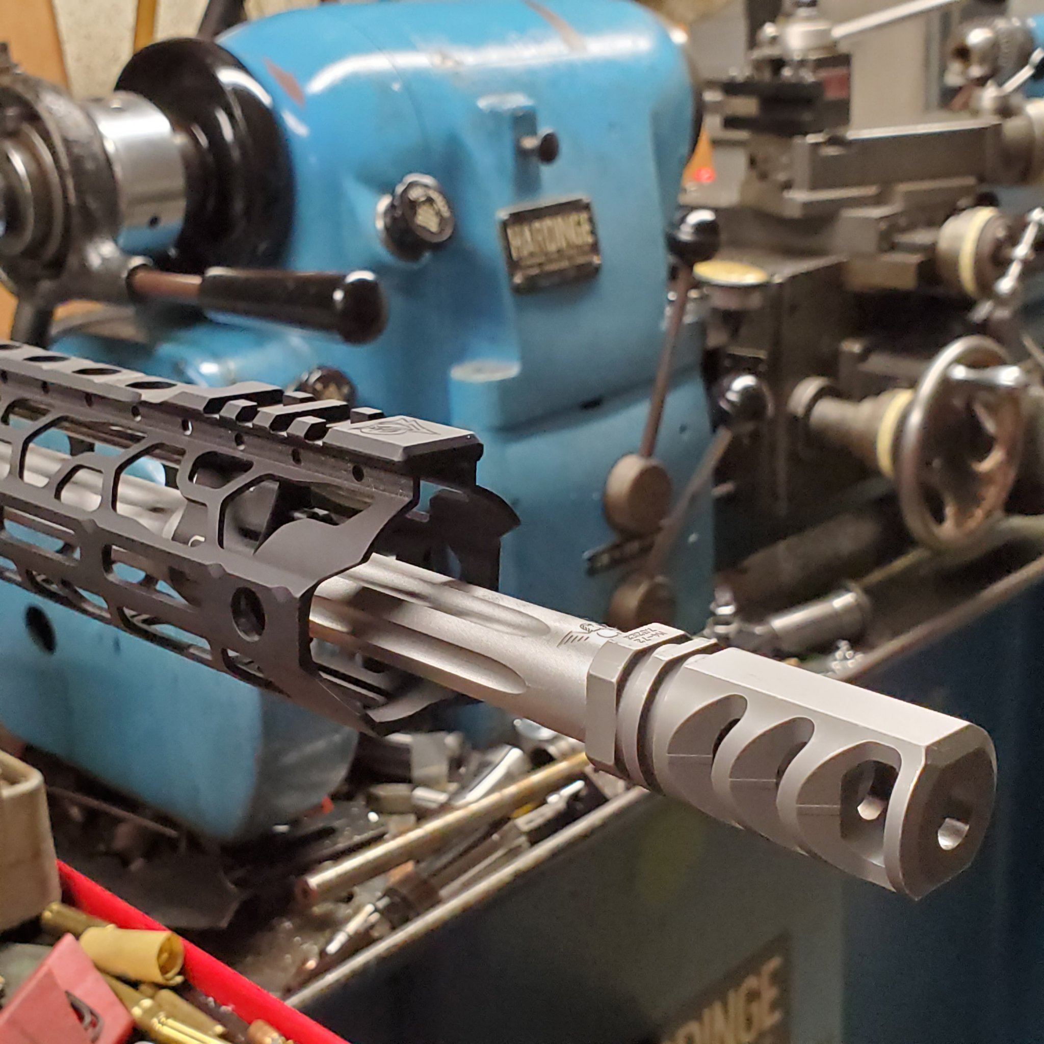

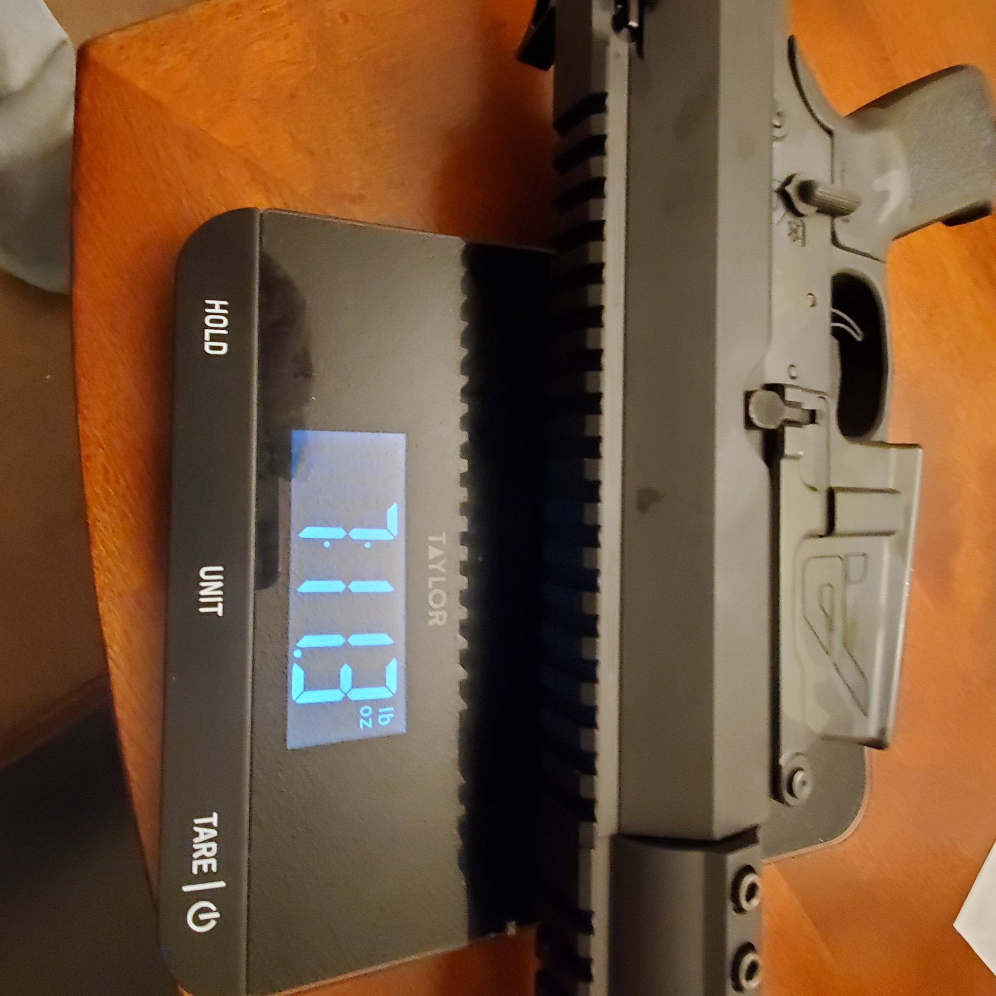

AR 10 in 338 RCM?...I is just been finished mine.
7 lbs 11 oz fluted 18" barrel, with a serious muzzle brake, without optics.
Brass made from 6.5 PRC.
