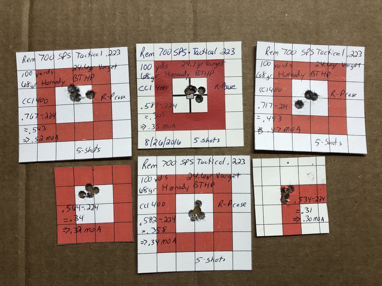

I have a 20" factory 700 SPS Tactical in .223. It is/was one of the most surprising purchases I've ever made (and I realize that I got lucky for once).
It averaged .502 MOA for a 5x5 aggregate on the old Sniper's Hide targets with the 69gr SMK over Re-15, and threw a ton of .4s with the 68gr Hornady over Varget. I originally had it in a McM A5, which got sold due to a divorce. It sits in a H-S Precision that's fully adjustable now because I used it as a trainer for my wife and M-I-L.
Unfortunately, the accuracy started falling off with the occasional flier. I thought maybe I had developed a flaw in my reloading process, but a check with a borescope showed heavy pitting in the last 14" of that barrel. Somehow something must have got in there, yet none of my other rifles had any corrosion issues. Maybe my in laws did something wierd with it when they had the rifle in their possession from 2014 to 2018.
Either way, I'm going to sink the money to get it trued up and rebarreled. While I'm at it, I'm going to ditch the H-S stock for a KRG Bravo (didn't exist back then). If I didn't already have the action, I'd definitely start with an Origin though.
My 7 year old daughter shot it last summer when she was 6 (it'll still put 4 of 5 into 3/4 minute...then the flier). Watching her smile after she smacked my aiming dot on steel at 160 yards was awesome.
I will always have a .223 trainer in the safe.

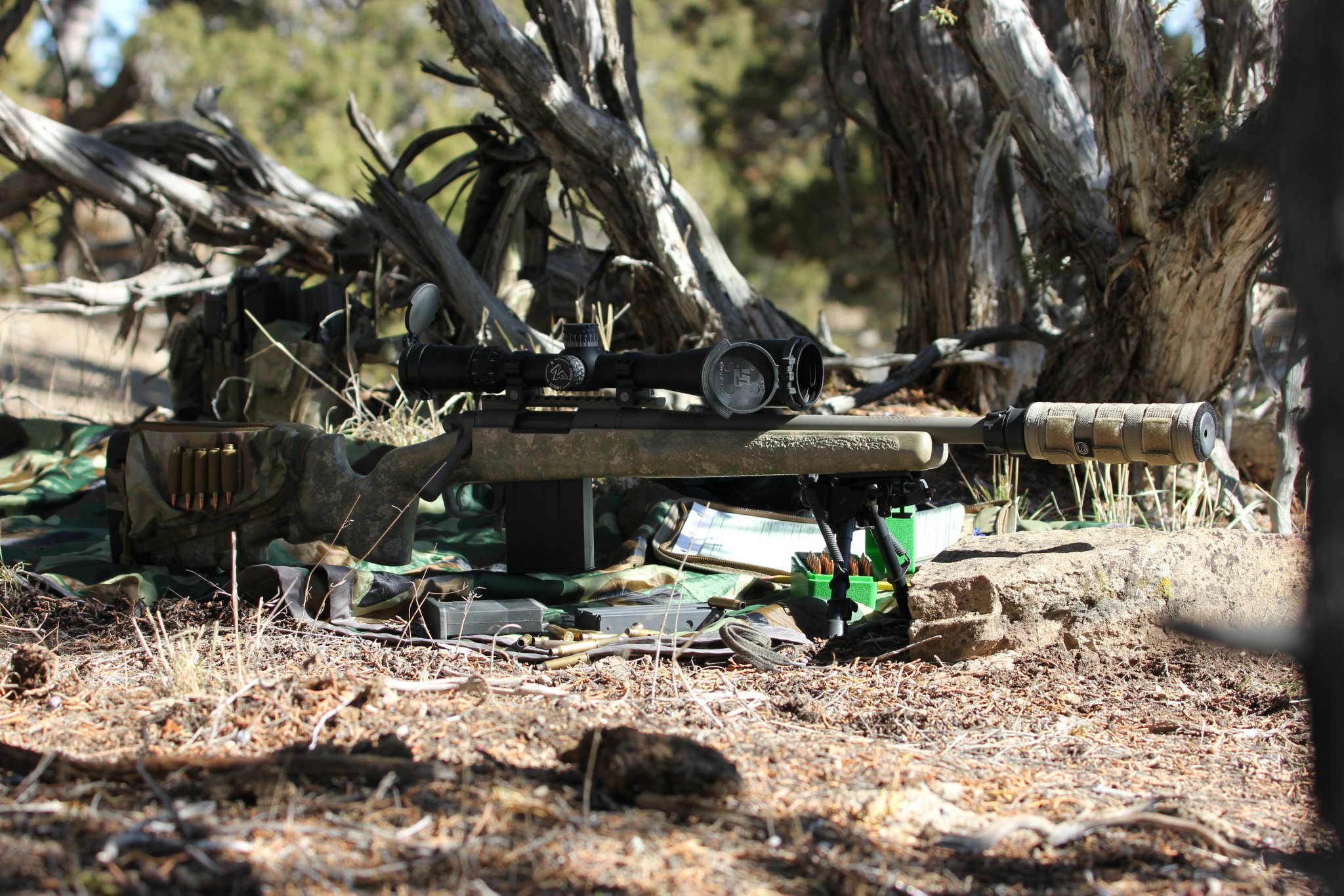

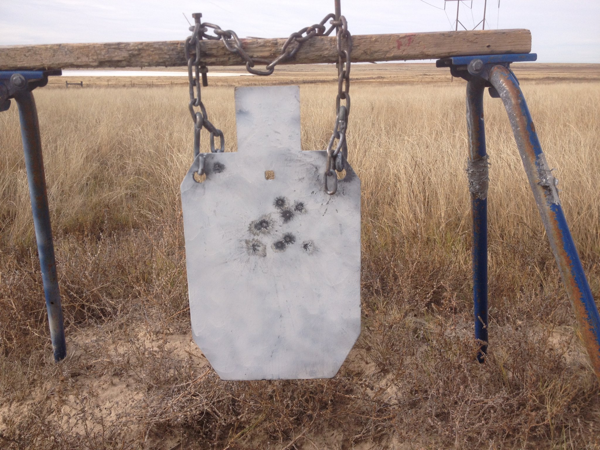

My XCR long range has been a hammer for over 5k rounds. I finally gave up on shooting it out, and pulled the barrel for a 28" 1 in 7 twist I had in the safe. I got tired of being stuck with a 1 in 9, although I mostly shot 53 and 55 v-max out of it. I shot the 77 SMK well also.
The pictured target was 420y off the shooting sticks from a high kneel.
Its crazy to look back at pictures and think how many different scopes that rifle has had on it. I think the first scope i had on it was a burris XTR 3-12, or an SWFA 10x.

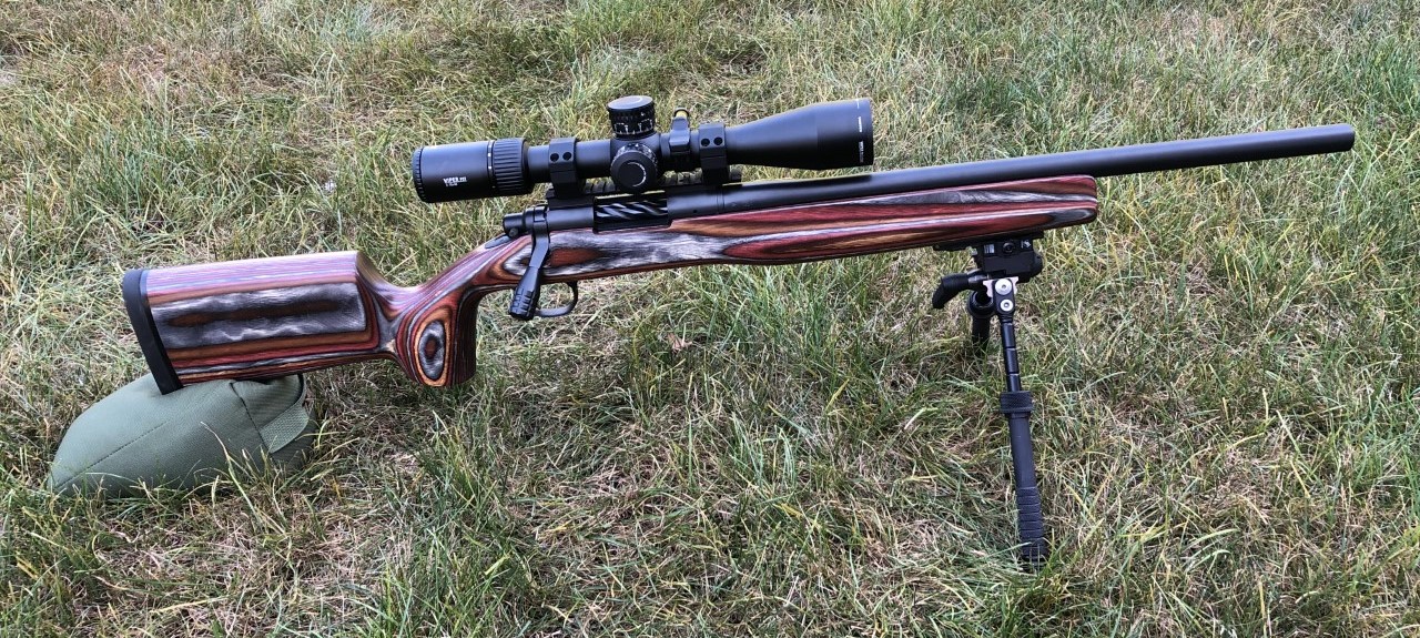

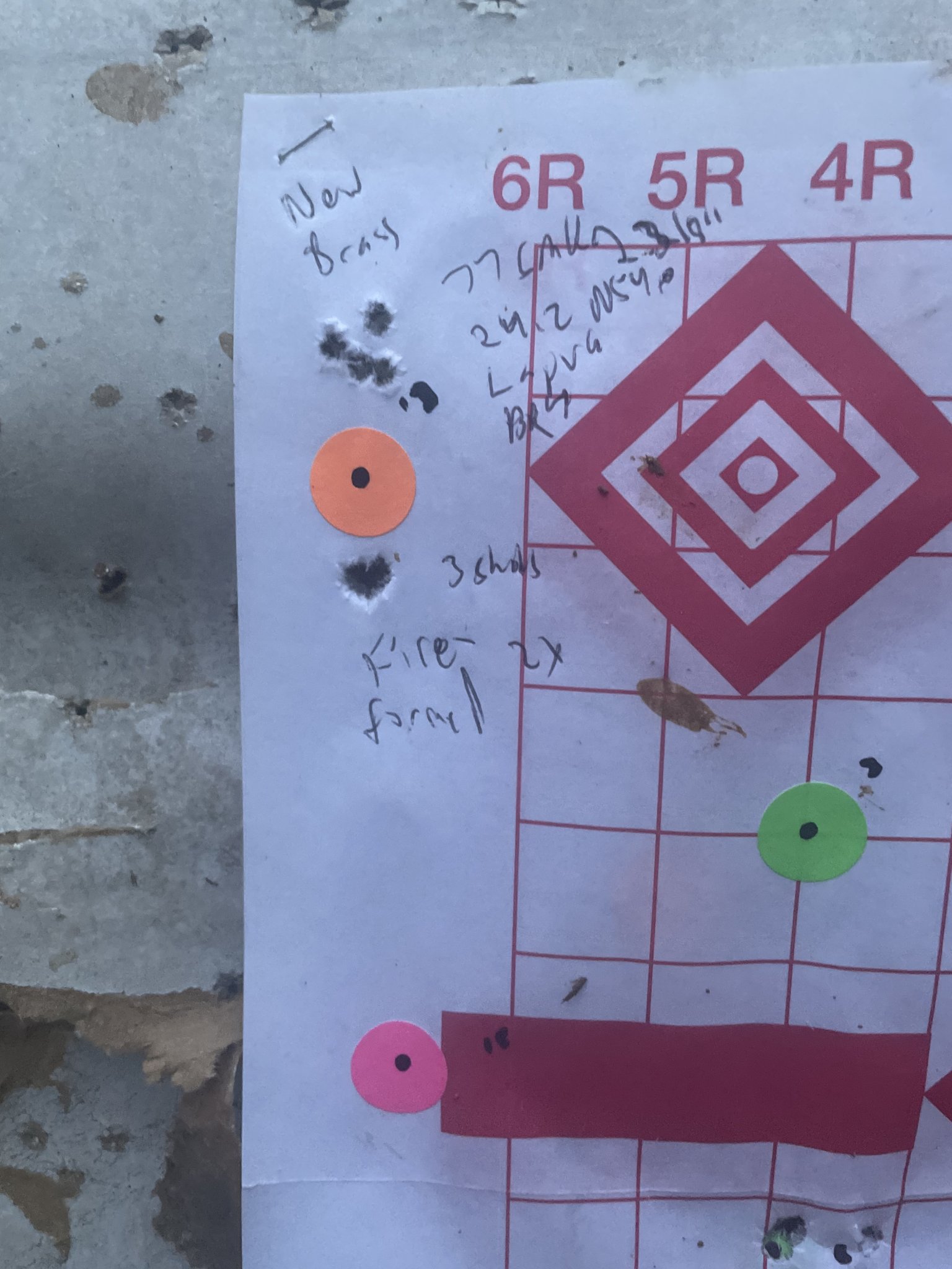

BONE STOCK HOWA MINI 1500 action with a dose of N540 and a 77 grain matching. I only bought this one because I couldn’t find the LTR version in Remington 700 but man am I happy with this. Put a NX8 and a SAS arbiter on it and my 10 year old loves it. So does the old man. Lol.
