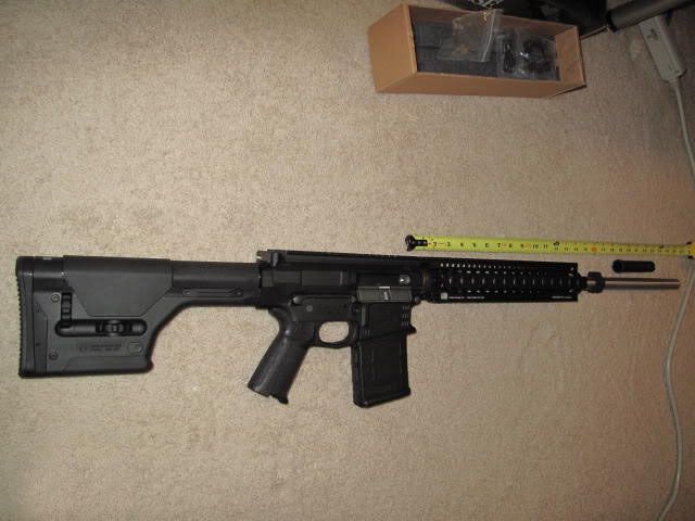

Well, here she is, almost have all the parts. Just trigger and BCG left hopefully by weeks end, then off to a smith.
So here is the question, what length barrel ?
A surefire brake is going to be added.
IRA Upper and Lower
Magpul MIAD Grip
Magpul PRS Stock
Daniel Defense Rail
Rock 1:11 5R barrel blank AR10-T contour
DPMS barrel extension
PRI Gas Buster Charging handle
PRI low pro gas block
Surefire brake
Pmags
DPMS LPK and ejector port cover
The blingy chrome phosphate carrier and bolt
One thing I will point out, the take down spring in the rear is located vertical, not horizontal like AR15s towards the butstock. So the grip needs two captured holes, not just one. With the MIAD grip, you have to cut the miad wedge (not to be confused with wedge block -red thing) lower portion to fill a gap, else the spring is allowed to relax and take down pin moves freely. The IRA has to be the tightest fitting lower/upper I have ever had, and requires a little fitting, sanding of the take down pins also.
At this point, I am thinking 20 since the Surefire will add about an inch.
