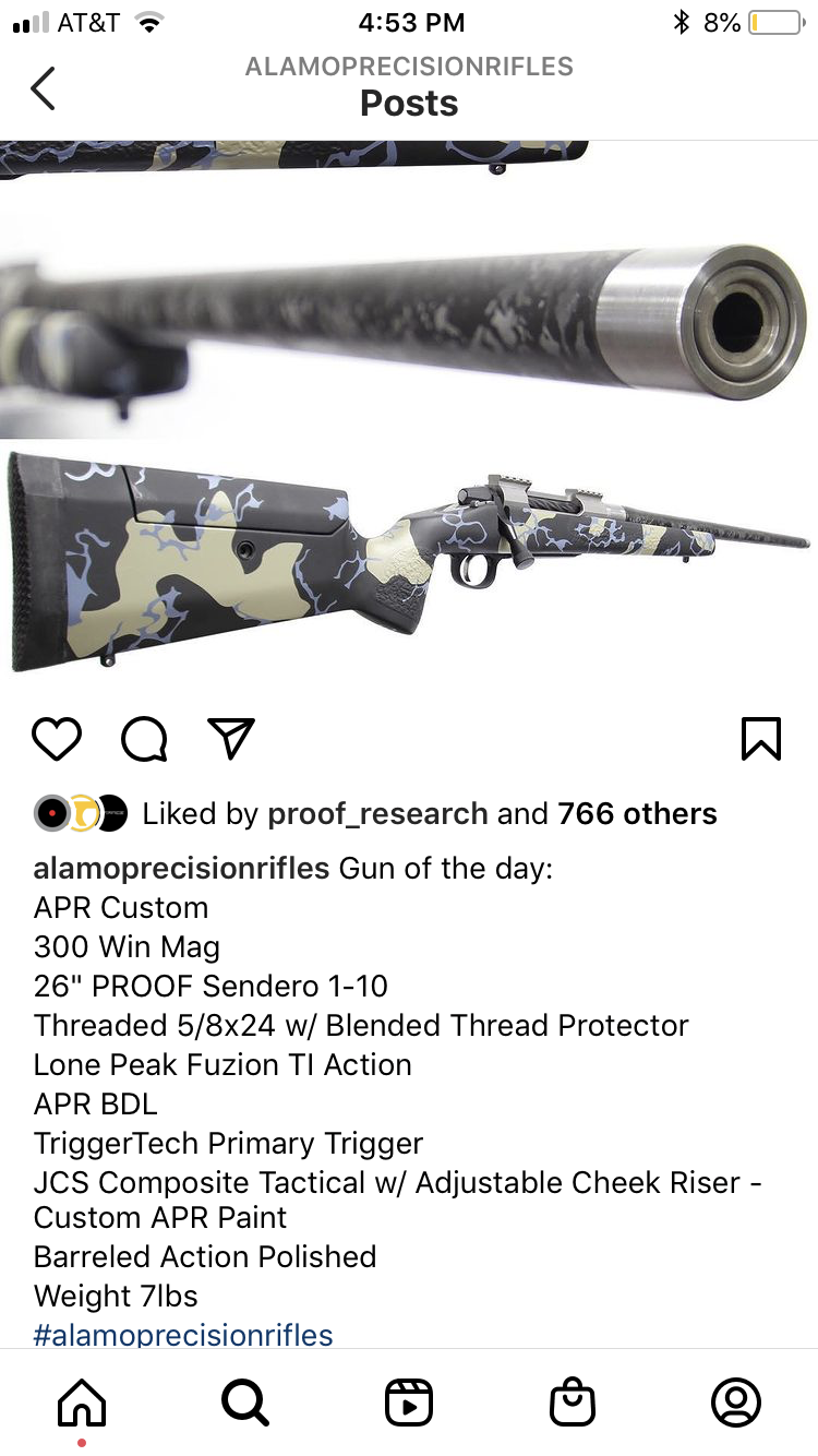

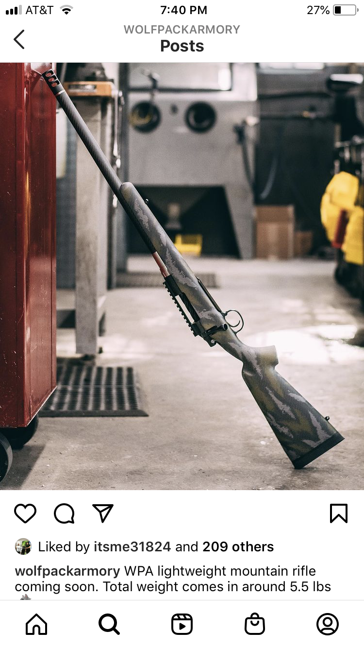

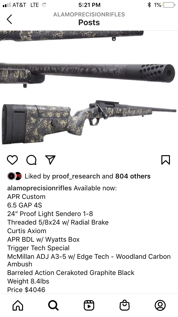

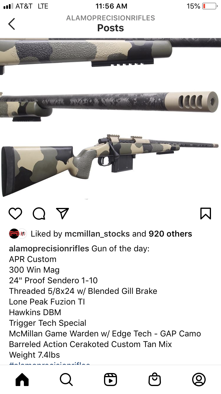

Hawk, I know 7-1/2lbs will be hard to come by but I’ve seen some similar builds from Alamo Precision that have come pretty close to that in a McMillan A3-5, just tipping the scale at a little over 8lbs. I initially figured on doing this build in an A3-5 and had calculated the rifle to come in somewhere around 10lbs. I checked out a new Browning X-Bolt target in the McM A3-5 Sportman’s Warehouse had and decided that the A3-5 wasn’t going to be a good choice for the build. I have a Kimber 84M Open country in 6.5 CM that comes factory with a 24” heavy contour barrel in an AG composites carbon stock that weighs just a little over 8lbs fully dressed. It’s all barrel but it balances/stabilizes really nice and is a pleasure to shoot from any position. After throwing out the A3-5 stock I figured I’d be better off trying to take a play out of Kimber’s playbook and keep the build in similar stature to it. I’ll be happy with a rifle that comes out in that 8-10lb range so I figured if I aim for 7.5lbs I should be able to hit that mark and if I come out under that’s great. I’m a smaller guy, only weigh about 130lbs so an 8lb rifle for me is probably like a 12lb rifle for a lot of folks lol.

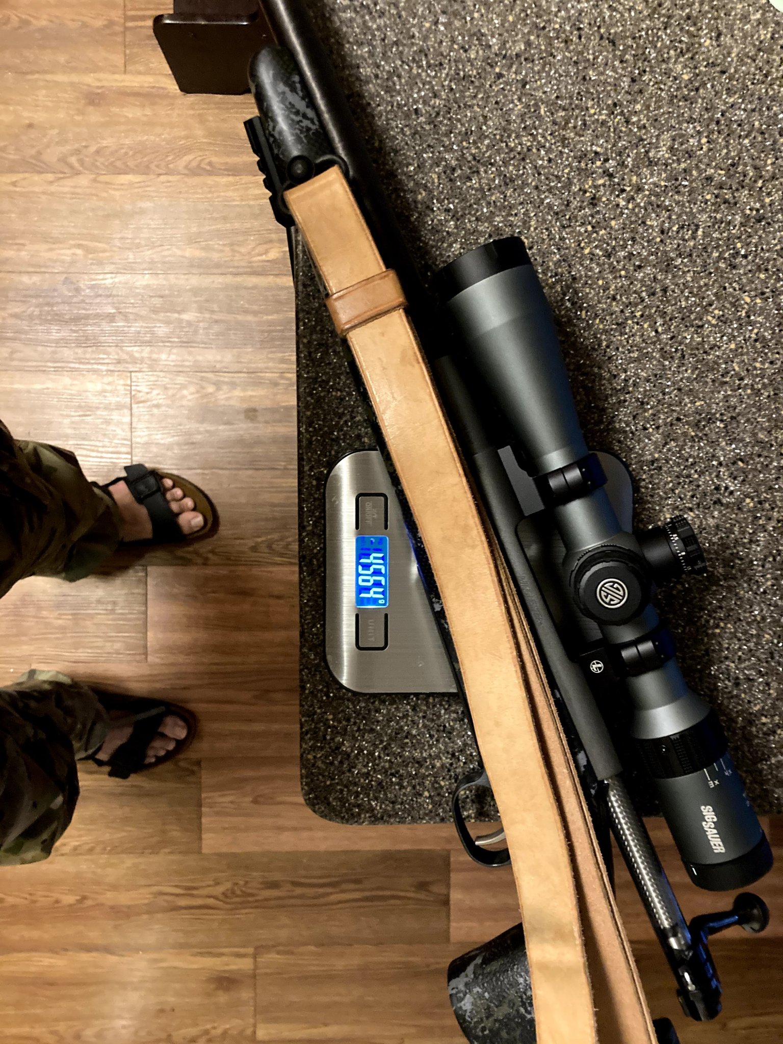

Disregard the "tactical" footwear...that's kilos not pounds. I lied...with the sling it's 10.04 instead of 9.9...
I suppose I could take off that pic rail or go with a lighter sling, or run a light/smaller optic...definitely at least another half pound to be saved here if I wanted to. I've got no qualms about the efficacy of .30-06 from a 24" bbl, though, so at least there's that.

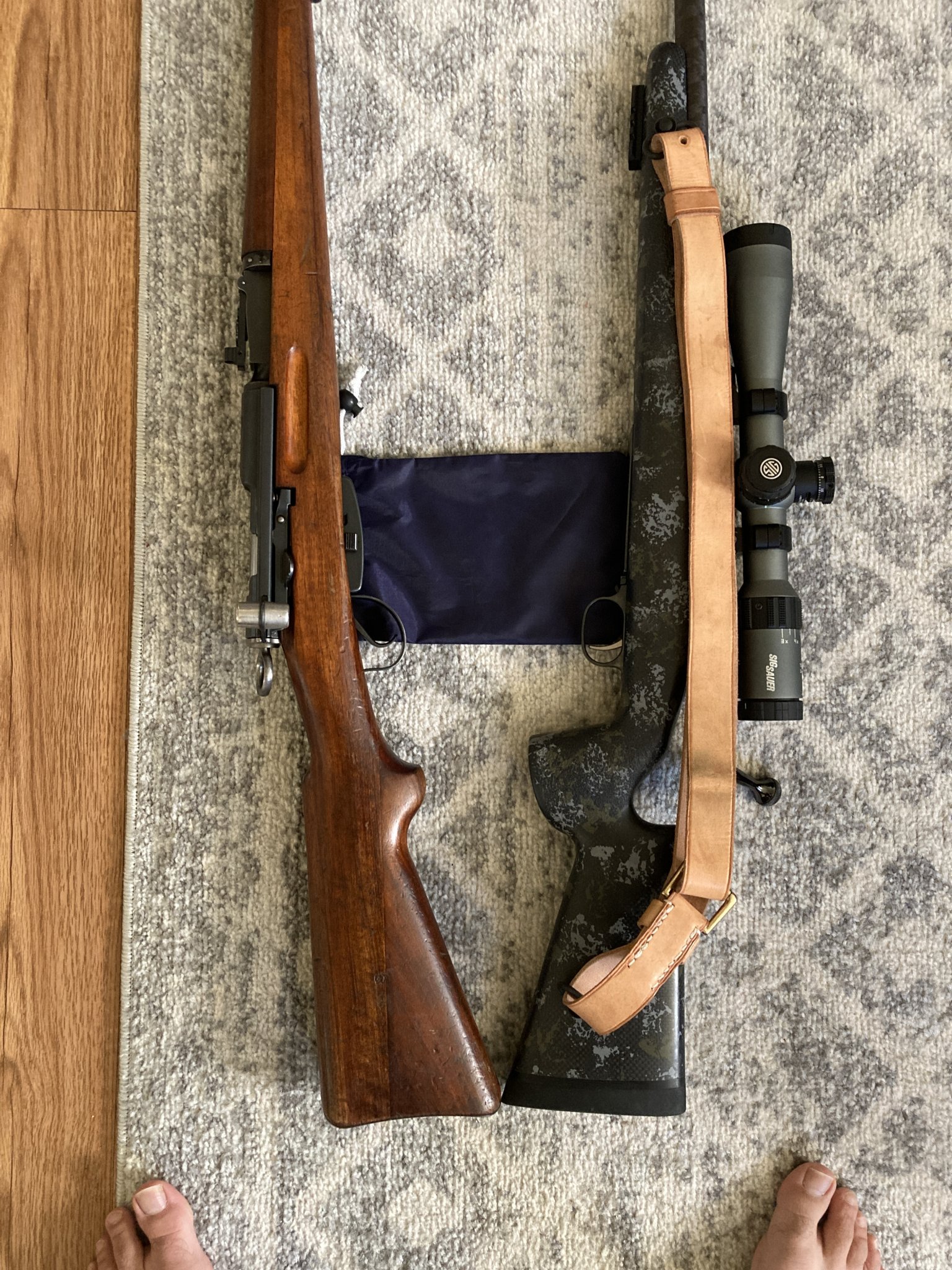

I hunt on my Dad's farm in West Virginia most years with this. 9.5lbs all in. 22" 6 Creed thou I'd like to get a 20" 6.5 Creed or 7-08 carbon barrel for it.
HS Precision R700 Sendero take-off stock
Bighorn Origin
HS Precision DBM
22" Sendero Lite in 6 Creed
Jewell trigger
Hawkins Hybrid LR rings
March F1 3x24
Thunderbeast Ultra 5
Nice setup DJ. To much dismay, I may consider going with a carbon barrel if I absolutely have to lol. What is it like shouldering that rig, does it feel heavier or lighter? That’s one thing I am a little concerned with is ending up with something that feels a lot heavier than what it actually is, obviously my goal is to be the exact opposite lol.
I think the CF moves the barrel (and rifle) center of mass back towards the shooter a little bit - so, in that sense it carries like a lighter profile barrel than it is (that's a #13...a #4 would save a few ounces too) and "swings" easier. I can take another photo with the rifle on it's balance point if I remember...just to give you an idea.
I like the stock design a lot - it feels really natural in the hand, and I think that's got a lot to do with how the rifle carries. The LOP on the stock is 12.5" because I've got T-Rex arms. Some people would call that a kid's stock, heh.
The rifle started life as a Super Grade Maple...ultimately, the weight of the rifle hasn't changed much, just a little lighter, and it carries about the same...it's just much nicer to shoot now and more accurate.
I learned over lunch that I'm not setup for gun glamour shots...balance point is right at the front action screw or thereabouts. Obviously, a longer stock or a full magazine would move it aft slightly.
