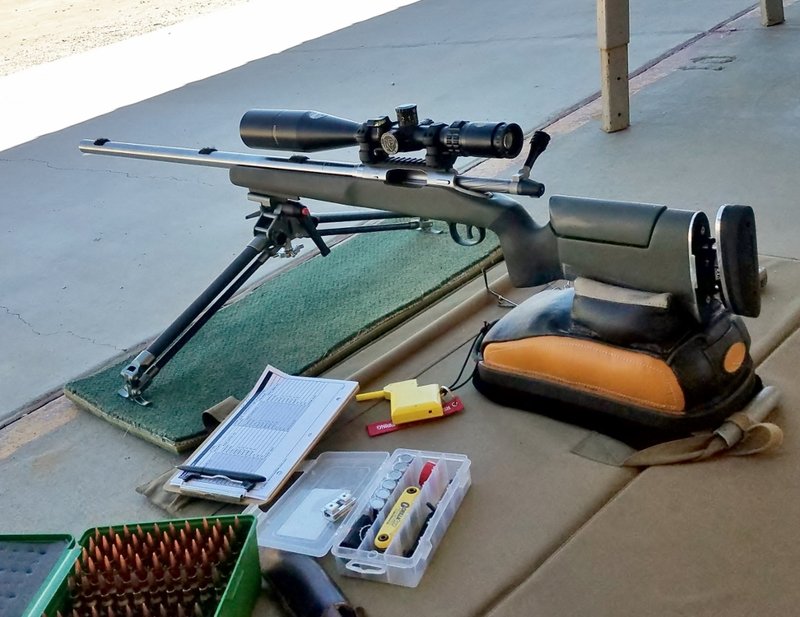

No experience with HS, this is my F T/R stock, except mine is set up for the Savage. I own a pair, each has a Savage 11VT riding in it, a .223 and a .308. The .223 was shot at the Berger SW LR Nationals F T/R MR/600yd matches last February; and I think it was very clearly capable.
My two Savages still have the factory 2-piece scope bases mounted, and no cheek height adjustment is needed with medium rings and 44mm objectives. This scope clearly resolves 22 caliber bullet holes for me at 300yd. My Bipod is a 6"-9" Harris knockoff.

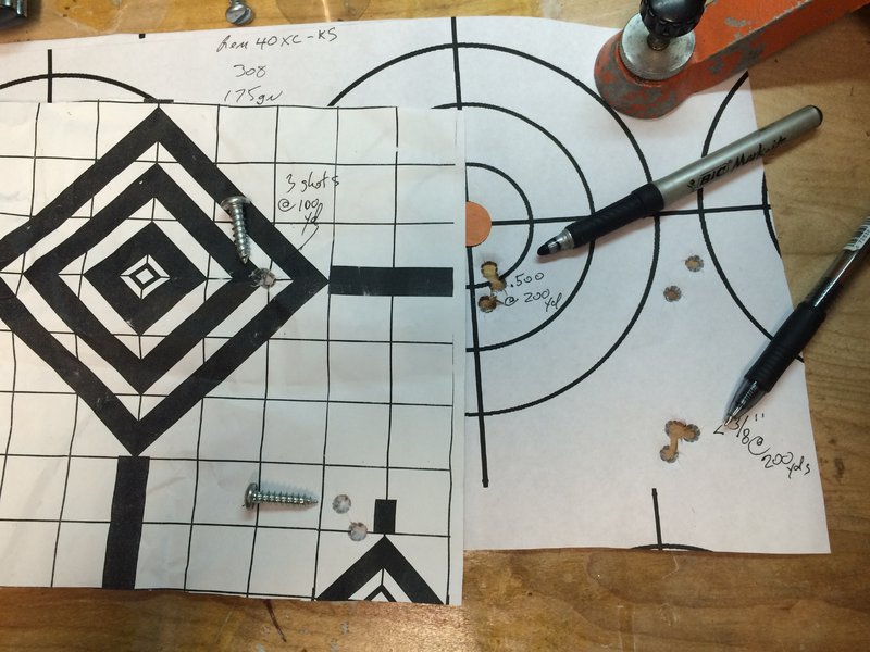

Thanks for responces. The equipment mentioned is already owned. I sold the Macmillan position kevlar stock to help finance the build and bought anoher gun with the money. OOPs. With that stock off the bench the rifle shot groups at 200 yds that impressed me with Federal Gold 175 gn ammo. I will be lhand loading for it in the future. I will be investigating the Choate stock. Especially because the 40XC has a ADL trigger guard a d the Choate has that style available.
