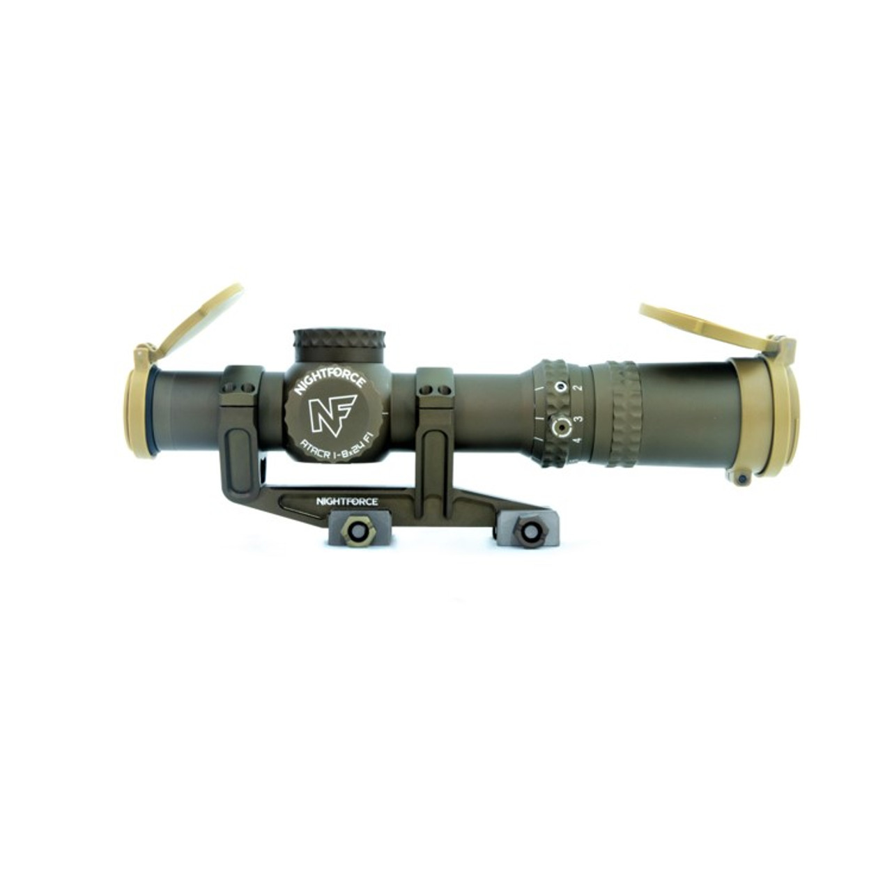

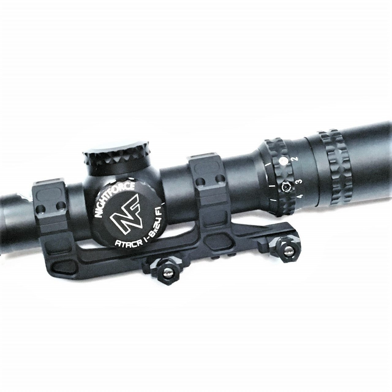

Here are pics of our ATACR scopes with mounts.
download - 2022-11-29T213044.121.png nightforce-rifle-scope-nightforce-atacr-1-8x-cqb-scope-with-geissele-mount-combo-3989726232648...jpg
You can see more here: ATACR 1-8x with mount combos
If we can help you select, send me a DM.
