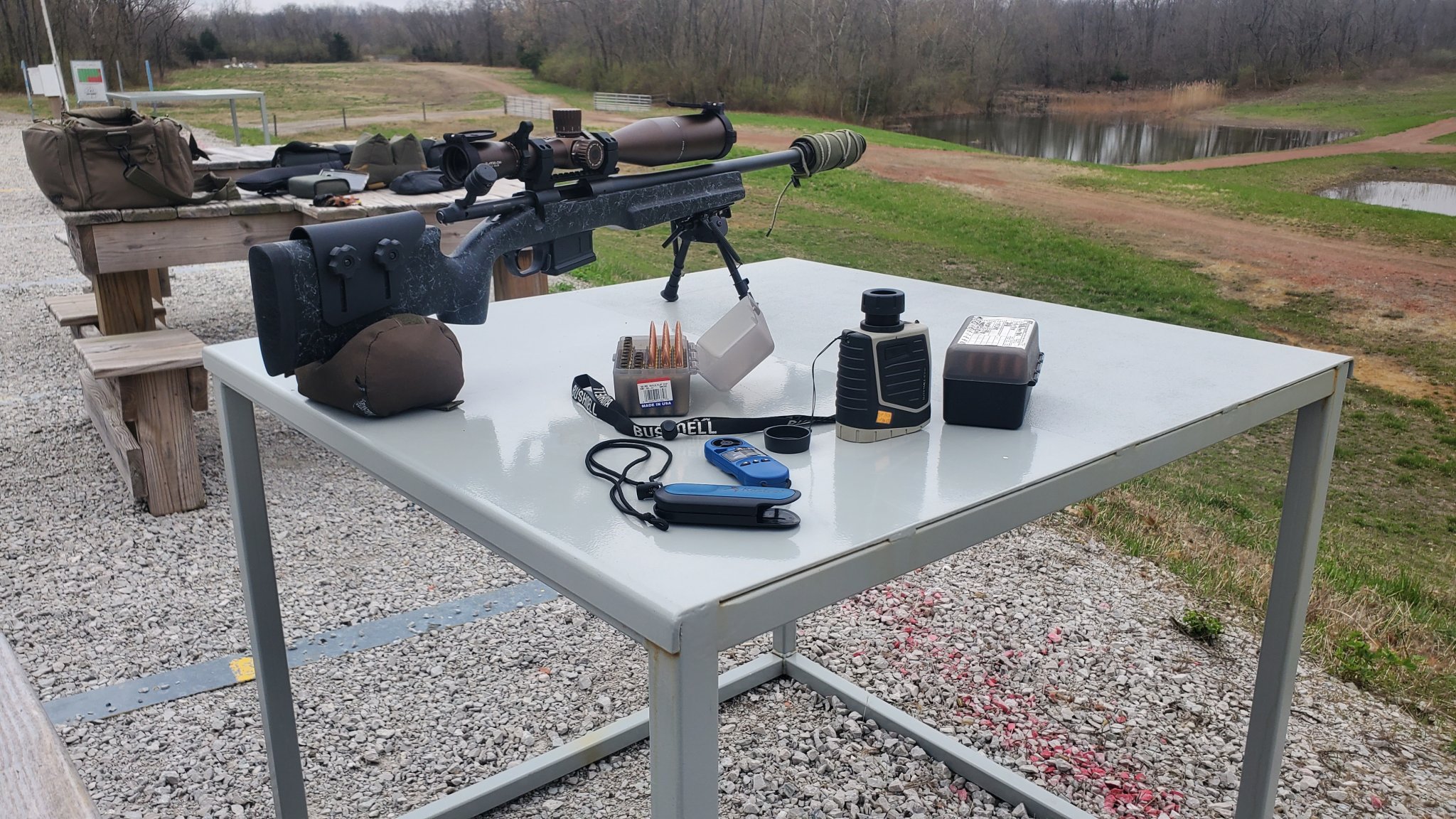

Way happy with my Athlon ETR. Makes hitting 1,000 yard targets a breeze with a 308. Paid $1,100.
