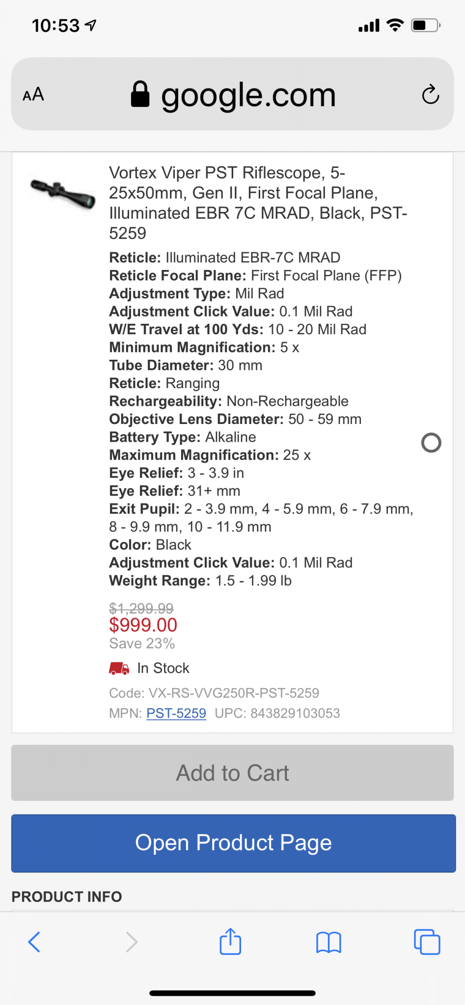

Thanks for the great article. If I understand Mil is the easiest to work with because it’s in 10’s
Also a Mil reticle is also called MRAD. so I started looking at scopes. Would this be a good choice?

That's a good optic but not at that price. At that price, you can find a second gen Sig Tango6 which is a LOW Japanese scope with some really good glass clarity...

You got it as far as the abbreviations. Don't get hung up on something being divisible by 10 or 4. It literally makes no difference. Same the stupid argument that one has to "dial less" using MRAD scopes. The erector tube has to move the same distance for a given elevation change in two identical scopes whose only difference is the labels and number of detents on the turrets. Think about it. The only reason to use an MRAD scope for long range practical rifle shooting is commonality with other shooters (ease of communication).
A scope with the focal plane at the reticle (first focal plane) is important if that scope has a reticle with subdvision lines that allow you to hold over for elevation and more importantly hold windage without touching the turrets because those subdivisions will be worth the same angular measurement (in mils or MOA, whichever units that scope comes with) regardless of magnification.

Agreed. Noobs think they need the most magnification they can for the lowest possible price. I would rather buy a scope of much higher optical and mechanical (very important) quality with a little less magnification for the same or lower price. Like this one.

Ordered this scope on your recommendation. Can’t wait to get it. Now need to find bases and rings.
