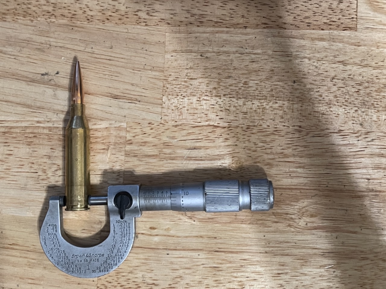

    Im talking about using 1” micrometer to measure the case just above the extractor groove before and after firing for each charge weight, comparing the values and flagging anything with an expansion greater than .0005”.

    Lol, get better tools. take a 1” micrometer to the base of the case before and after firing then compare the two measurements.
    That helps ... I have that micrometer (use it for neck-wall measurements). But I don't understand. Won't the fired case "always" be larger than the unfired measurement? And won't sizing the case in a FL sizing die bring it back to standard size? I guess I'll have to try it and find out ... eh?
    That’s the stoutest part of the case and should grow very little.
    A sizing die doesn’t have a chance of changing the dimension there.
    Ideally you take the measurement right at the forward edge of extractor grove.
    I’m not sure why you are over analyzing this as it’s a very simple concept. And no the fired measurement will not be larger until over pressure is present.
    Always thought it was simple ... heavy bolt, primer craters, ejector marks, etc. ... but if this measurement is more "predictive", then it's worth at least a try. I'm always looking for a better way.
    Yes, it’s a leading indicator vs lagging. With large bore cartridges and 90+ grains of powder going off inches from your face a little extra caution and diligence can pay off. I didn’t think you knew what I was talking about when initially asked as many don’t so wanted to make you aware of it.
    It only sorta works on a virgin case and you have to build your own relative comparison because each different brand of brass will behave differently in each different chamber etc. And get this, that measurement getting larger and wedging itself in the chamber is also what give you the heavy bolt lift symptom.
    The reason you havent read it before is because it doesnt really work and people are only using to to try and guess at a relative range of pressure. It was much more popular back in the day.
    Interesting ... makes sense that case expansion in this area, and a heavy bolt, would go hand-in-hand. Are you suggesting to skip the measurement and just stick with the early physical symptoms (like heavy bolt)?
    yes
    That’s why you measure. Once you’re at heavy bolt lift, you’re already way over.
    Measuring detects the presence of increased pressure before the case wedges itself up against the chamber causing hard extraction, etc. And it works on any case, regardless of how many firings assuming you f/l size the case before each firing.
    Yea, a little record keeping is involved and sure, every case brand is going to react a little differently. I only worry about the brass I’m working with.
    But to say it doesn’t work isn’t accurate.
