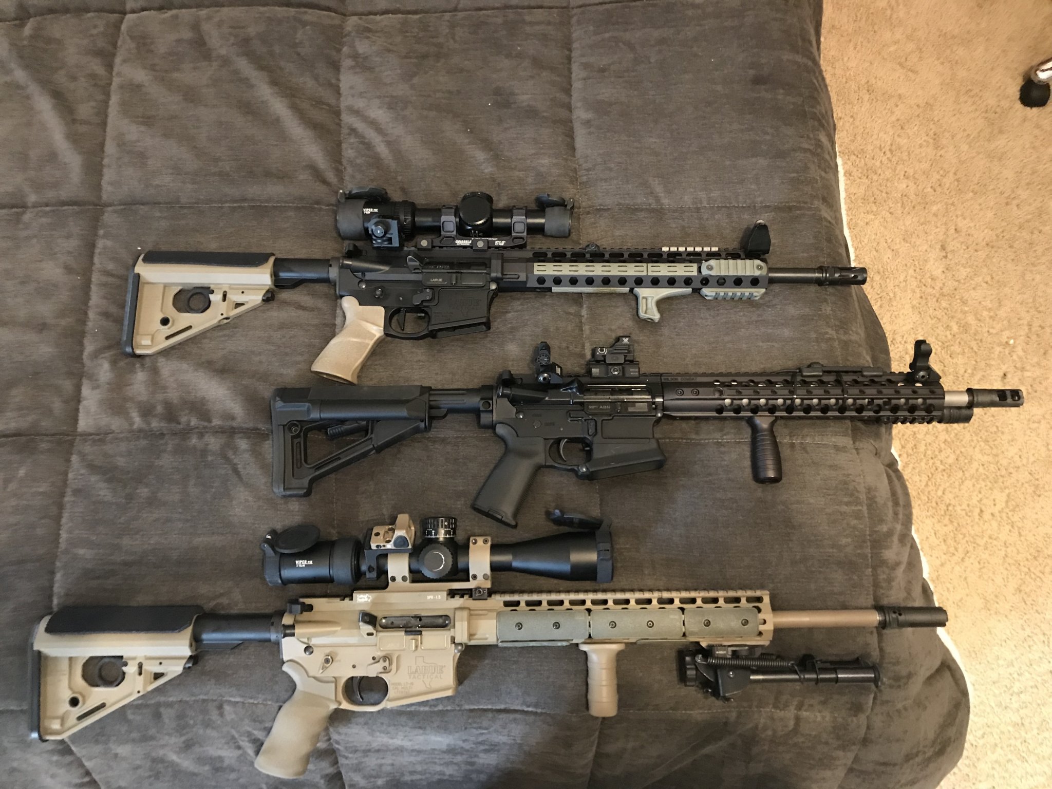

6.5 Grendel with a PST G2 3-15 and offset RMR. In all honesty the time doesn’t really get much use. It’s not comfortable to get behind but it’s there “in case”. Built the rifle as a do all SPR/Patrol Rifle
