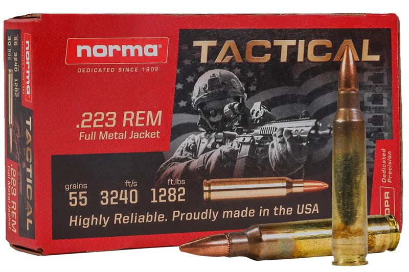

Gotta have a picture on the box with someone decked out in armour and helmet with a scary looking rifle. 🤣
This has actually proven to be a great line of ammo from norma in my rifles. If they make a 6.5 version, it might be a worthy candidate.
Reactions: XLR308
I have no doubt since its just a rebrand of M193 that has been getting it done for a long time without the tactcool graphics.
I also have had good experience with Norma ammo, the 6.5 Creedmoor load with the 130 golden target was very good in my rifle.

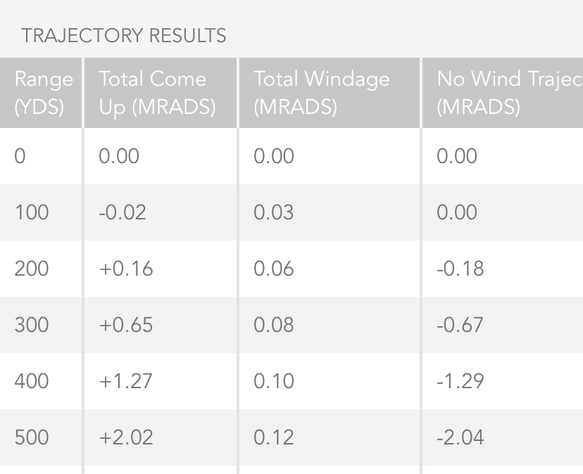

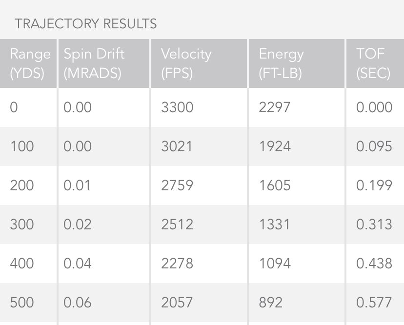

For open air no obstacle Id take a look at a 95 grain Vmax, or something similar . Muzzle velocity on a 20” will be up around 3200fps and flatter than any of the heavies 130-147 out to 500.
That round Will definitely expand on a soft skinned target and minimize over penetration. Remember Kennedy and the magic bullet that hit connley
Just a thought, no leo or mil background.

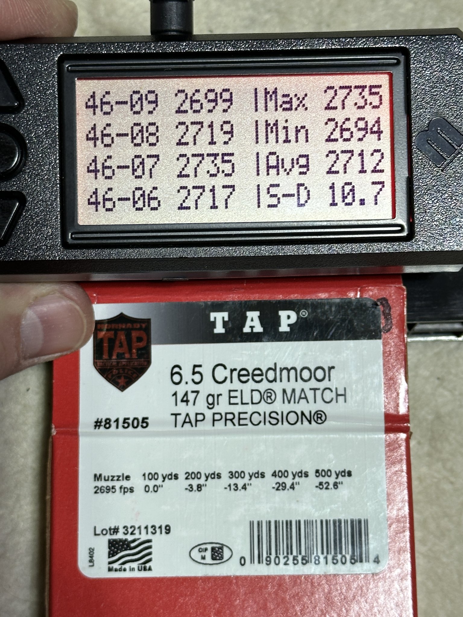

Chrono info for 147 ELDM TAP:
At 20 shots, it didn’t open up at all… still approximately 10.
Didn’t leave the chrono on for the next 200 shots….
Once I got the ballistic calculator dialed in, I was hitting targets at 1140 without any issues.
Basically a 6 or 7 for gun speed; not really bothered badly by wind…
I have found that the factory white box 147ELD – M has massive SD (30+)
Using new norma brass and H 4350, federal large rifle match primers, and 147s, I get an SD of 8 out of my LMTMWS, and 4 in my bolt gun.
TAP really isn’t that bad at all…
Wow, I shoot 140's mostly but do have a bit of chrono data on ELD-M 147 gr and over 20 shots in the data set, my ES was 41 and SD was 12.9.
