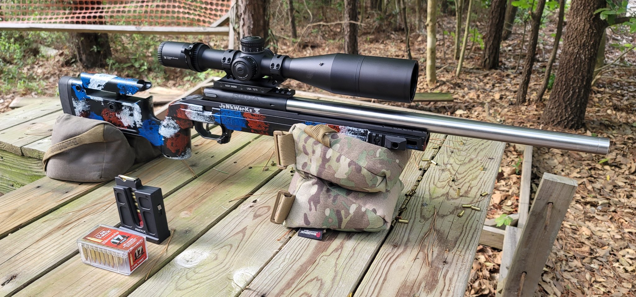

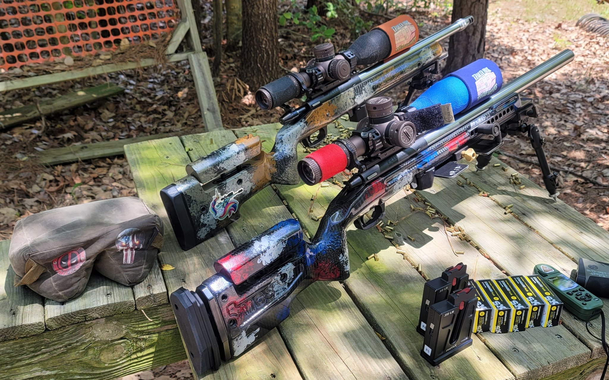

I have 2 Rim-X actions and 3 barrels.
I had them built as a 22lr and a 17hmr then I decided to go with 2- 22lr.
It is easy to change from one to the other. Change the bolt head and barrel 👍🏼
The 17hmr
The now 2 - 22lr

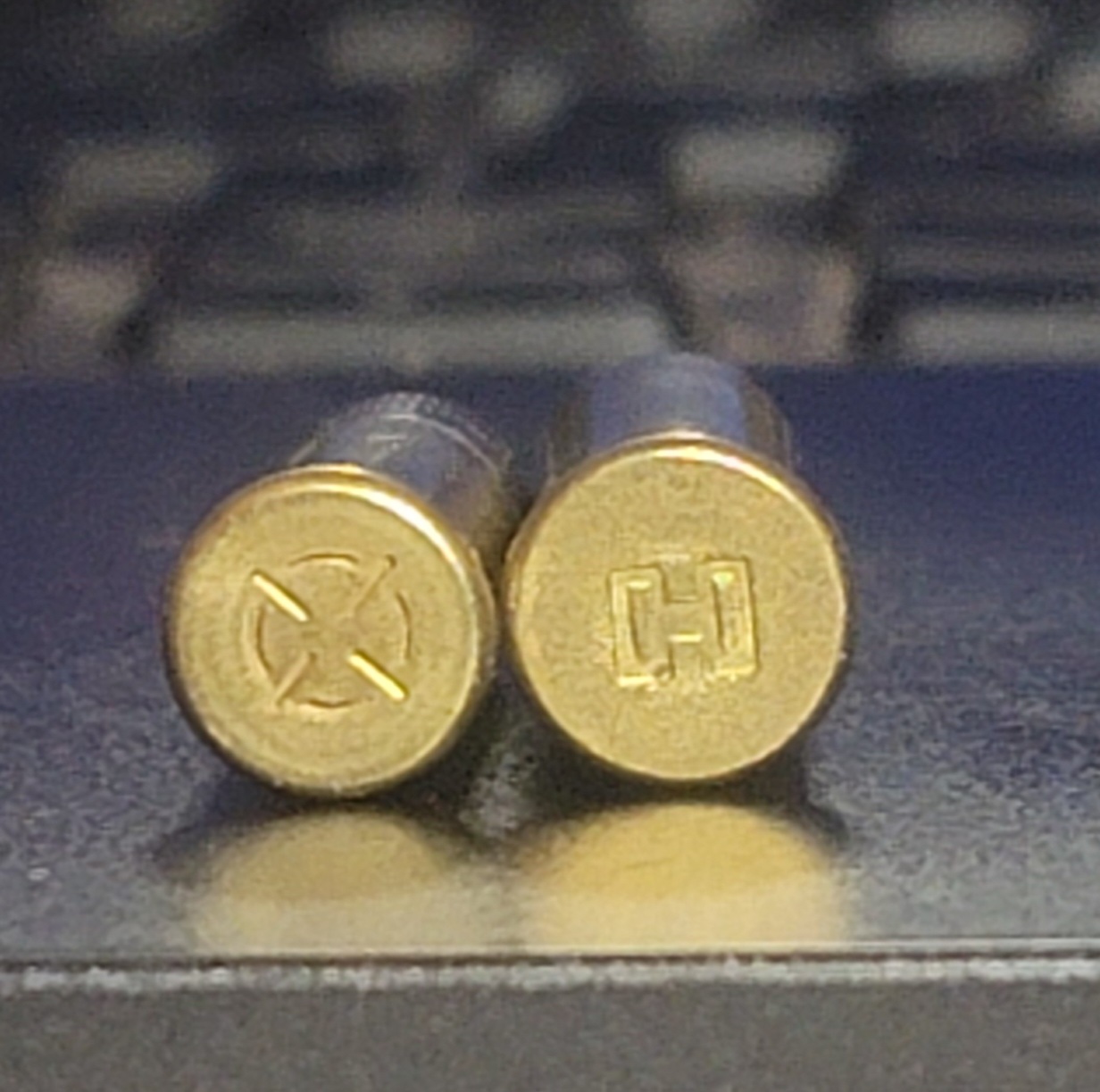

I find it odd you have to change the bolt head for 22 LR and 17HMR. I thought they would be the same. I guess there's a dimensional difference when building to tight tolerances for max accuracy potential.
Left 22lr 0.272" rim diam
Right 17hmr 0.291" rim diam
Reactions: MustangGreg66
