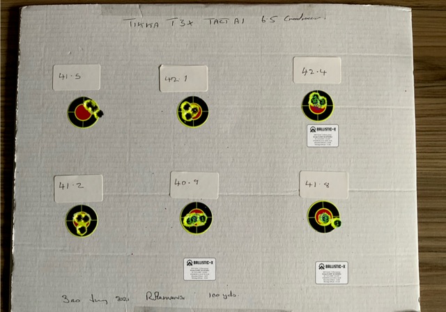

I’ve, a Tac A1 in 65, shoots very well. I had a little bit of an issue selecting a load, it was a good job that I’d marked the cases as I’d left the stickers at home
