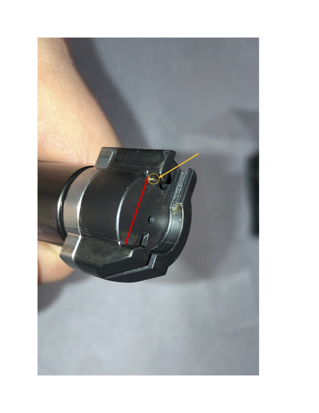

Since I don't think I'm explaining this great, here's a picture.
Red is where the case heads are getting hung up. Measurement is 0.463". Case heads are about 0.469". Yellow is pointing to where it's tearing up the rim trying to seat.

The extractor might need to be tuned a bit. Call zermatt up and have them walk you through it

The case rim diameter is .473" +.000/-.010". If that gap (red line) is .463", there's no way you'll get a cartridge to feed properly. Send that bolt head back.
Screwing around with magazine feedlips, throwing once fired brass away, whatever, none of that will fix this.
The extractor isn’t even in the bolt. He said that, and the picture confirms it.

A quick measurement on my Origin bolt head shows ~.485" at the same red line point. Call Zermatt, they are great to work with.

Send me your information so I can get you a return label. I'd like to measure that bolt head for myself. We'll be happy to get a replacement on its way to you today as well.

Just wanted to update and close this out. New bolt head showed up today and works great. For those keeping track at home:
Tuesday: New action picked up found problem. Posted question here around 10pm.
Wednesday: @Zermatt Arms responds by 7:15 am before I can even get a PM sent. Part mailed out by noon.
Thursday: New Bolt head delivered.
Awesome company for anyone still on the fence about picking up an action.
*Edit - after looking at them side by side the new one is definitly thinner on the outside, I'm thinking the original was a 224 Valk bolt face, and it's really going to hurt sending it back...

This is highly likely what happened. If you want to keep it, let me know and we can get an invoice sent!
