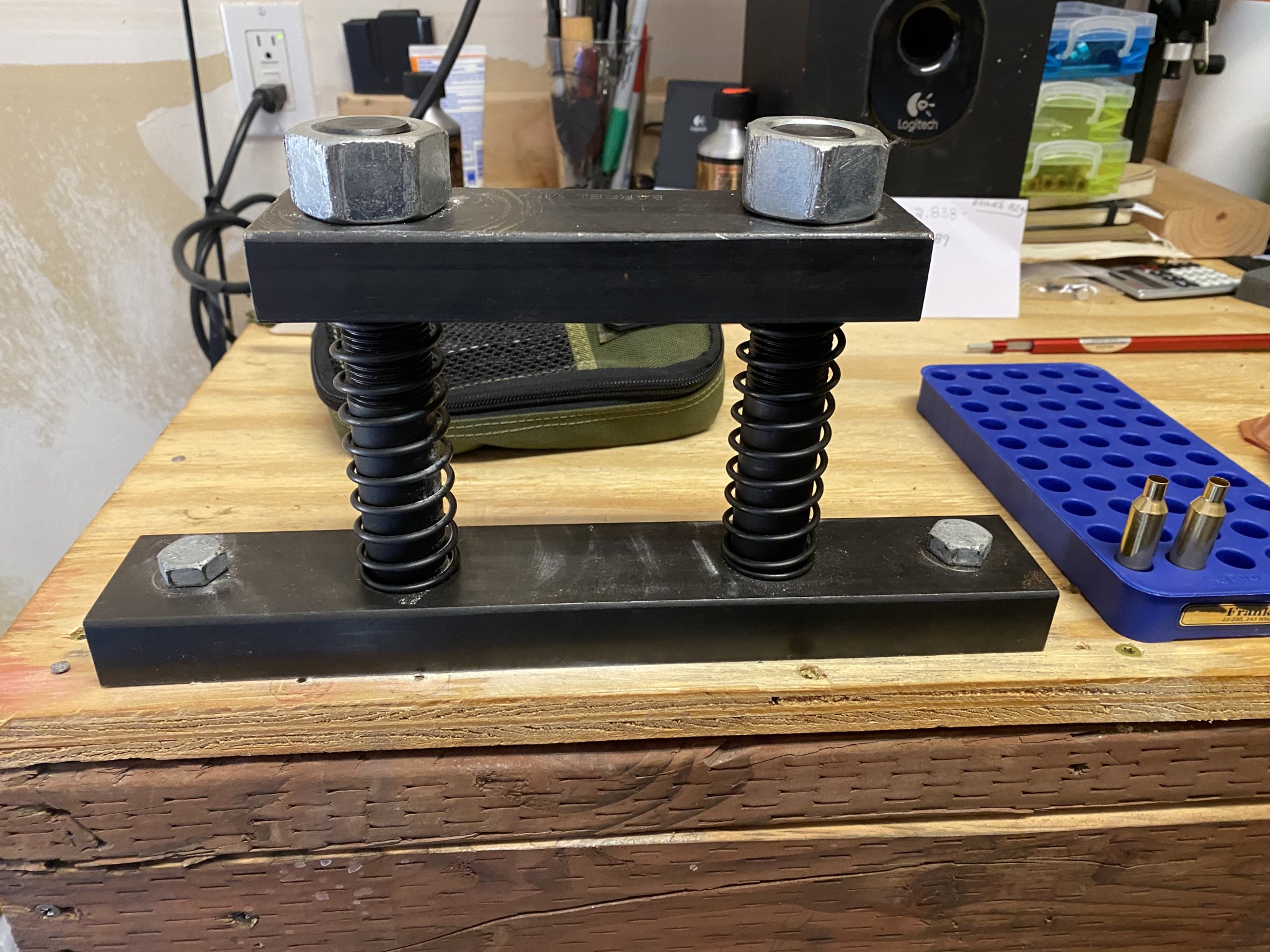

May I ask what barrel vice you use?
Reactions: SilentVapor631
Sure.
I use the Wheeler one with the oak blocks. I’ve never had an issue. I do recommend using pine resin to hold the barrel between the oak blocks.
Can we a picture pretty please?
I can dig out the oak blocks if needed

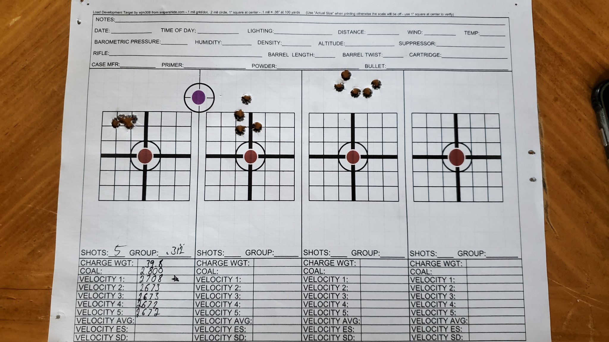

well, I made a video but thought id give you a picture so you wouldnt have to wait for editing.
the test was: shoot, change barrels back and forth then shoot. it did shift about .75"+ up.
i changed barrels because in the real world you wouldnt be just unscrewing and reinstalling a barrel (unless thats how you like to clean). Ive always done my barrels at 75ft lbs.
there are three groups in the picture. from left to right
1: this group was from a previous days load development. i forgot to calibrate my scale and threw a light load just to feel things out with this new barrel. of course it shot great....
group 2 & 3 are the test. couldnt recreate the load as i had hoped 😆
so, anybody got a TL3 theyd like to test?
edit: this test only means anything if its a substantial issue to you. you may not care one bit about keeping your zero and shooting 3 more rounds to get it back. so TL3 vs origin is still up to the end user.

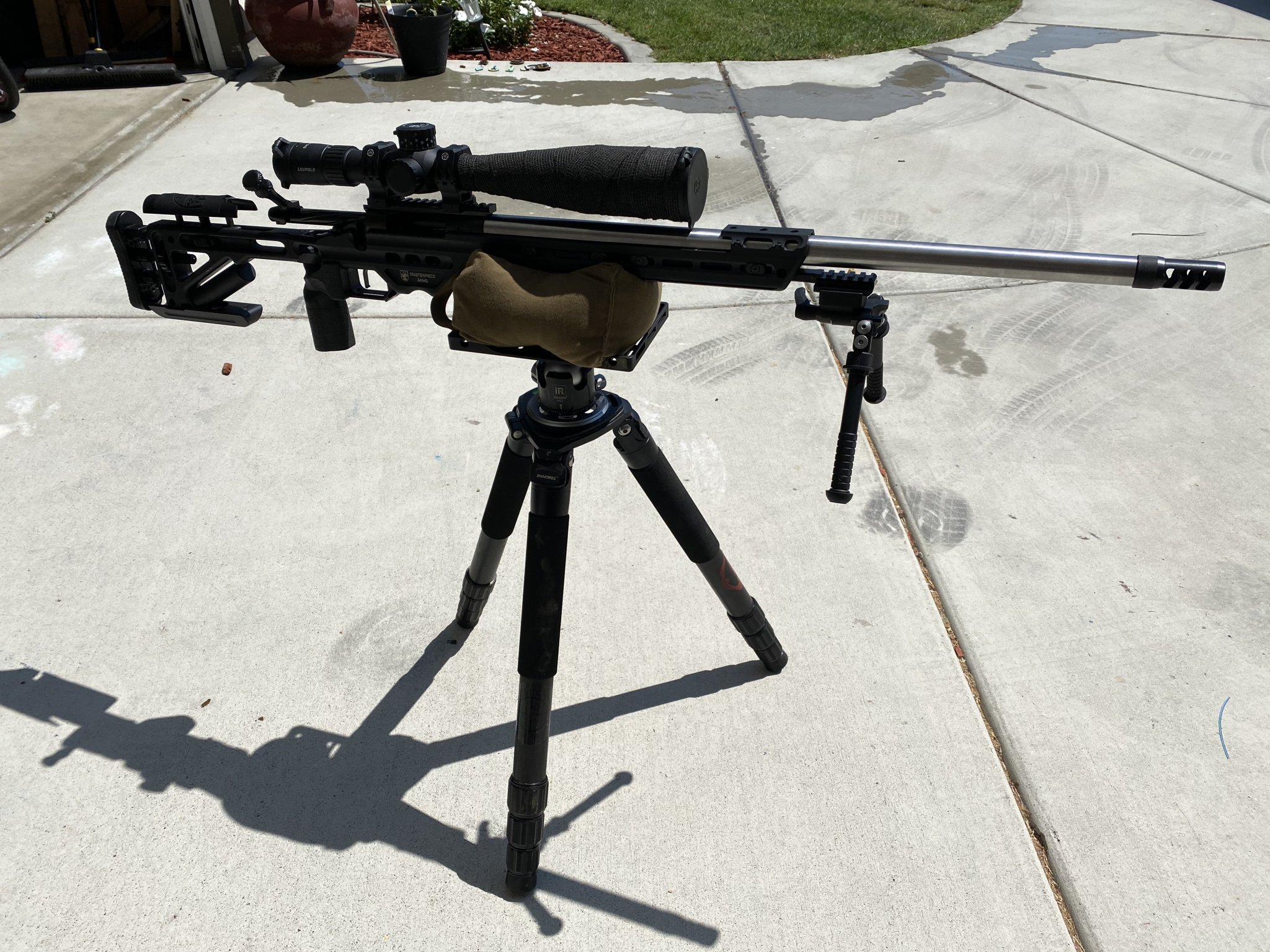

just finished up. Im open to criticism and more ideas.
Somehow I lost track of this thread, appreciate the test and the video. Your experience mirrors mine, point of impact shift but not a huge shift, I've been seeing like 1MOA or less. I actually watched your video on youtube at one point and thought huh, I wonder if that's the same guy that I was talking to on SH, haha.
