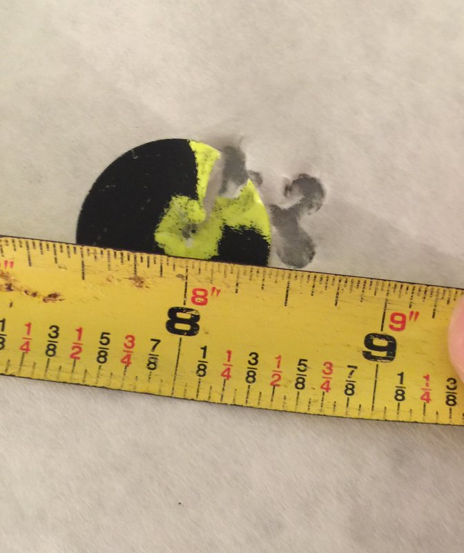

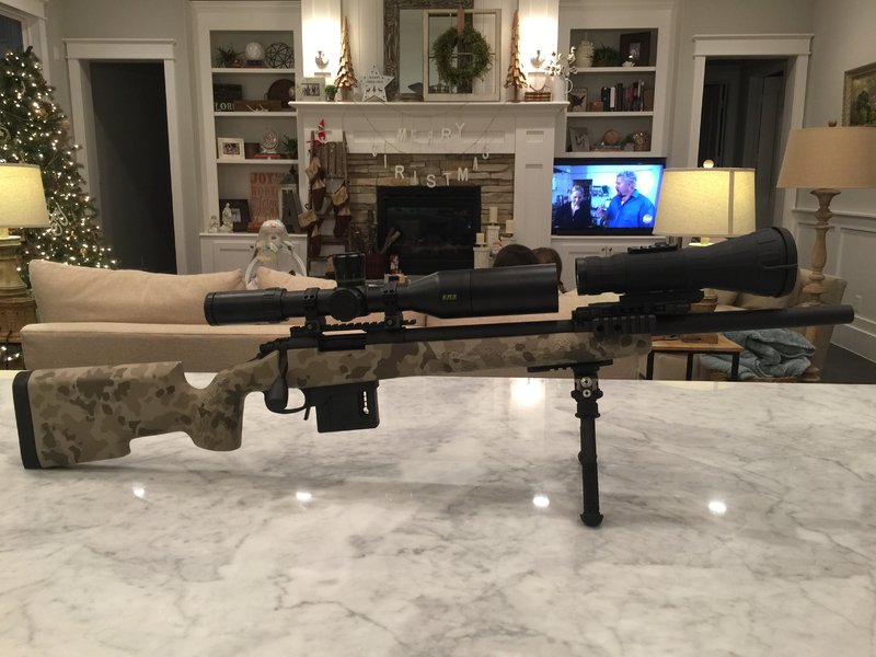

    I suppose I'll help kick this thread off with a few pictures of the 40x Mike built for me.
    Groups were shot from 100 yards.

    These rifles start life as a Remington 40X Single Shot; they're converted to a repeater and use a magazine that is designed around the AICS form factor. The sky is the limit when it comes to how you set the rifle up.

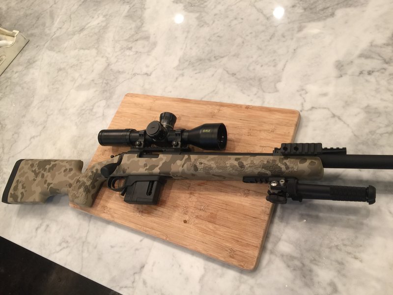

    [IMG2=JSON]{"data-align":"none","data-size":"full","src":"http:\/\/i1364.photobucket.com\/albums\/r740\/Karlslovenski\/Mobile%20Uploads\/2017-03\/C2DE7DC5-D834-4EA0-953B-7DB1EA75E400_zpskjz0vixa.jpg"}[/IMG2]
    I was lucky enough to find this here on the Hide. I'm amazed with the fit and the work Mike has done with this rifle. So far me and my 10 year old son have over 200 rounds with a out a problem. The accuracy we are getting is very good. I have some better ammo on order. Then we will shoot some groups and see what we can do.
    Very nice NA, glad you were able to grab that one, it was one of my favorite builds. Let me know if you have any questions or need anything....

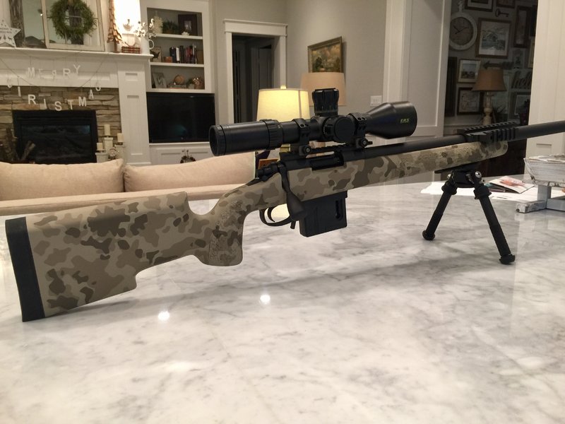

    This would make an excellent gift for myself and be a blast to work on over next winter.
    I really love that one in the MCS T stock.
    There are two in the MCS T (my favorite stock), with quite a few more things in the works....
