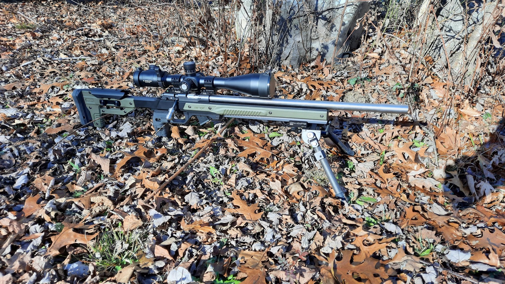

You can run your T1x mags. I've got one for my T1x. Pretty great value. I really enjoy it. You'll need a rail (arca or pic) to mount a bipod tho.

BTW, just a note on the Oryx. I liked the design of it allot, Simple, adjustable and functional .The plastic gave it some warmth to the skin that I found lacking on other chassis.. That said, you should know that it isn't as adjustable for weight and center of balance adjustments as some others. You'll also want their ARCA rail as it is designed to fit the contour of that chassis.

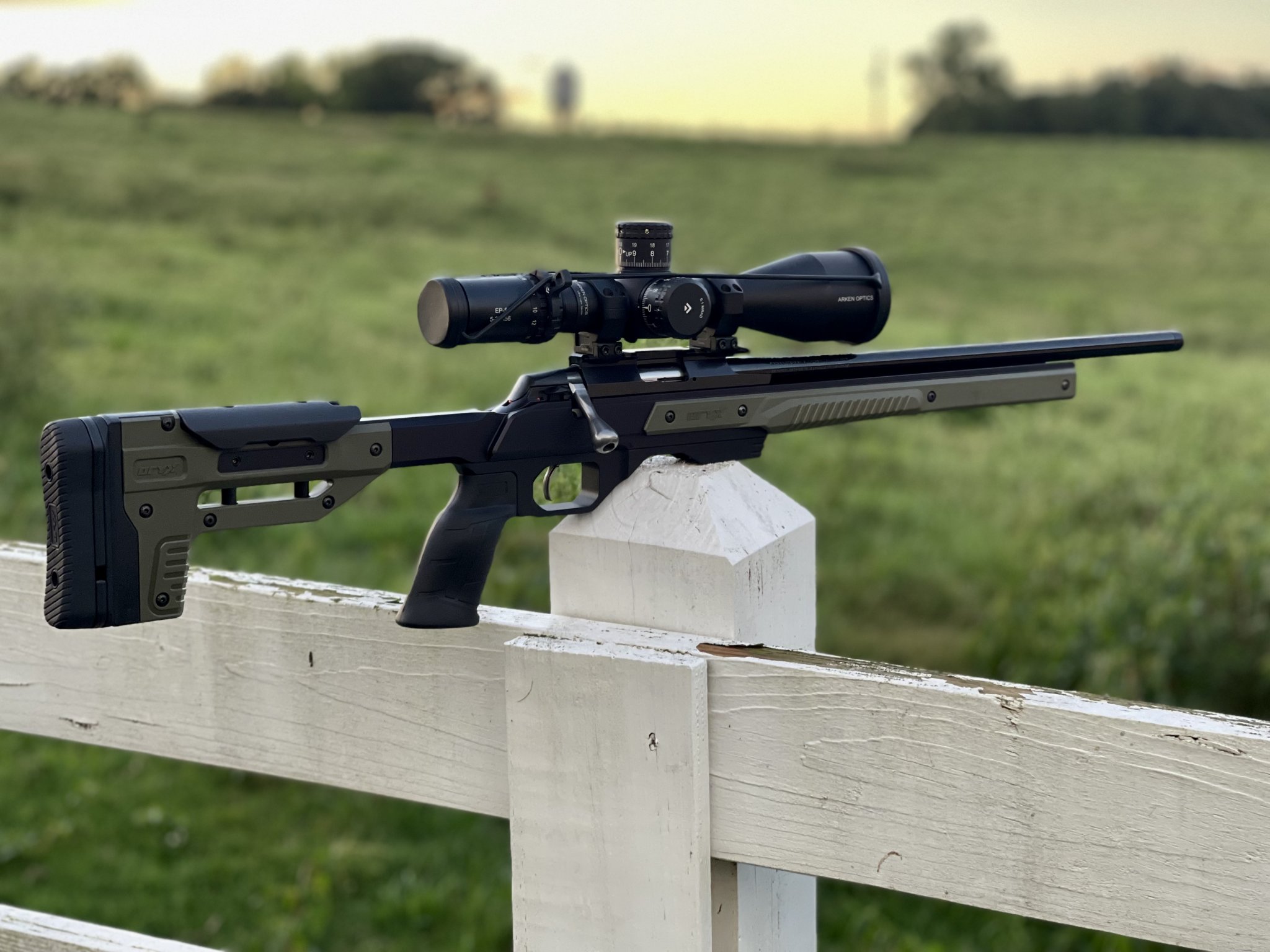

I just put my Savage in an Oryx. I added the MDT elite vertical grip. It adds a better thumb shelf. Also added an NSX 5.5-22x50 moar t. It's heavy at 14.5lbs, but I saved some weight with the Ti pro3 😆 Only one thing that I'm irritated by so far. The back of the butt stock is too tall to get a cleaning rod straight down the barrel. I'm going to see about doing a little machine work on something to get it to fit.

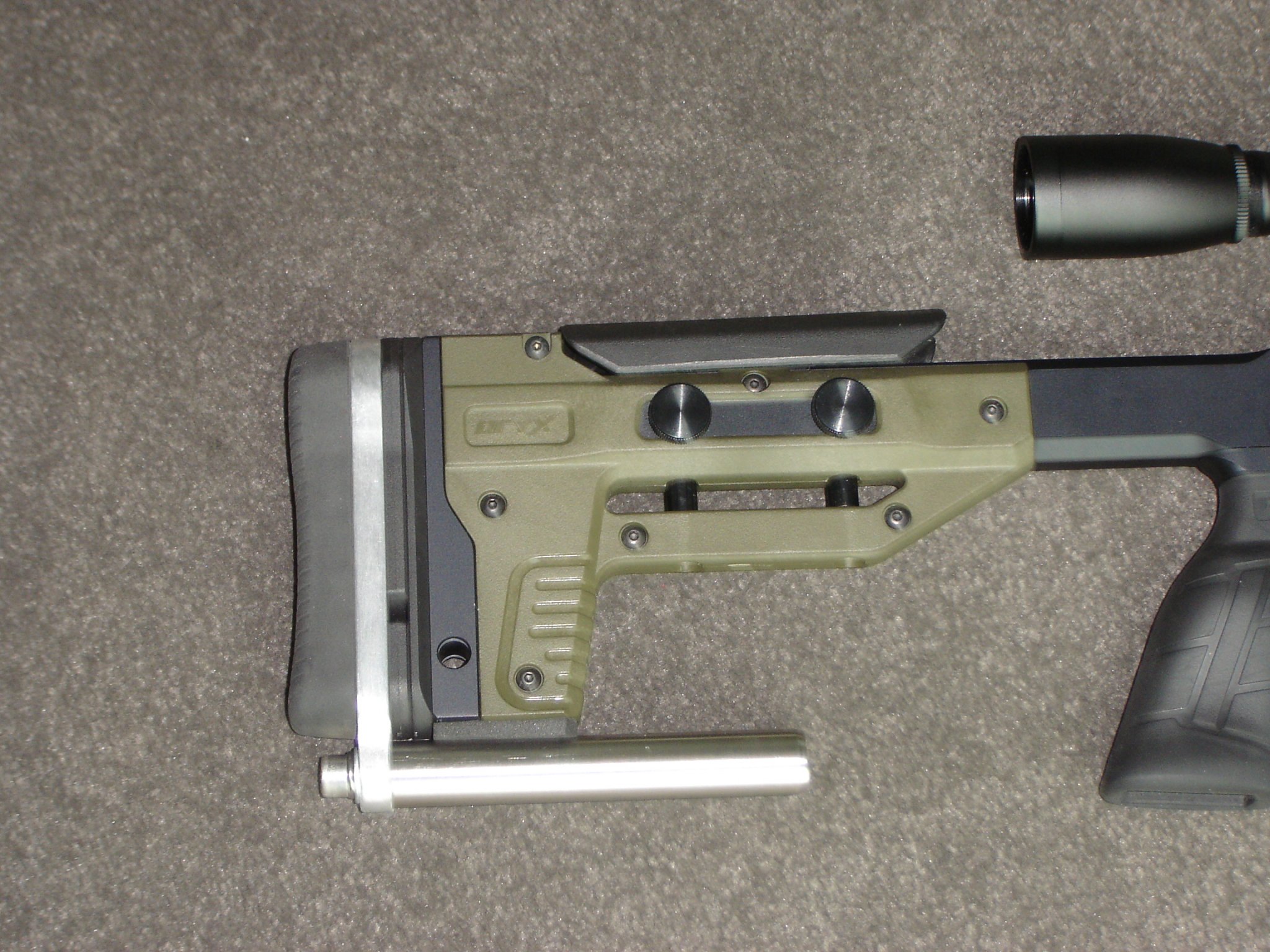

Have y'all done any LOP reduction? Without any spacers the LOP is still too long for me. Throught about putting the band saw to it and graft a kickeeze.
Oryx chassis and CZ457 Varmint 24".
I made the slider from 20mm stainless steel, and the attachment piece (spacer) is 9mm alloy.
It's a nice LOP for me with no extra spacers needed (other than the one supplied with the chassis).
I only use this rifle for indoor rimfire benchrest at 25 yards.
You can, of course, make your own spacers.
I made spacers from 20mm American Oak when I was working out what LOP suited me best. Made up the first 'slider' from wood as well, until I figured out what I needed. Then made the metal version (as per the pic).
Finally found that the extra 9mm was all I needed.
So don't overlook that you can, with minimum tools needed, make spacers from wood (doesn't 'need' to be plastic). Paint the wood black if wood grain worries you.
