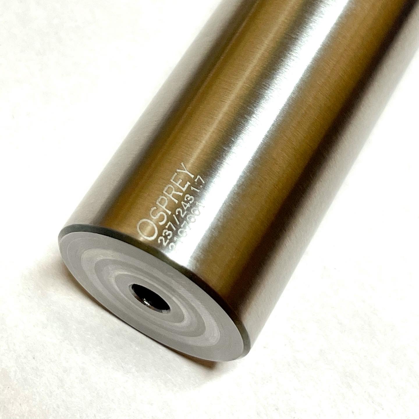

Osprey Barrel Works is a new offering through Patriot Valley Arms. They barrels are 100% CNC produced from double stress relieved 416RR CReS (Stainless). Right now they're available in 22, 6mm, 6.5mm in the associated fast twists required for modern rifle bullets. As production increases there will be more calibers added to the list, likely in early 2022.
The project is a long term endeavor to bring more barrel production in house and vertically integrate more of the product line.
I've been pretty quiet on the forum about them for a while, even though we've been selling them for about 6 weeks. Approximately 70 are in shooters' hands at this point. We have gotten 1 big PRS match win, two local match wins, and numerous comments from those initial shooters and gunsmiths telling us how impressed they were with the first time out at the range.
Recently (last weekend) Aaron Hipp used PVA Seneca 6mm 95gr bullets and an Osprey Barrel Blank (installed by Alamo Precision) to win the PA-OH Border Wars Finale.
The barrels are top shelf, micro-honed, lapped, stainless barrels. The current production rate is ~200pcs a month and can expand as needed. They are available as contoured blanks as well as a full Prefit barrel. Each barrel blank is individually serialized for QA Tracking.

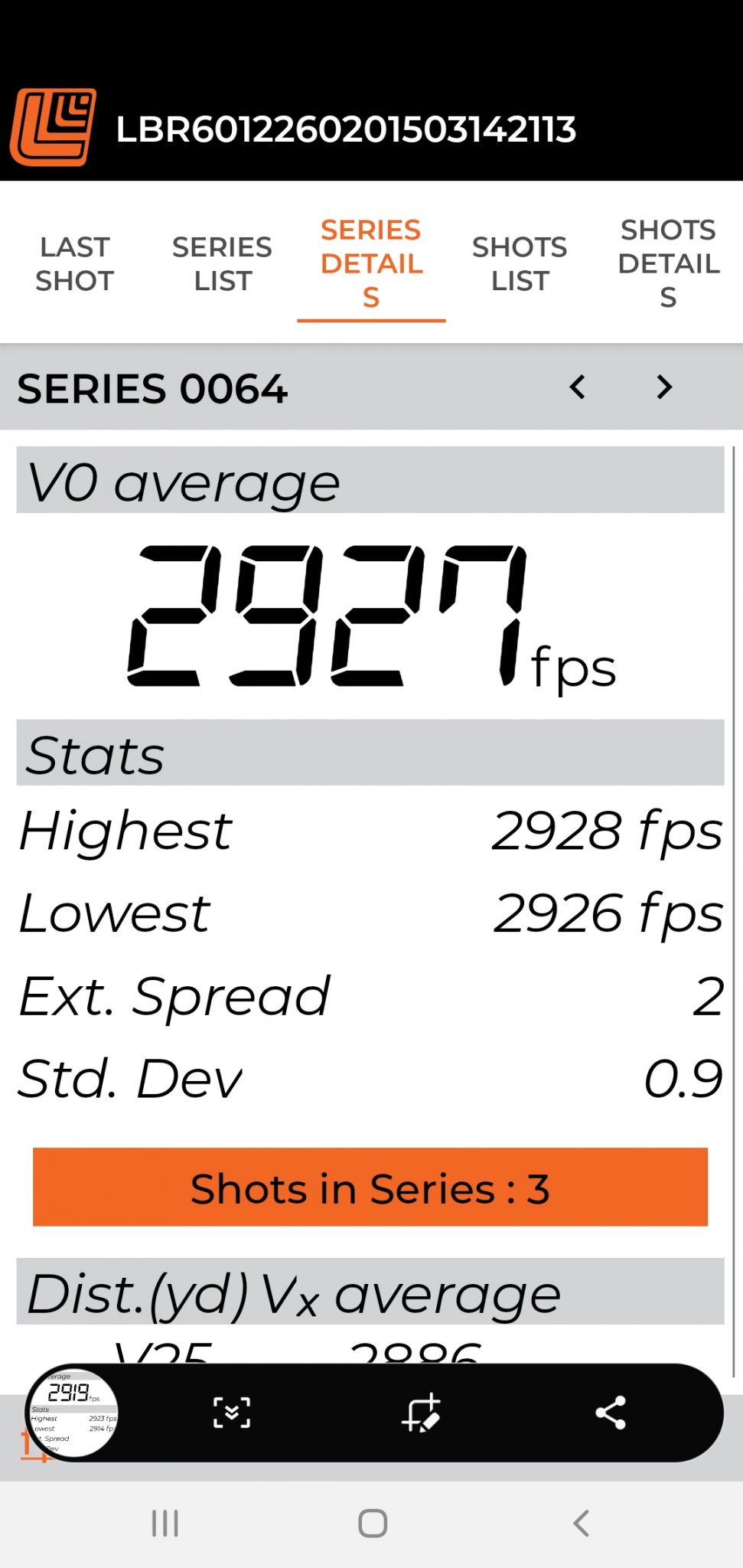

Picked up a 6gt osprey from PVA a couple weeks back for my AI.
Picked a low weight powder charge that would get me somewhat close to the velocity I wanted to run and started checking seating depth as this is my first 6mm and first time running this bullet(112 match burners). Found the seating depth that seemed to work and had less than 50 rounds through the barrel when my buddies talked me into shoot my next match with it. So I loaded 200 rounds on virgin brass and headed to the match(Guardian at Altus).
On Friday I ran 12 rounds through the barrel just to see if my estimated dope would work out for the match. Found a steel just under 1100yards on the new side of the range. Fired three rounds at that target and had a group that looked like a single impact from that distance on glass. Wish I could of went down range and measured it.
As for the match on Saturday. I managed to pull a 9th place finish. I only dropped 14 shots the entire match and every single one those was because of the trigger puller. As long as I did my job that barrel hammered. I definitely would have no concern ordering another osprey.
