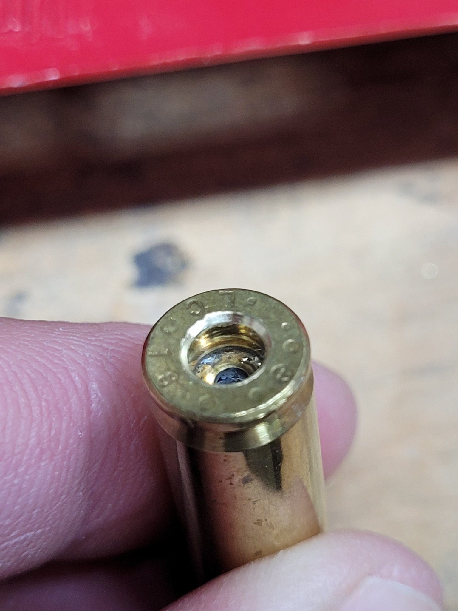

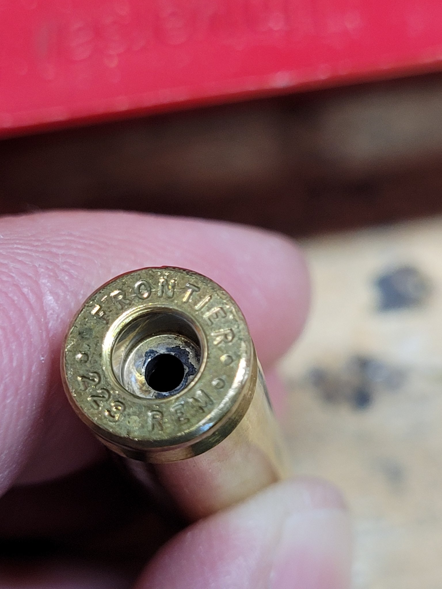

Piece that fits go gauge.
Piece that does not fit go gauge.

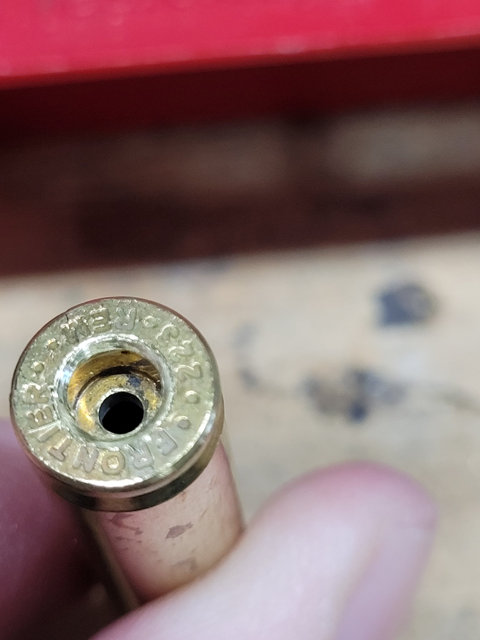

Two countersunk drilled pieces.
You shouldn't have to remove that much material.
A few twists with chamfering tool for case mouths may/should work.
However, I strongly recommend the Dillon super swage. It makes short work of a PILE-O-Brass
Well looks like I did have to remove that much and more material to get past the crimp. It did work though so I guess it's a crimp issue and had to remove lots of material.
Ended up using me Lee chamfering tools to remove it.
Occasionally you’ll get a lot of displacement from the primer crimp requiring a heavy chamfer if your trying to cut the displaced material out.
The heaviest cut shown will probably hold a primer just fine.
That’s why I switched to swaging tool for dealing with crimps.
It just shmushes the material back instead of cutting it out.
RCBS makes a crimp remover (RCBS 90386) I chuck it up in a cordless drill and remove primer crimps while watching tv, I like it better than using the Dillon swager. Put an old towel in your lap to catch the shavings.
I used what was available and free, so one Lee chamfer/deburr bit from the kit mounted onto a Dremel bit to hold it and put on the drill. The other was the lee quick trim with chamfer deburr bit, using just the chamfer portion, on a driver. Worked well enough that I got over 100 cases done.
